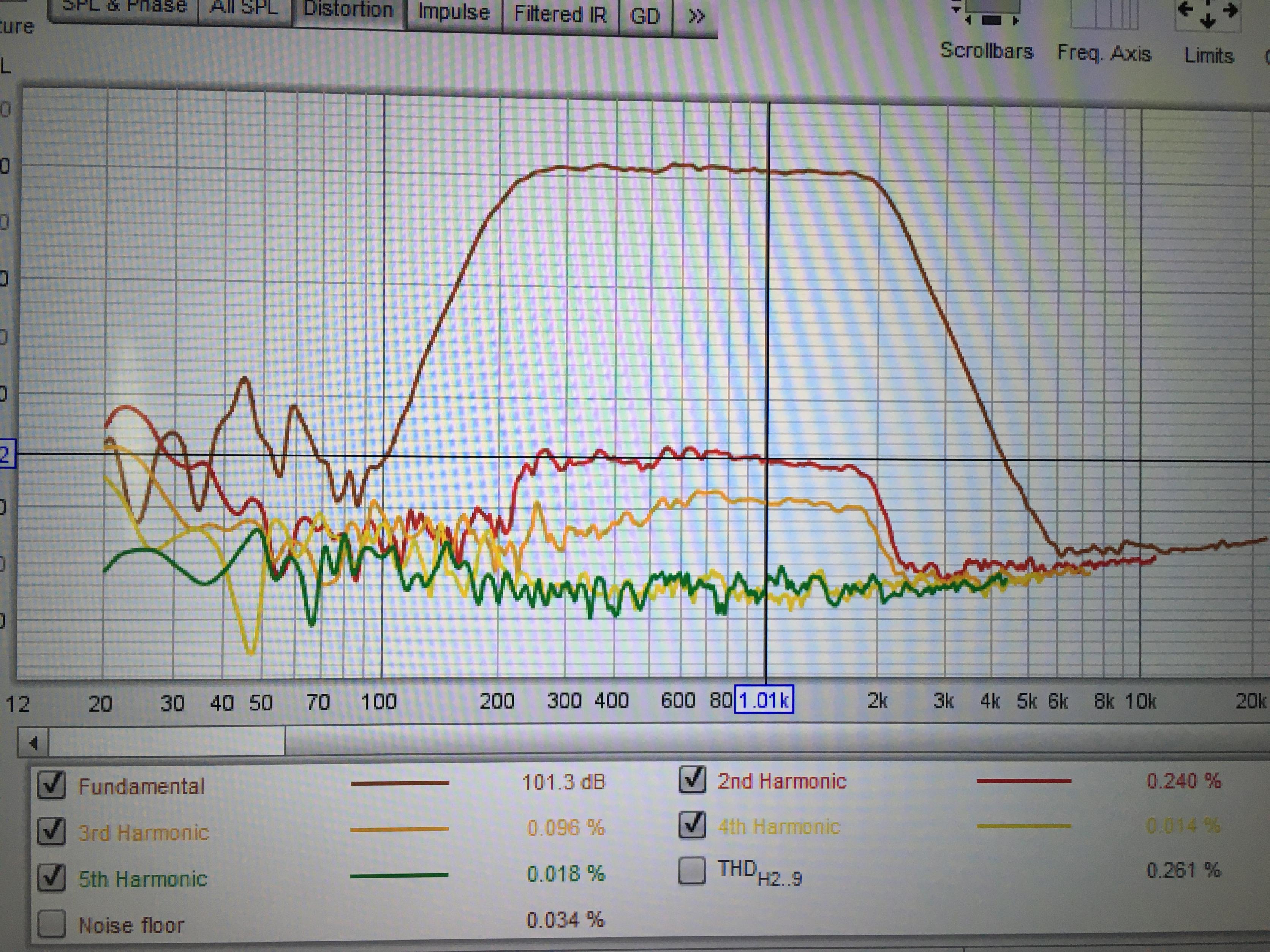

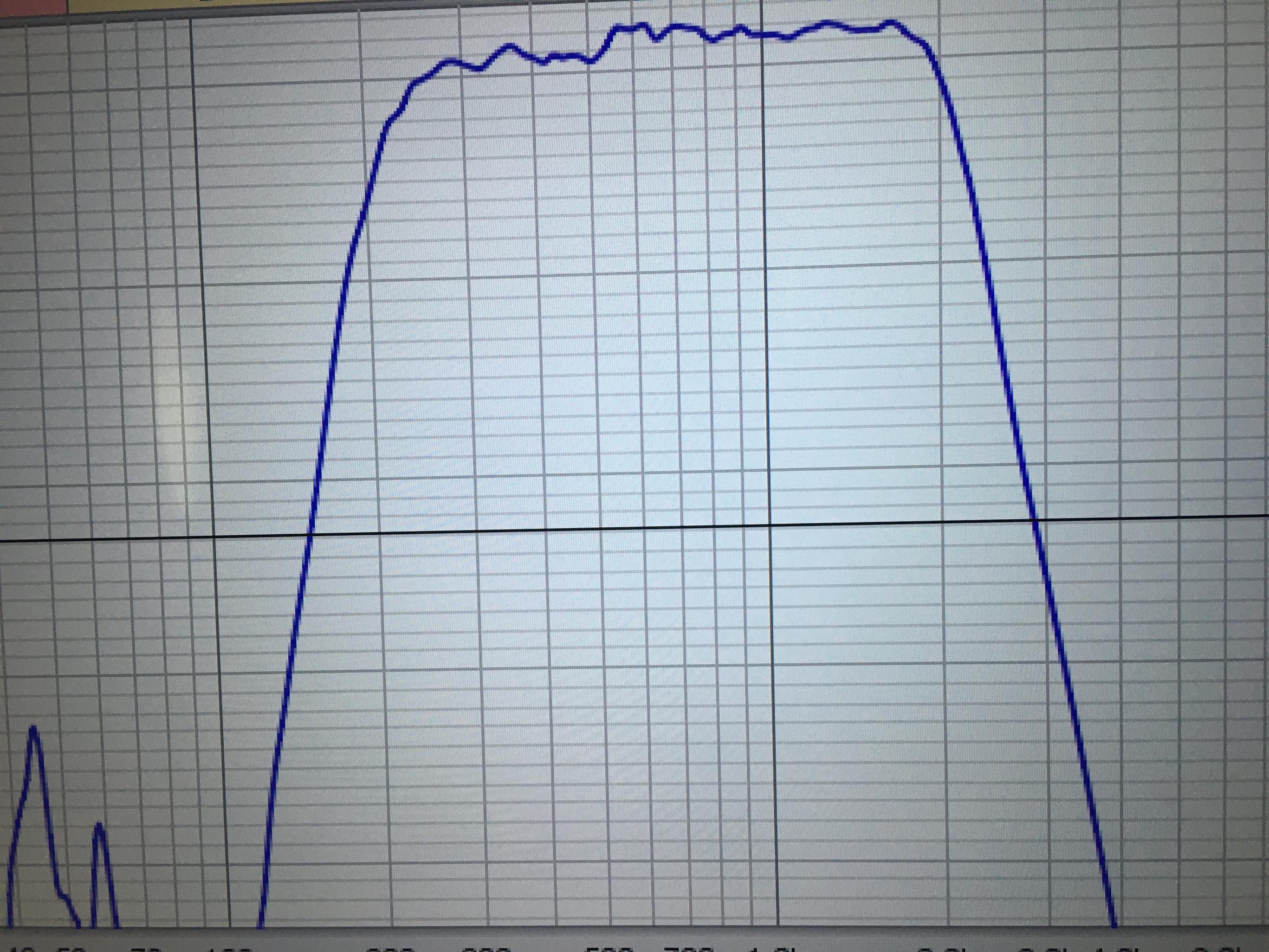

Midrange experiment with Auto sound panel deadener and high density acoustic felt..
The scale is 2db on the fr graph.
The windowing info on the waterfall is in the upper right hand corner of the graph. I won’t be listening until I get the other speaker up and running, the problem which is described in a previous comment.
The FR smoothing is 1/3 octave
1db scale, 1/12 octave smoothing..

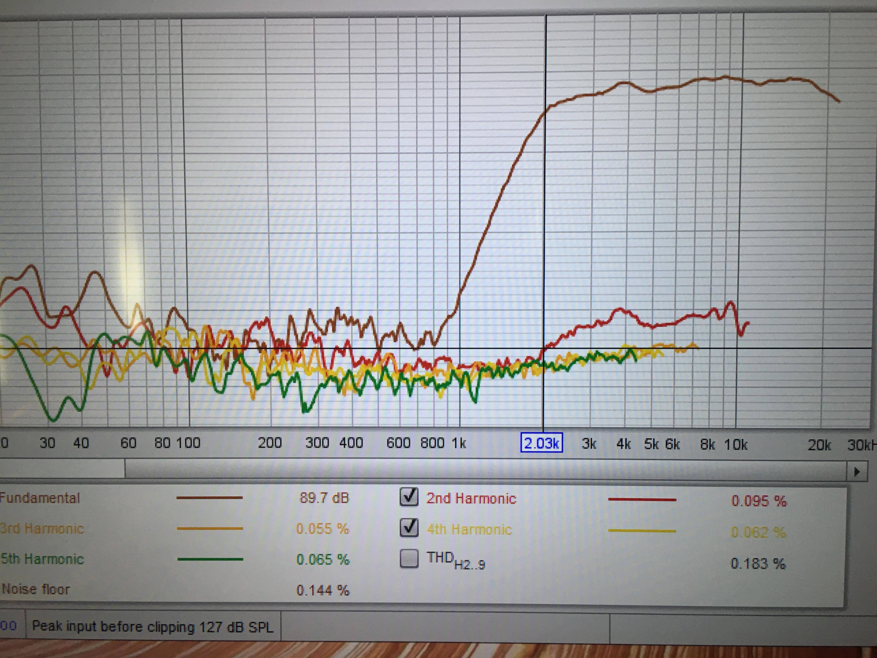

Distortion measurements need to be taken within the context of the testing conditions, but check out this scanspeak tweeter distortion at 2khz compared to above, which is also very low. Of course, the 8th order crossover at 2khz has something to do with it, but still.

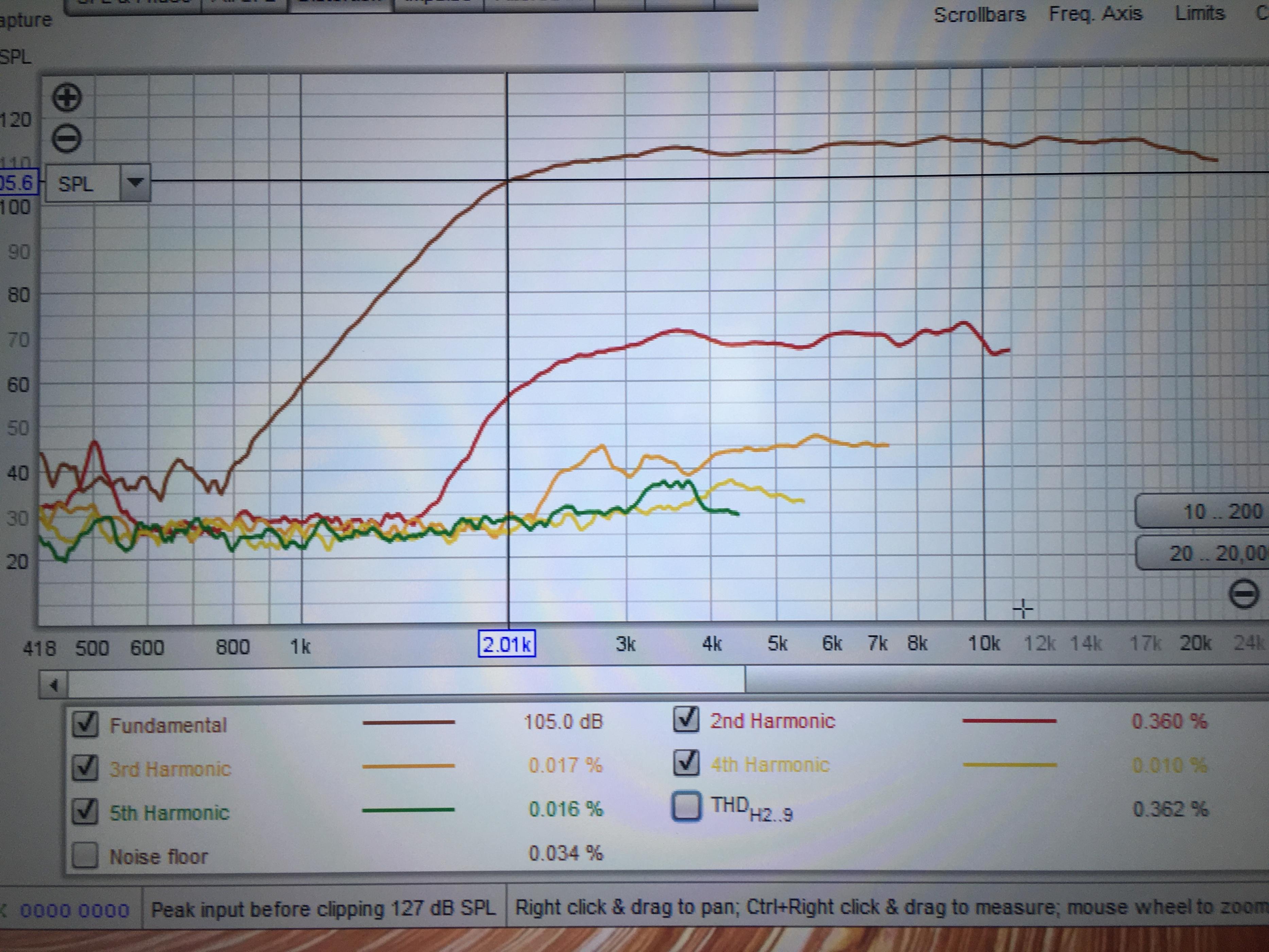

Well, I didn’t actually perform that distortion measurement in a textbook fashion. The following one is. First thing was to measure tweeter pink noise at 90db/1meter, and using that setting, doing the sweep at 10”. That’s why it’s 105db at 2khz. Doing it this way lowers the noise floor of the measurement. Anyway, sorry for the confusion. Oh yes, and don’t forget that this is with a 48db per octave crossover point at 2khz
