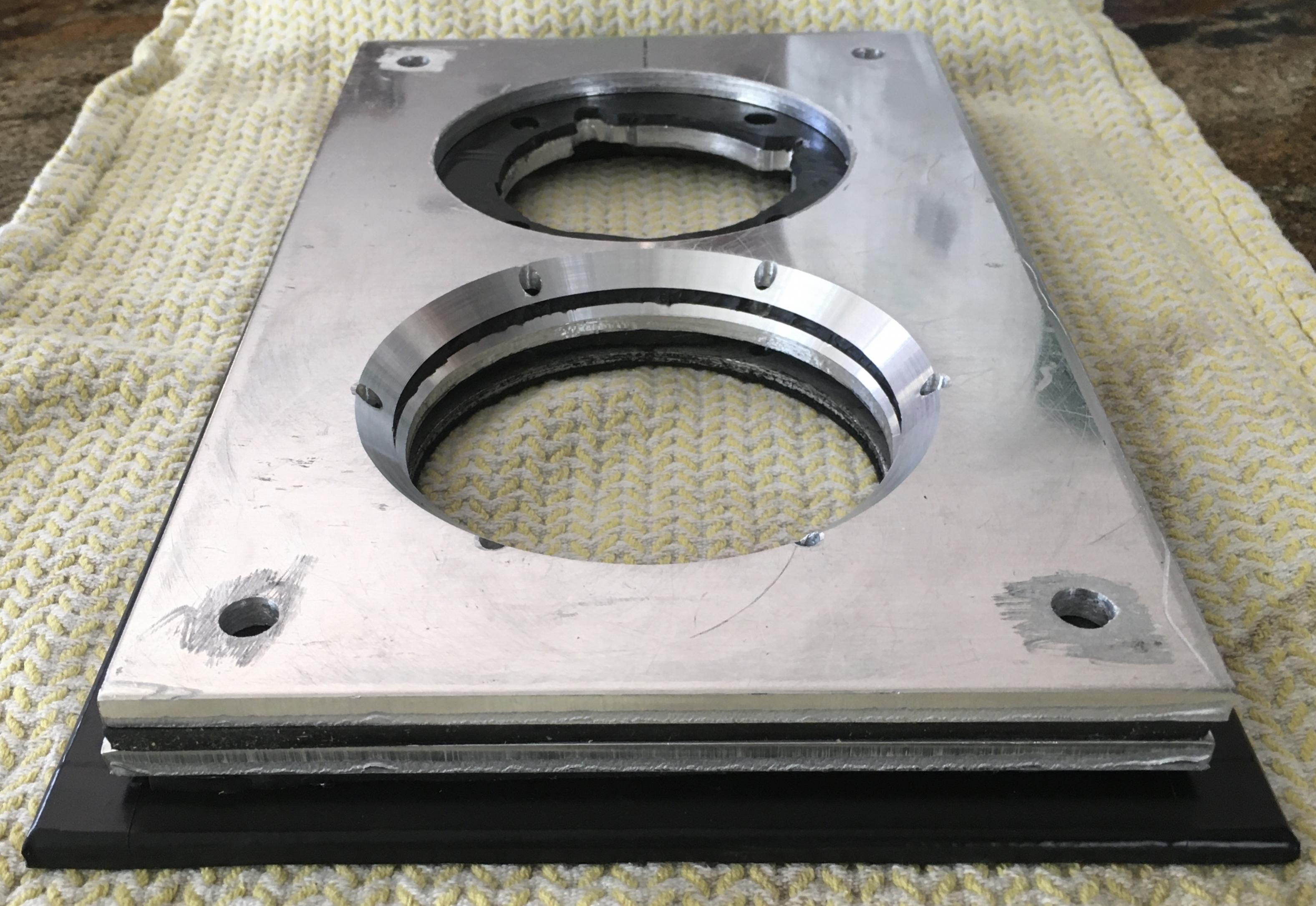

How tacky is sorbothane? I put a sheet of it between two of my aluminum baffles to do some experimenting, and it took 15 minutes and all my strength to get them apart. I honestly thought that after trying for 10 minutes that it was possibly going to be permanent. Really strange material.
The leather hole punch kit I have will come in handy for the sorbothane. There is no way that drill bits or screws can get any where near this stuff. Both will grab the sorbothane and rip the hell out of it. Two layers of sorbothane equals 28 holes per baffle. Ugh.
I often make my own leather hole punches by drilling a hole down a bolt ( easy if you've got a lathe handy, not so with woodworking tools I guess, although I'd still try ) then use a bench grinder to give it an edge. I'd guess that sorbothane is so tacky you'd need an exit hole as well, sounds " interesting " to work with.
I just tried the hole punch on some old sorbothane I have of the same thickness and it worked perfectly with no problems. Phew! I could also talc the sorbothane to make it easier to work with and then wash it off(It's waterproof) before the final application.
This is after barely brushing it up against the metal. No pressure applied at all and actually took effort to peel it back off. Crazy weird stuff.

The previous photo is of the back of the baffle, but on the front of the baffle, the tweeter will be mounted directly on to the sorbothane. Getting the tweeter back off the sorbothane(if needed) would Just involve pushing on the motor housing from behind

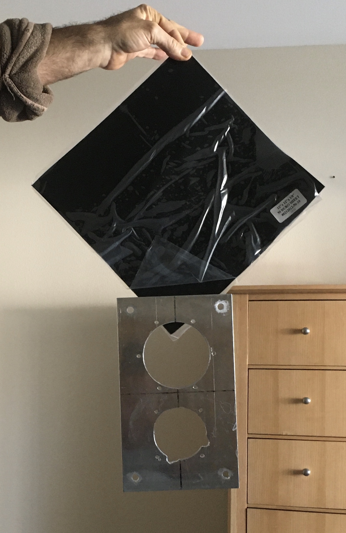

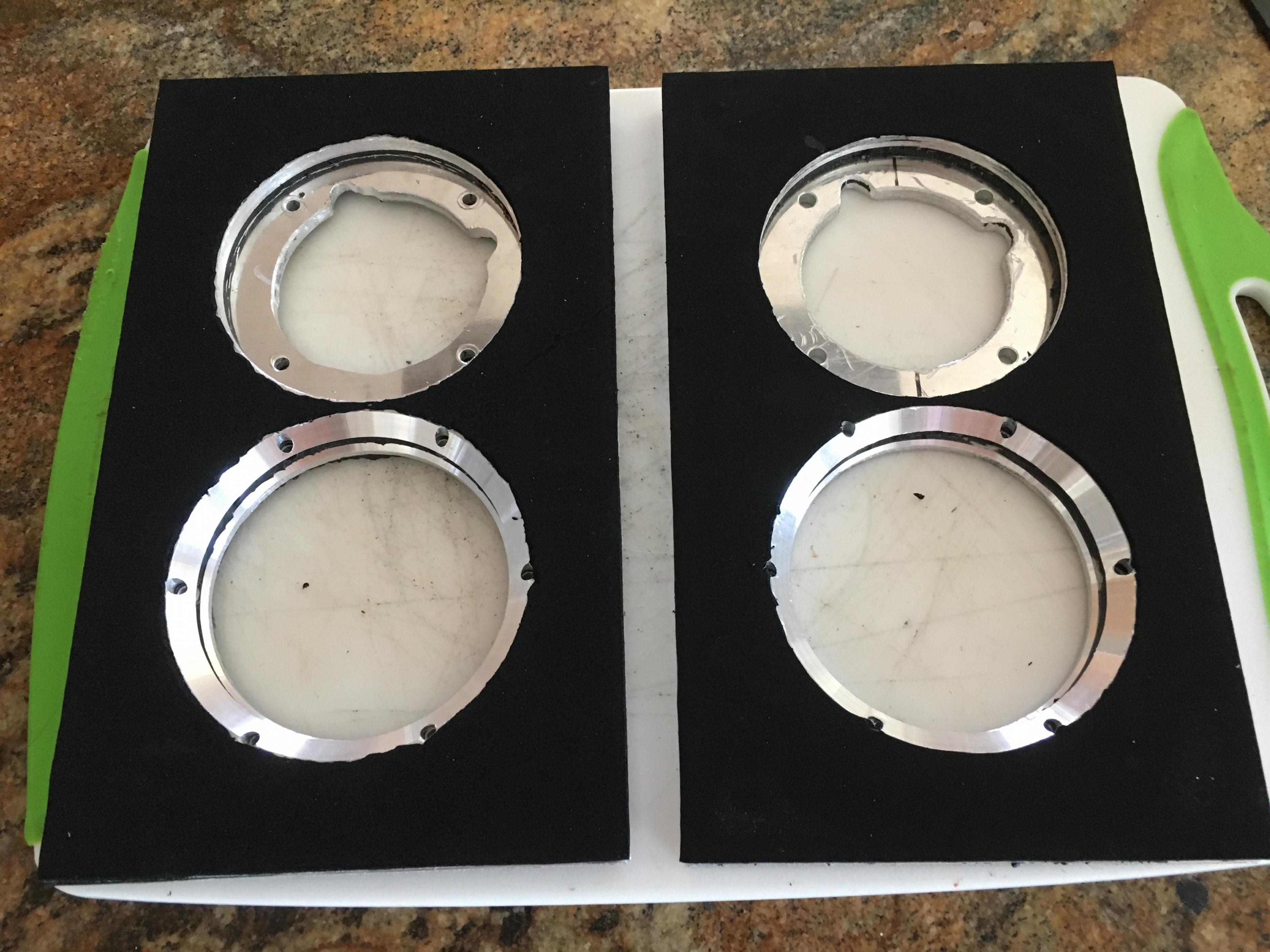

Baffles are getting too thick, so I’m using 1/16” adhesive neoprene on the back of the baffles. These will essentially act as the gaskets too.

The most important thing about sorbothane(not neoprene) is that in order to work best, it needs a certain specific amount of compression. I will tighten a little, knock, tighten a little more and knock again until I get a proper thud.
Compression of the sorbothane will happen at the corners and at the woofer mounts. I wished I could have done the the tweeter area differently but I took the lazy way out and made a larger hole underneath because I didn’t want to deal with more bolt holes and terminal cutouts. That would have given me the opportunity to evenly compress the sorbothane over the entire baffle with just a little more work involved. Oh well.
