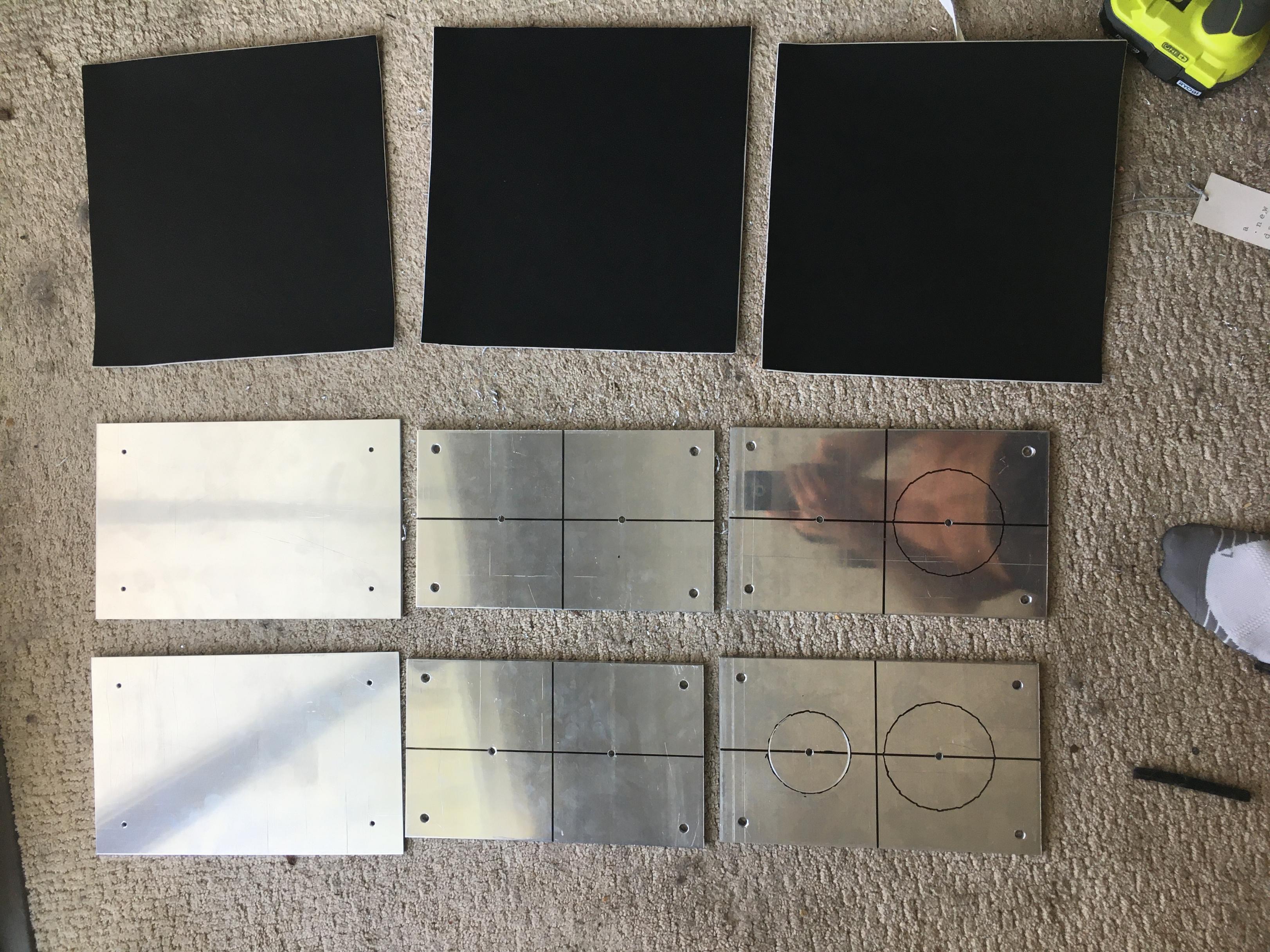

These are the blanks I started with.

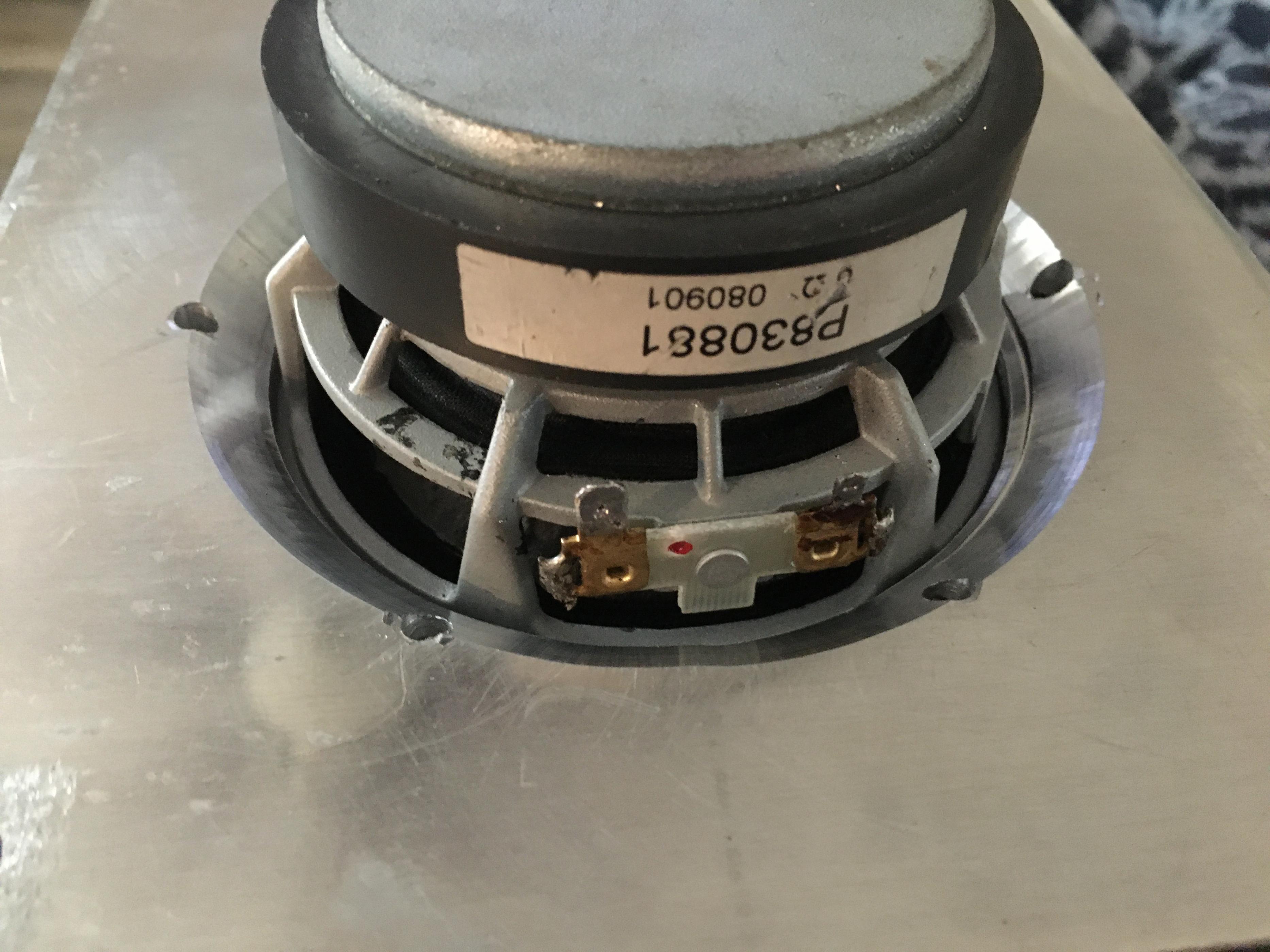

In the end, the drivers will be decoupled from the baffle(including the driver mounting bolts), and the constrained layer damped baffle will be decoupled from the cabinet (including the baffle mounting bolts), by using relatively high durometer rubber washers and where the baffle meets the cabinet, sorbothane gaskets.

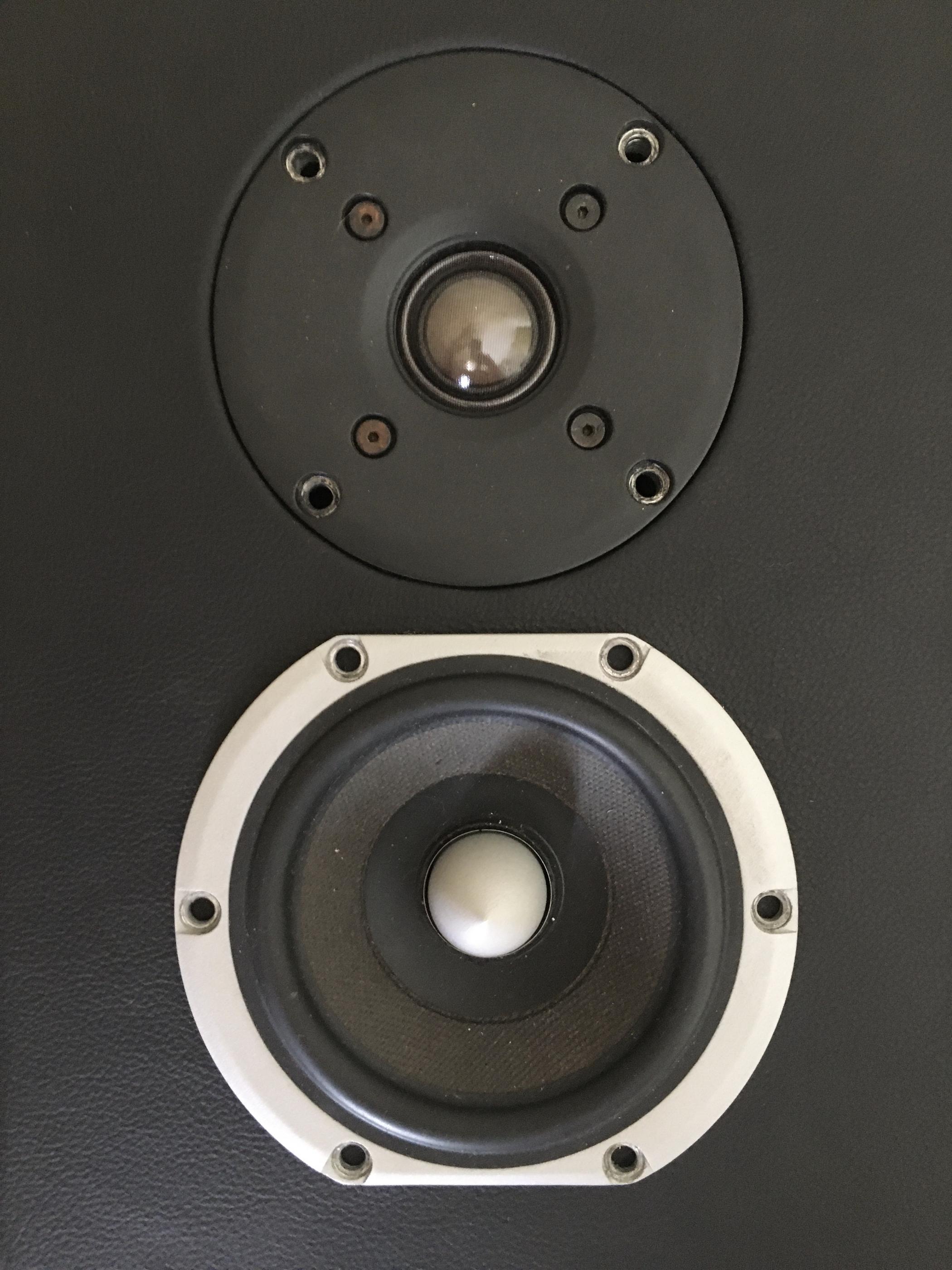

The mid bass itself has sculpted edges for top mounting, so it will be mounted to the leather on the baffle, which will obviously act as the gasket. I’ll take the 4” midbass as low as distortion measurements will allow. Probably around .5% at 90db/1m

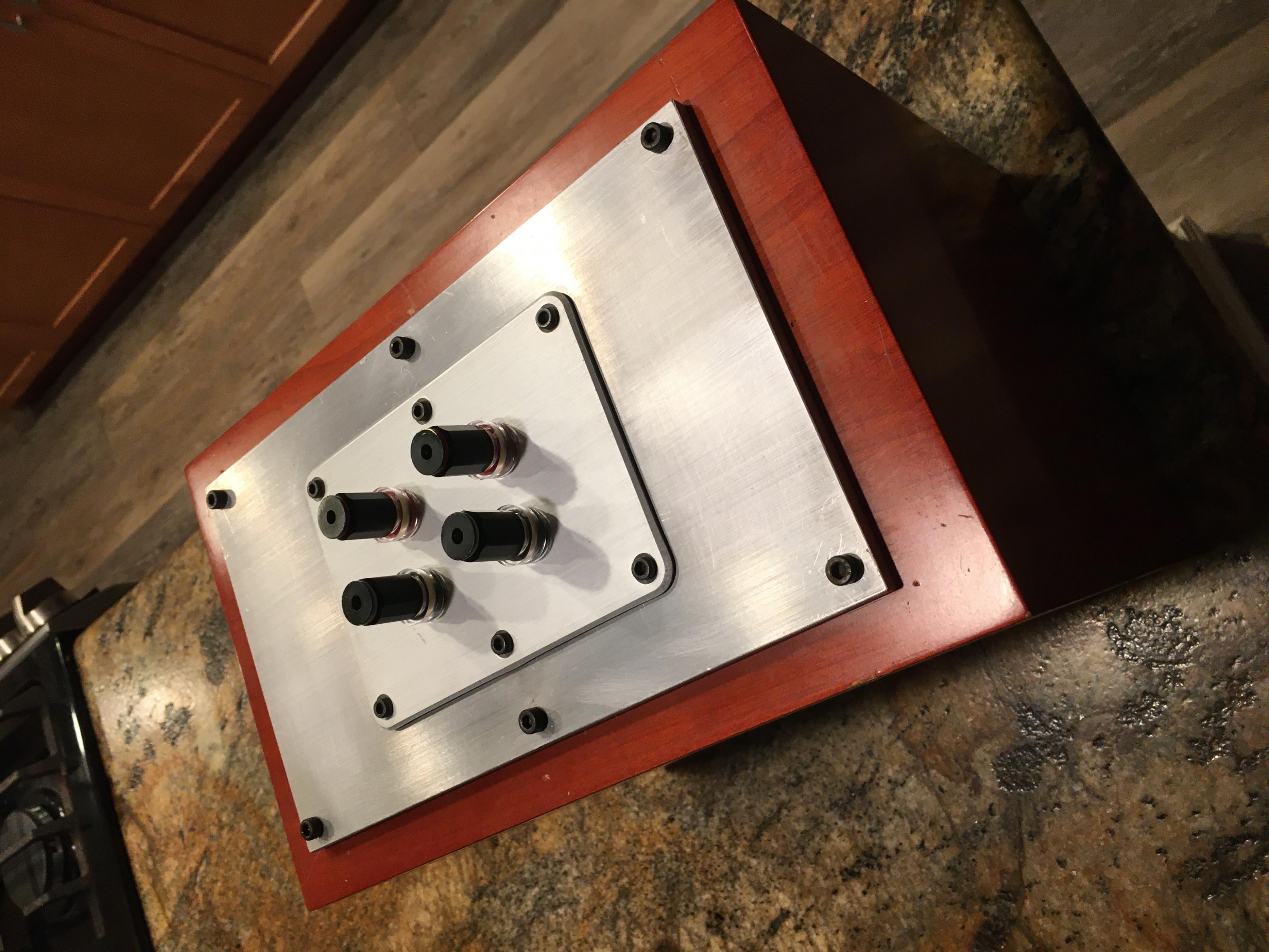

In order to get the high density acoustic felt behind the vertically aligned cabinet brace, I had to cut a large hole in the back of the speaker, which obviously required more 1/4” aluminum Plates as covers to match the fronts.

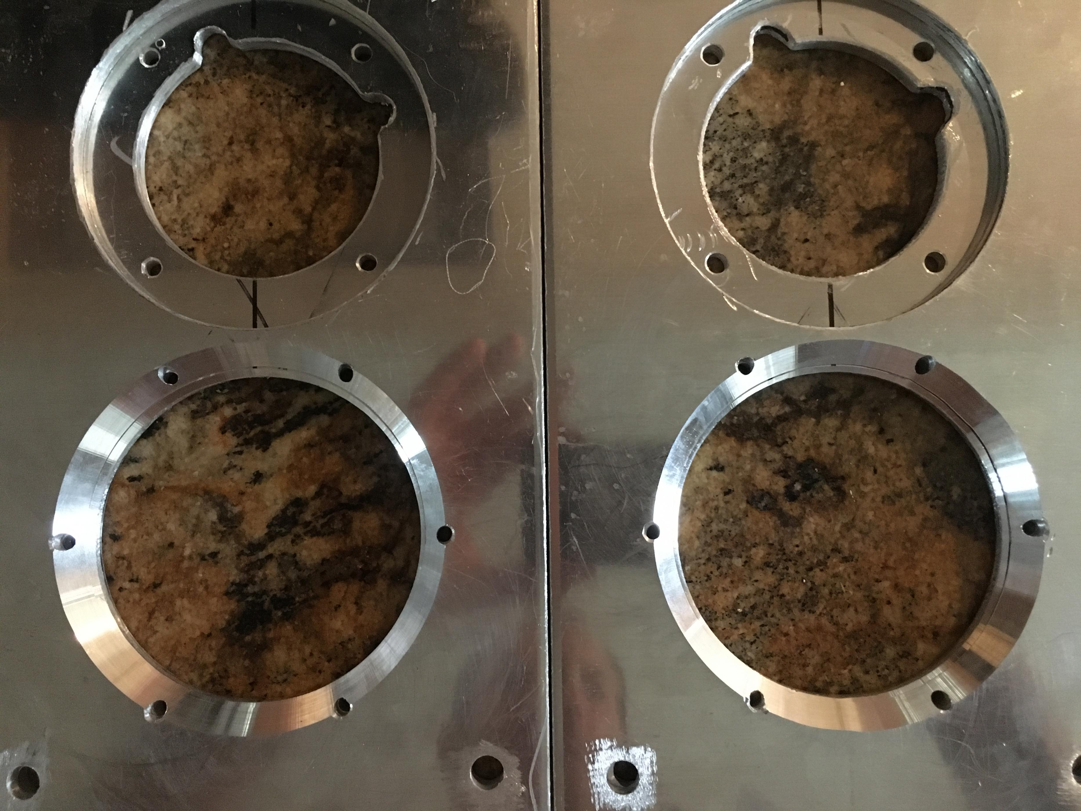

Chamfering wasn’t perfect, but it’ll work🙂 lopsided look is just from the camera angle
You did that with woodworking tools? I've worked with leather for 30 years, I'm not sure it's as good as cork but I use hard 1/4 inch thick ( ox hide ) sole leather, softer stuff might be much better, pigs belly wouldn't be to bad. I'll be glad when they're finished and you can give your impressions on how they sound.

After doing a few experiments with the leather, I decided it would be suboptimal for what I'm trying to achieve with CLD, so sorbothane it will be. I'll still use it on the front though.
