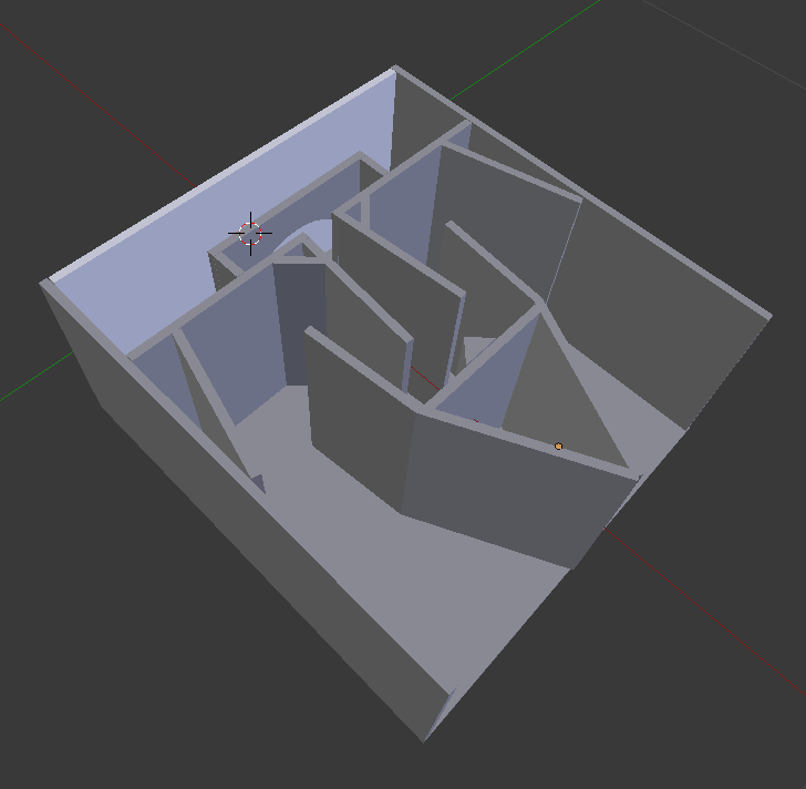

Won't it have been posible to arrive at the same horn length with just a single fold and the same outer dimensions ?Picture below is the midbass horn I designed long time ago ...
Regards
Charles
Thank you!My room has a bit of an odd shape, with open kitchen and a wall halfway but the speakers are about 3 meters (9'20") apart and 3 meters from where I am listening. The speakers are toe'ed in, across the side walls and the mouths are roughly 1/3th of the length of the room from the back wall. I use bandpass subwoofers in a quasi-single bass array below 80hz. Picture below is the midbass horn I designed long time ago and long time pal too.. I call it the MIGhorn.
I will look into what a "bandpass subwoofers in a quasi-single bass array" means.
Thanks for including the midbass horn. I had not thought of W-shapes for midbass. How high do you play them? Could you share the external dimensions for my reference?
Good question, I don't know because I did not try ;-) but possible, probably.Won't it have been posible to arrive at the same horn length with just a single fold and the same outer dimensions ?
The total exponential horn length is ~106cm -excluding pressure chamber and back chamber- and the mouth area is 1800cm2 and proximity of the floor helps. I had no choice but to make it more compact due to room constraints. It's outer dimensions are 670mm x 624mm x 324mm. 12mm chipboard (cheap). Driver is 20cm/8 inch (my secret ingredient 😉)I had not thought of W-shapes for midbass

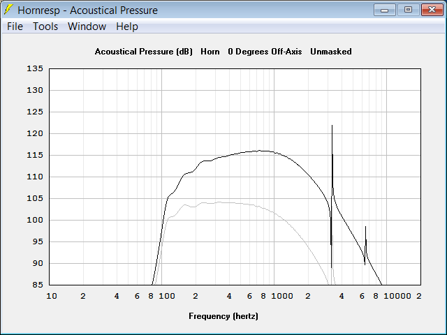

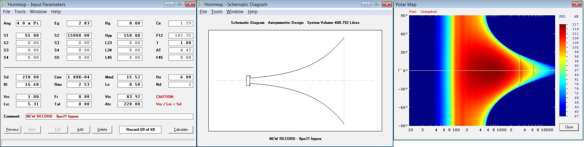

Easiest way I can visualize/'explain' it is to look at a compression horn's theoretical response on axis using HR's 'directivity' option and calculate how many meters away required to flatten it.I don't seem to have that problem. I've enquired about an explanation a few times but I'm still uncertain.
