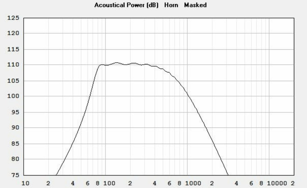

Thank you!You have the same compression in both versions, but the 2nd version should be modelled using the Vtc tab to allow for the different volumes, instead of modelling the throat chamber as part of the horn.

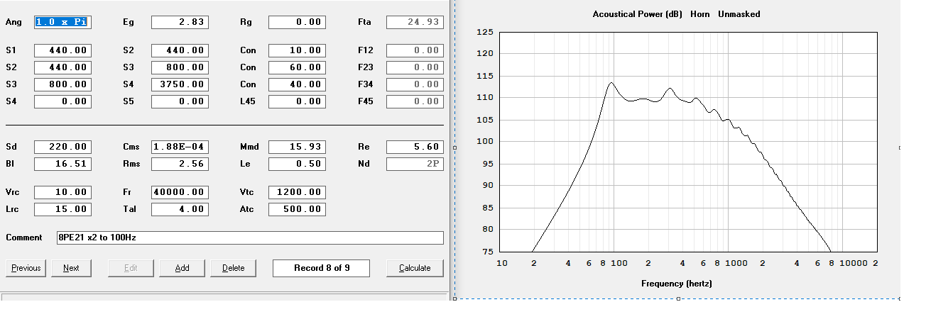

I had not touched Vtc from the default value...

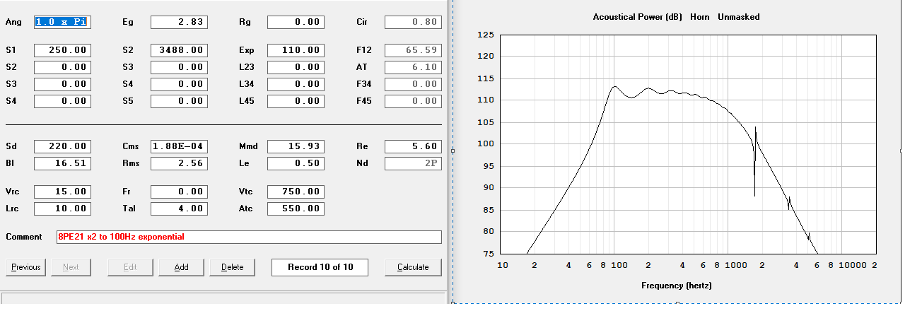

Now I have used the Vtc tab. Vtc of one driver comes out as 375cm3. Should I use 750cm3 in this model?
I used Atc=2xSd for no compression. Is this correct?
I also adopted exponential flare.
thoughts?
thanks again!!
750cm3 is correct for 2 drivers.
If area throat chamber is the same as 2xsd then yes. If throat area matches the sd of 2 (round) drivers then the drivers will be partially covered due to the 'wasted' space between drivers. (throat would be whatever ratio you want, but if drivers are touching 1 above the other then a rectangle would be 40cm high by 11cm wide)
With exponential just do s1=440, s2=3750 and set the length to 110 exp. Leave s2 etc at 0.0
Thank you!!!

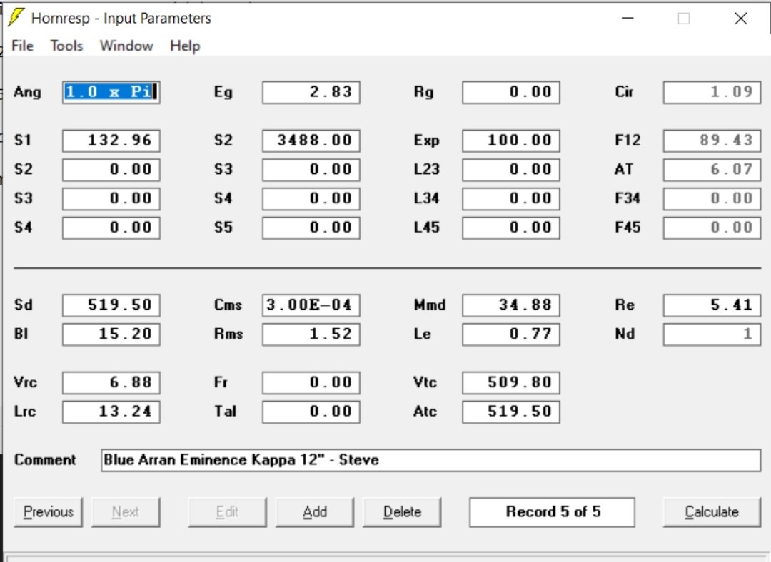

Thanks for including your model!
I noticed you use Fr=0. Means no lining in the rear chamber, right?
Also changed to the same mouth size you use.
Increased Atc to account for what you mentioned ("wasted" area), and also introduced some compression (about 2:1).
looks smoother and more extended, at least in the modelling.
How low would you cross this horn from you can see here? Of course measurements post building will dictate that, but wondering if 90Hz seems reasonable or there is a rule of thumb that suggest it should be higher than what the simulation shows.

I cross at 350, has been as low as 330.
I wouldn't want to play the mid bass horn anything like as high as to where they model well though.
Get so much more out of a large format compression driver tone and speed wise.
I've tried lining / no lining.
Also a smaller chamber volume seems to work better in general.
I tune to room size where possible, measuring my way.
I'm going to be building a 1.7m long exponential pair soon.
Ideally to use the same Eminence 12" driver.
Models down to 52Hz! Easy up to 350Hz. Nice.
Will still fit through a regular door..
