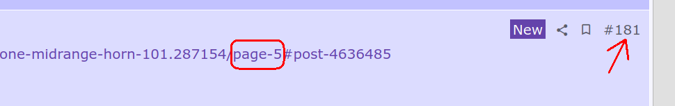

Hmm, this just takes me to the 5th page 🙁 Anyway, thinking this is the one he wants ............ from here
If you post the number (in the thread or by PM) and tell me if you're looking for a thread, a post or an attachment, I'll try to find it..How do I link to something previously uploaded knowing only thread number but not title?
As the forum is set up to allow members to choose the number of posts they see on each page, this link will fail for members who have different settings to yourself. (Sorry this information is not easier to find)
A consistent link will be found by right clicking any post number and copying the link.
