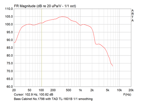

I found an article from Joseph Crowe that clarifies some things for me so I'd thought I'd share it here. It's about his 1798 horn loaded bass cabinet and has all the measurement that I was looking for.
This picture answers my question about the transition between direct radiator and horn loaded.
So you get the shelved response from the BR cabinet, then a hump when the horn kicks in and provides additional sensitivity.
https://josephcrowe.com/blogs/news/bass-cabinet-no-1798

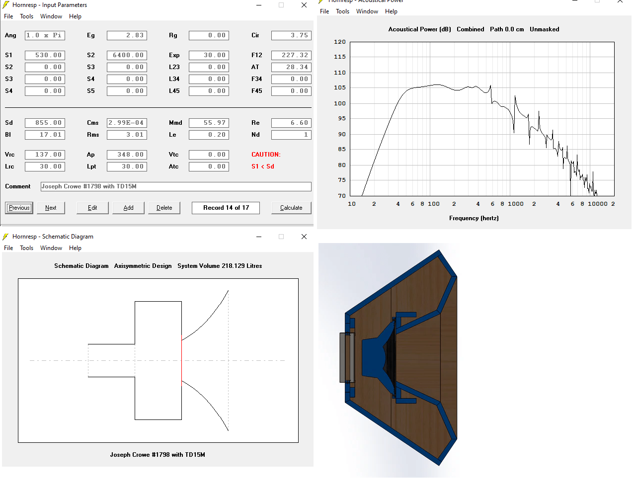

Thanks for posting that link! I've been looking into Crowe's designs but had not seen No.1798.
It was a good exercise to take advantage of his blog and video with explanations. I modelled in Hornresp with the TD15M to replicate his design and I'm a bit confused because I'm getting different results. Frequency response looks different: doesn't show the drop at 40Hz that he then corrects with the forward vents.
But I also noticed the waveguide profile Hornresp displays is quite different from the schematic Crowe posted - he mentioned he would add another straight section to smoothen the "curve" - but the difference between an exponential flare and what's seen on the schematic seems important. What am I missing?
