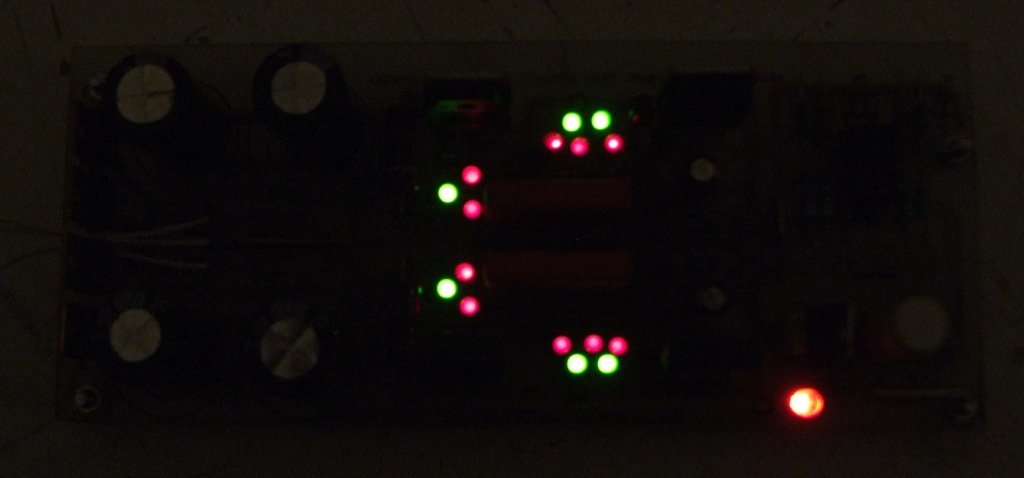

I matched my leds to 9,027V and 5,468 between rails.
My outputs are 9,83V and -9,57V.
V across 2*68R is 1,821 and 1,966 giving ~54mA and ~58mA.
I'm using a 2*15VAC trafo, 50VA.
Is it the leds setting the output voltage? This if I choose to get them perfect at 10V 😉.
Regards

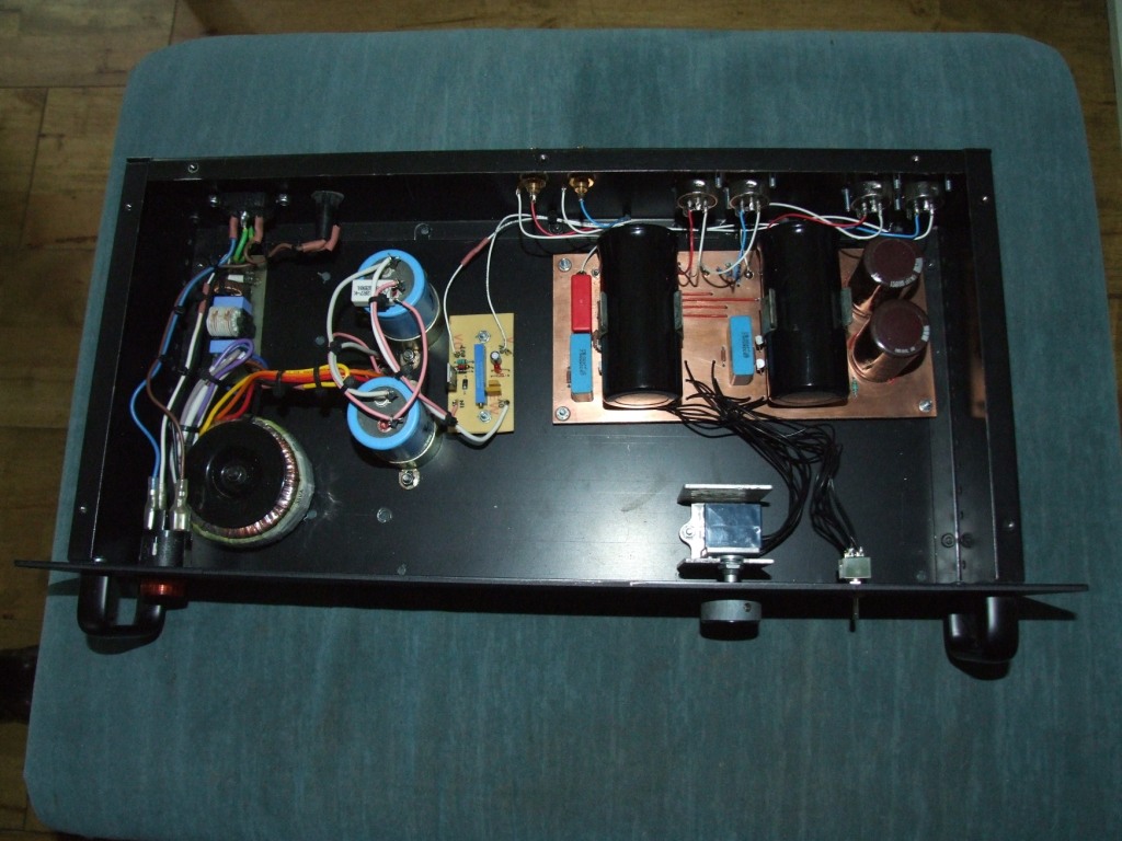

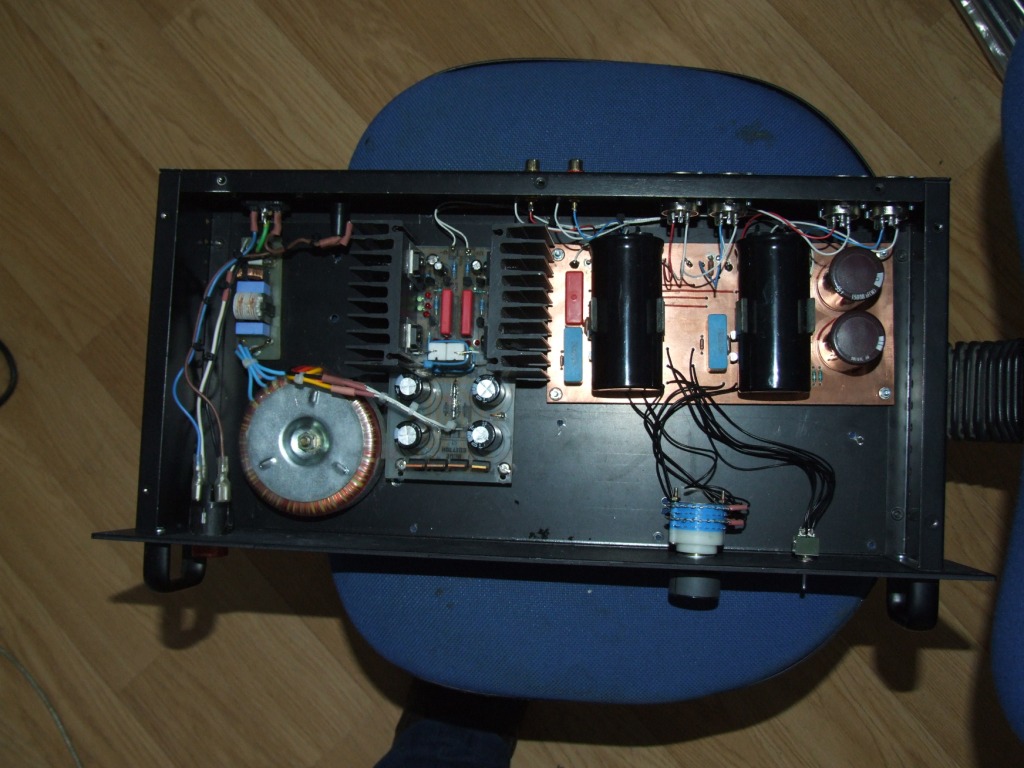

OK, I stand corrected, I've only got the standard B1 but I'm powering it with a Salas regulator.
In my case I use the reg as a single 18V supply even though it does +/-.
The third photo was my Mesmerise but I preferred the original B1 so I chopped the board and just used the regulator part of it.

Exactly. If there was a perfect amplifier for all it would be here by now. We all have different hearing and also different expectations of what Hi-Fi should sound like. I took my Salas regs up to about 1A and could hear no difference, all that happened IME was that things got hotter which affects reliability, in the end I went back down to 10R - which if I remember correctly is about 100mA.
I run the B1 into an Aleph4 which is an altogether "Tubey" type sound, it's a lovely combination that probably suits the PIO output caps I'm using.
I've also got an F5 which I don't like, even with an Impasse pre-amp it sounds poor to my ears.
It's horses for courses - If you like the sound then you are almost there.

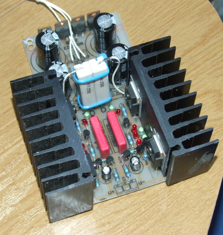

You can change the voltage by playing with different LEDs.
The standard, and original, B1, works fine with any voltage from about 12V up to about 36V.
I originally had mine with LM317 regulator and TBPH I'm kidding myself that it sounds better with the Salas reg.
I did try the capacitance multiplier and that did really sound awful. (Photo 2)
