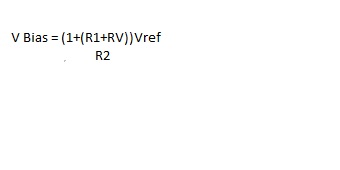

It's a standard shunt regulator configuration with the current limiting resistor removed, same as any bias generator in Papa's amps.
RV=5K
R1= linked out to save space
R2=1K
Vref = 2.495V

Agreed, but in their function they will still be inaudible.
As with everything, it's a compromise, the benefit of using the TL431 over the LEDs is that if there is a slight DC offset on the outputs (in the same direction), it can be nulled by trimming one of the supply rails, rather than risking damage to the PCB by swapping LEDs.
I wasn't referring to swapping LEDs once soldered. Just measure them under operating condtions on a bread-board.
