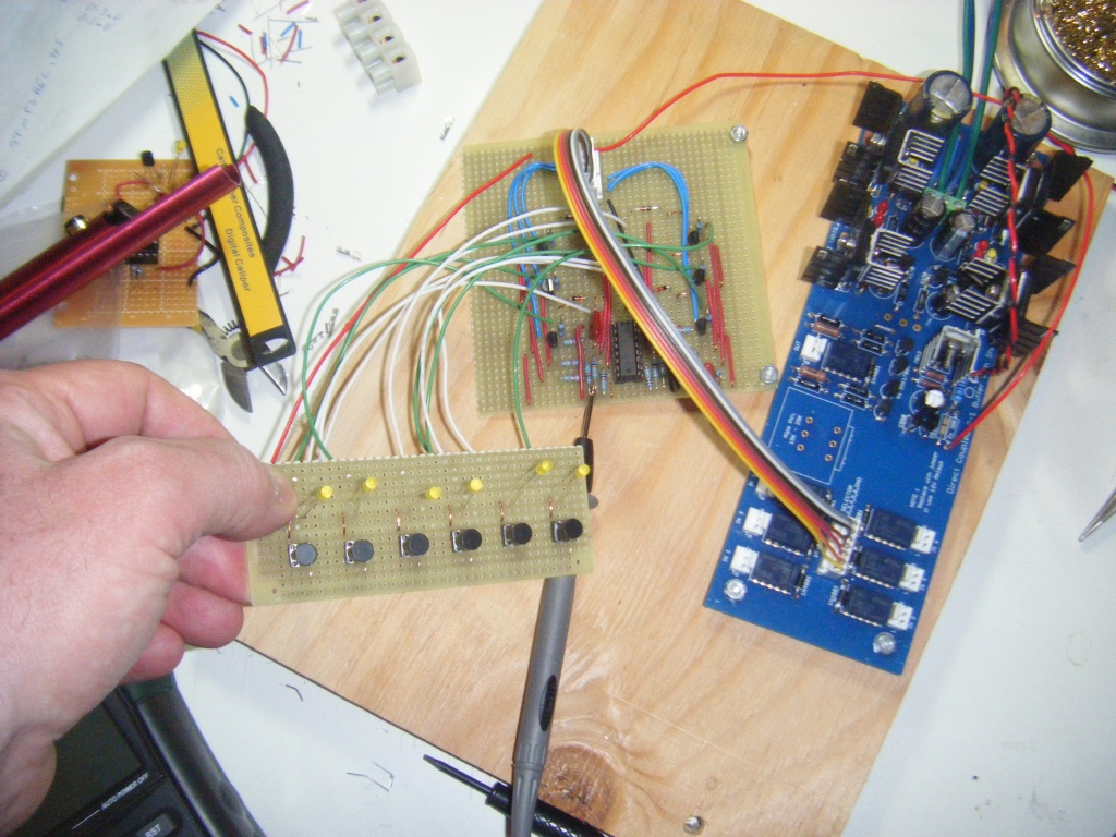

OK, I finally finished my Mesmerize Blue! For input selection I used a circuit I posted here earlier (thanks AndrewT for assistance), and an Antek xformer (50VA 12V) and Par-Metal chassis. I also got one of those Chinese $10 stepped attenuators, which is remarkably good!
I'm attaching a few pics here. I previously posted photos of the board powered up. When I built my push-button selector I had initially planned for the whole thing to fit behind the front panel, but I couldn't get the layout to fit, so I split it into 2 boards:

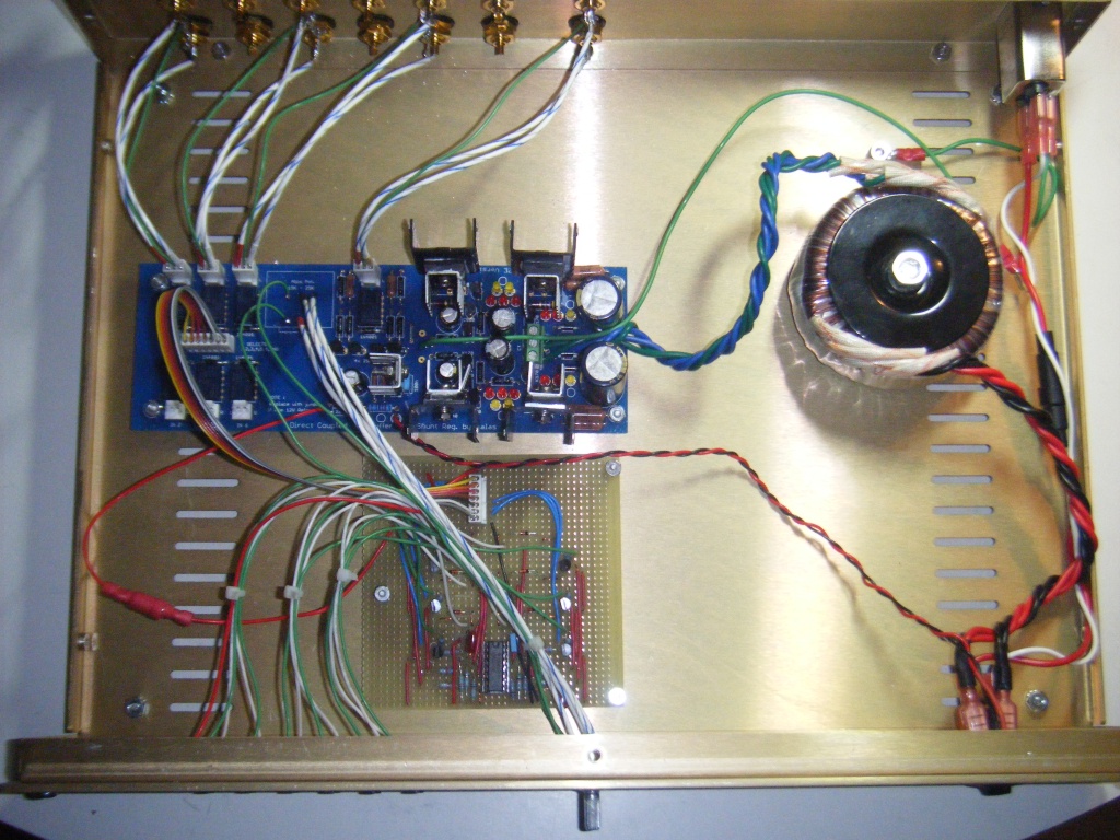

Here is the chassis pretty much wired up. I ran out of my favourite shielded wire, so have only wired 3 of 6 inputs so far.

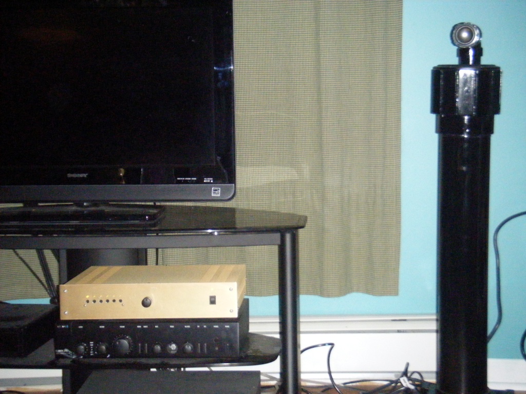

And here is why I built it: last year I built a set of Linkwitz Pluto speakers, but it seemed to me that they were not sounding quite right, and that my "preamp" (pre-outs of an old Arcam integrated amp) was the reason (I don't think the TL072 liked driving long interconnects):
Finally: The sound!
Yes, it makes a difference. Lows frequencies are definitely deeper and tighter, which is interesting because the Pluto eq/xover is AC coupled and has a built-in LF roll-off (15 Hz I think). More importantly, I had felt that the Plutos were missing some high-end "sparkle", which I attributed to some HF roll-off due to cable capacitance and a high-ish output impedance. The high end is back! I probably need to adjust the tweeters down a bit now.
Salas, thanks so much for this design and all your help, and others here (notably St. Andrew) also for the freely offered assistance. This is definitely the best thing I have ever built!
