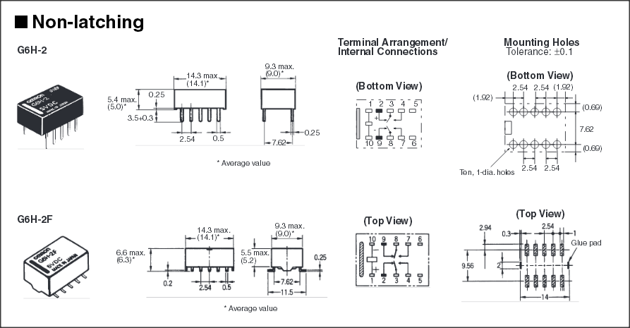

How you can measure output offset if the output relay makes no contact for instance? Impossible. Maybe you used latching type relays? Correct type is Ea2-12NJ
By top view the board is having the +mark on pin 1.
Salas thank you for your coatching. I just found the mistake. I did not solder one pin in the input relay. Output relay is working properly so that the offset is just that i wrote. Must i make some rekonfiguration of jfets.
