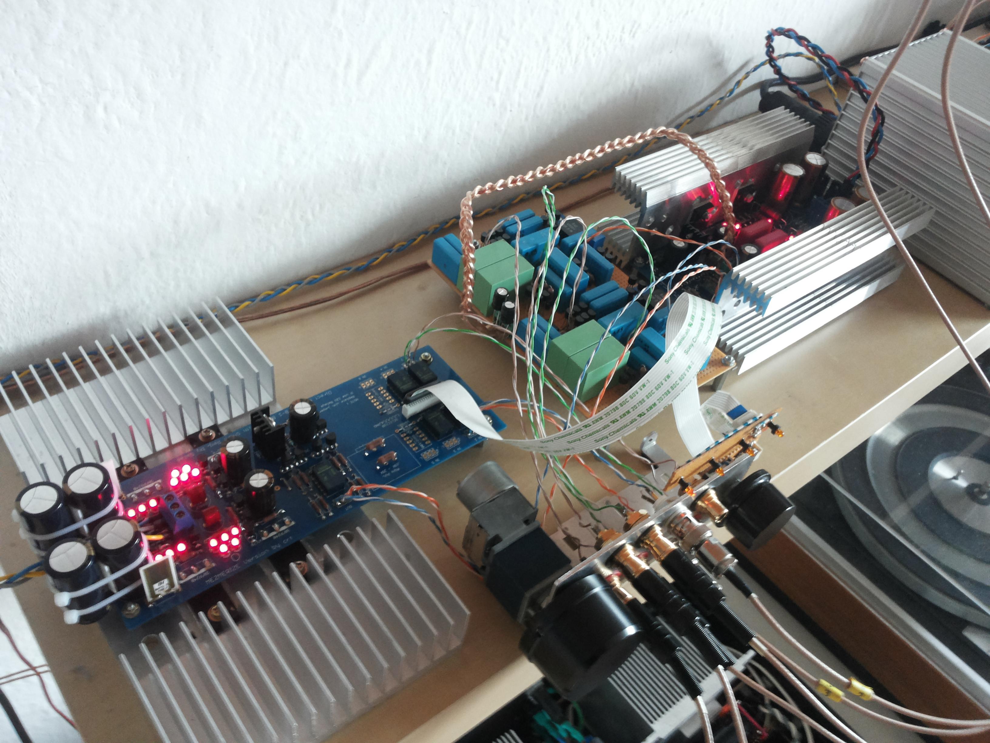

And another DCB1 Mezmerize has come to life!
A few comments on my build:
  • The smoothing caps are Panasonic FC 2200uF 50V, I piggybacked two together to get close to the recommended 4700uF. The CCS resistors are 10R 5W thick film, so we're dealing with a moderate hotrod version here. The resistors in the signal path and for the regulator portion are Dale RN55D, caps are Nichicon Muse, expect for the LED string caps, they're some 0u47 Panasonic PP film caps. FETs are IRFP(9)140N, diodes are SF16. The 4 2SK170 JFETs for the buffer were all somewhere around 7.5mA IDSS, the others in the reg somewhere around 8mA.
    The heatsinks are way oversized, but hey, why not.
  • As I've mentioned earlier in this post, I'm using 221R gate stoppers (instead of 470R), and judging from what I'm seeing on my 20MHz analogue scope, it's not a problem (no oscillation) to use such a small value.
  • Since I am pairing this Mez with a DCB1 blue edition (Hypnotize), which in turn is fed into and supplying a DCB1 style crossover, I have placed the volume control between the Mezmerize and the Hypnotize. At the Mez's input, instead of the pot, I have placed 22.1k Dale RN60D resistors from signal to ground, which in parallel with the buffer should form an input impedance of pretty much 20k. I have the impression that my source (DAC) likes the fixed resistance better than it did like the direct volume pot before.
  • The source selector I took from my old BOZ build, and since I'm only using four inputs, I spliced the indicator LED's onboard supply into the ribbon cable to remotely power a LED which is indicating the selected input (LED's ground is individually switched through together with relay).
Here are some Numbers that I've pulled from the circuit when I was testing it with a DC benchtop supply:
+V_supply=18.09V -V_supply=-18.13V (from DC supply)
+V_10R_drop=1.35V +V_10R_drop=1.43V (divide by 10R to get current in A)
+P_10R=182mW -P_10R=204mW (dissipation of CCS resistors)
+V_reg=10.23V -V_reg=-9.49V (regulator supply voltage)
+V_3LED=5.42V +V_5LED=9.60V -V_3LED=5.45V -V_5LED=8.85V (voltage drop over LED chains)
V_output_L=1.1mV V_output_R=-1.9mV (DC output offset)
So far my build is looking good, noise free, well tempered, and it sounds very transparent. :D

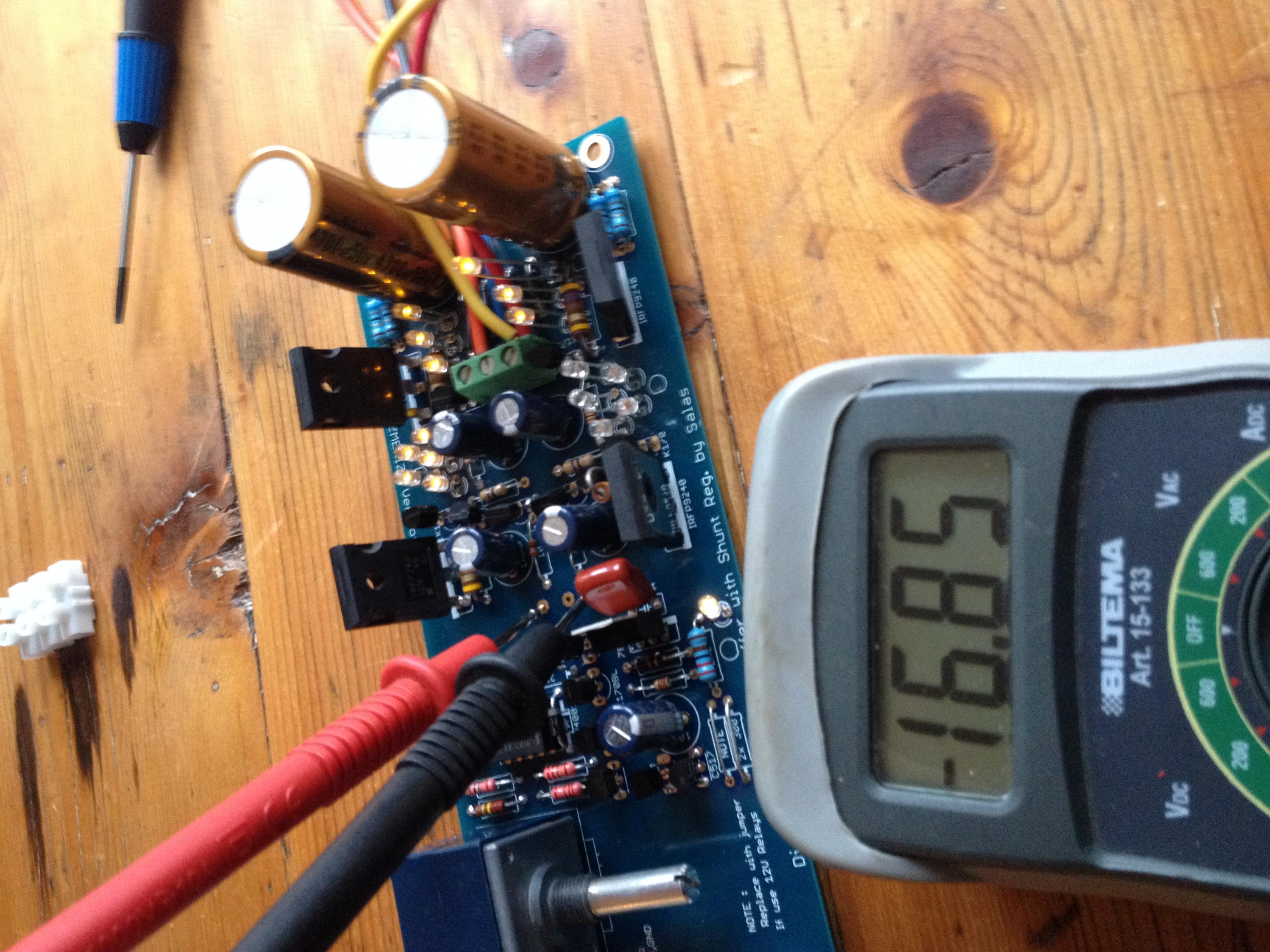

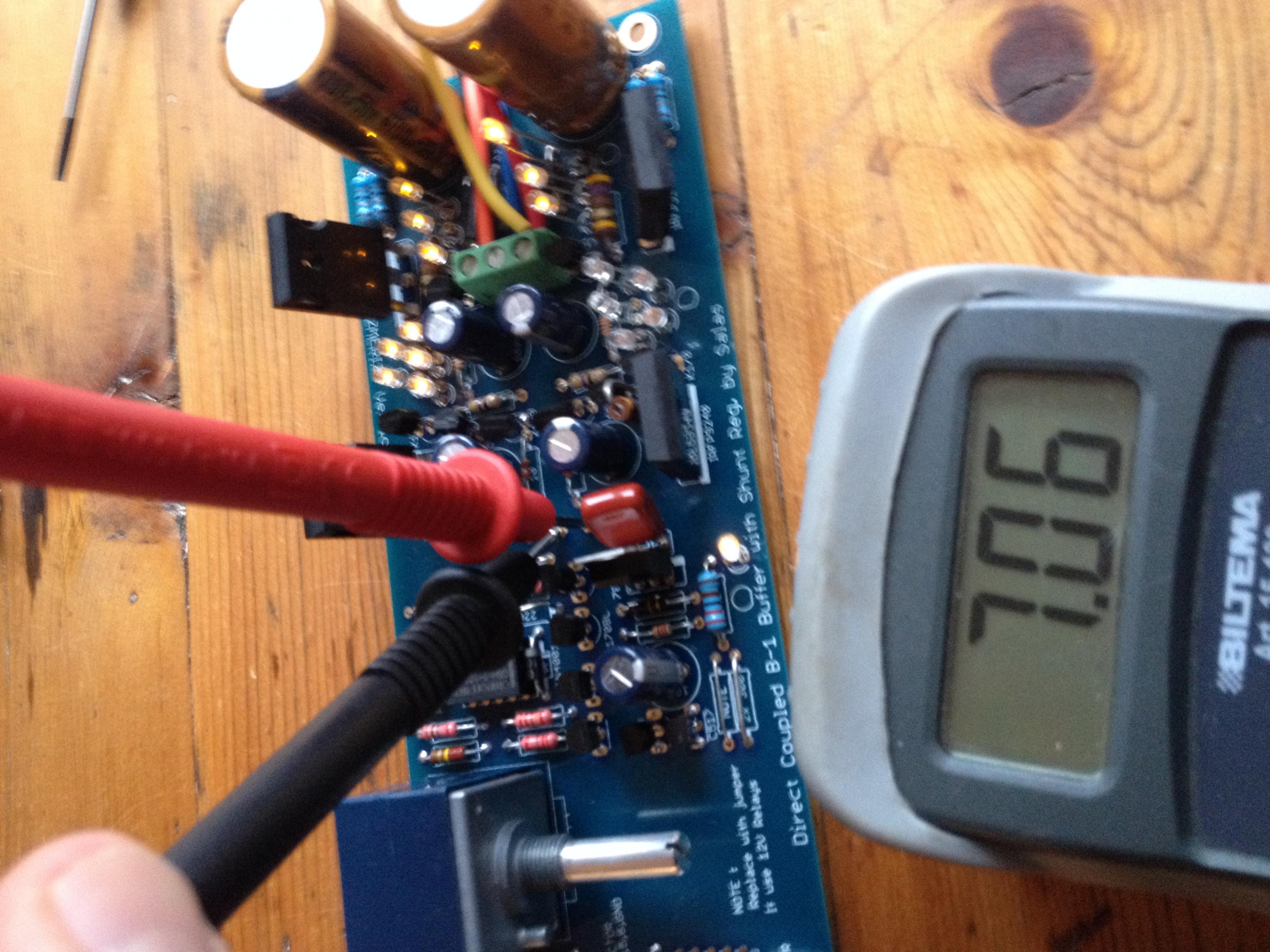

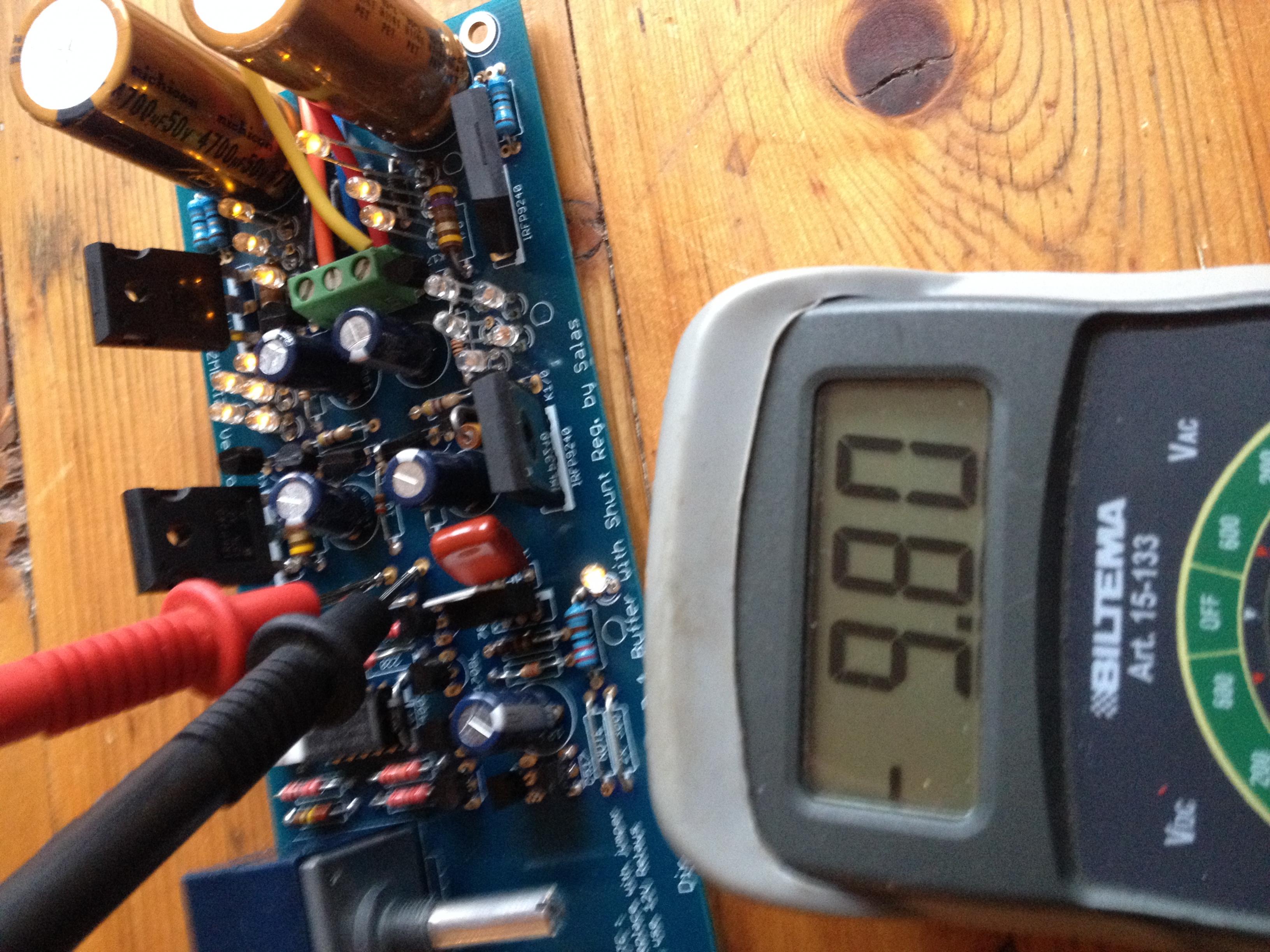

Hi!
This is my first post here, but I´ve been following for quite some time.
Me and a friend have been building a Mez each, and we both have the same fault.
One of the led groups won´t light up. See photos for closer detail, and voltages.
Carefully measure the voltage across each unlit LED.
If one is back to front it will show a much higher voltage drop. LEDs are not good blocking diodes and may be damaged by reversing them. Better to replace rather than trying to carefully remove it for re-use.
If all the LEDs are reversed, then power Down and use the Diode function on a DMM (sometimes the 2000mVdc scale can do this job) to determine the rough Vf of each diode. Each should read open circuit when you swap the probes. If all are OK then swap them around. This time they should not be damaged by the reverse voltage, since they all help each other.
Hi, AndrewT. And thenk you for you response!
All the leds are mounted correctly, and the all work. Tested!
However this group does not light up. New today is that they light up very shortly when powering on (I use a switch on the tranny), but then fade out and die.
I also get DC go all legs on the power gets when measuring from the centre points on the board, across to the mid leg go both the 240s and the 9240s.
I am a newbee, and at a loss :)
Thomas
diyAudio Chief Moderator
Joined 2002
OK. Also check there is no BC transistor in a K170s place by mistake, so we are sure about all the parts placing first.
After that put the DVM probes across the BE pins of the BC transistor on the dark LEDS side, it must have about 0.6V. If not, replace.
Then on the G,S pins of the MOSFET next to the dark LEDS. The one over the print "shunt reg". You must see 3-4V. If not, replace it.

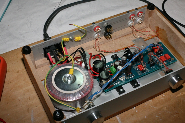

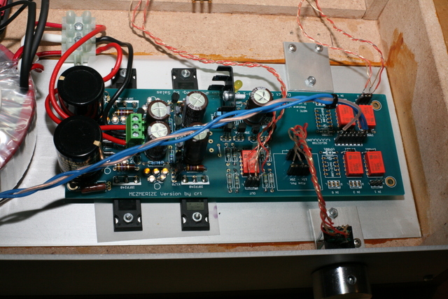

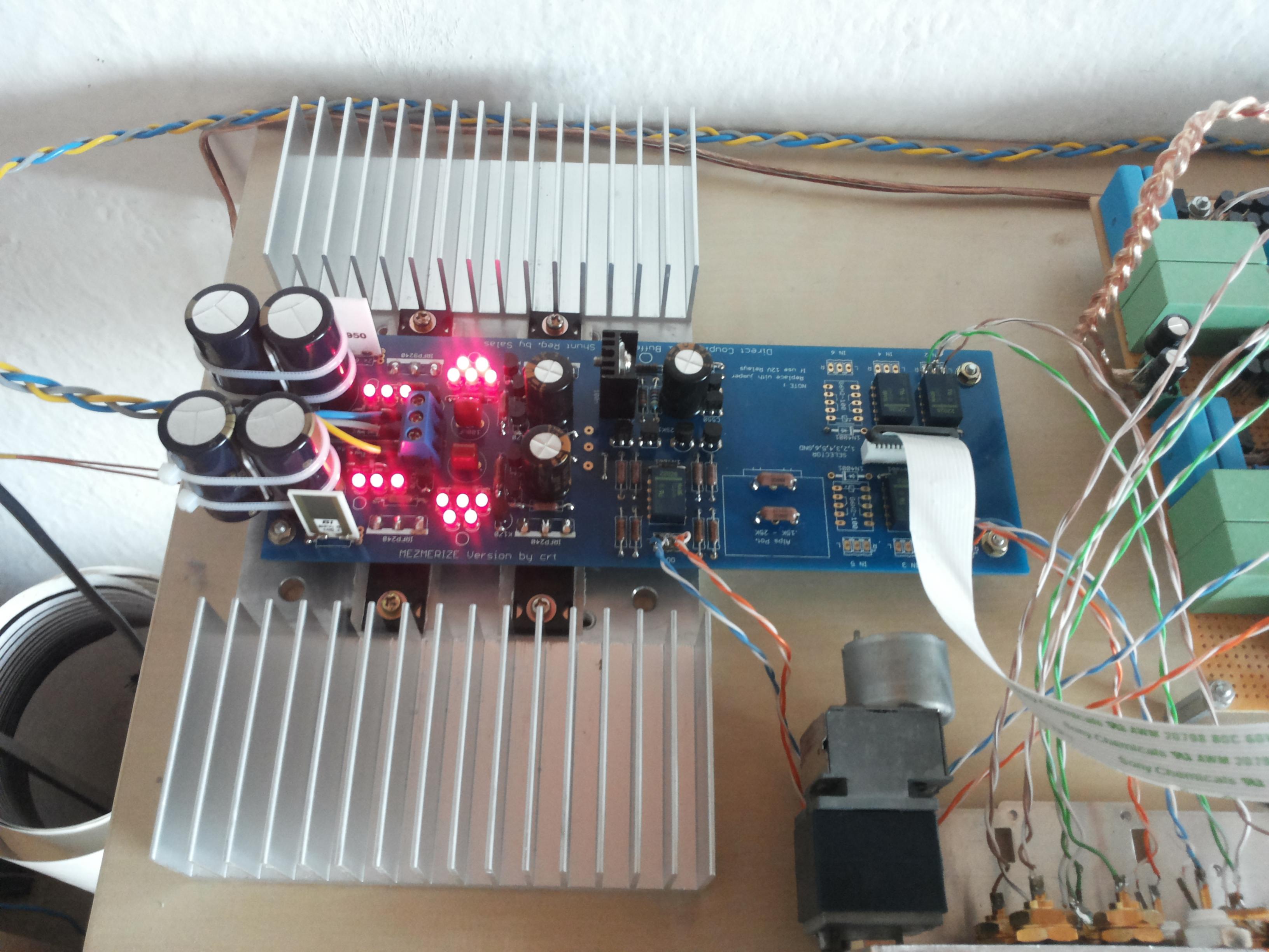

I thought I was finished project but I made ​​a mistake and I need your help to fix it.
Some of the key data:
All LED light.
ACC 16.27V 16.28V
DC + 10.82V - 10.09 V
Offset R 1.1 mV L - 0.54 mV (
How can I get it if relays do not work)
Hotrodded. I use 8.2 ohm resistors. Voltage across the resistor are:
+ 1.793 V - 1.685 V
And the problem. I used the NEC 12V relays that have the same pin configuration like Omron. I hear the relays to switch but there are not
electrical connection. What can I do.
I also used the 15, 0, 15, 150VA transformer, because I thought to give in the same enclosure the phono stage. I will change transformer for smaller. How VA would be optimal in the context of my other data.
Thanks Matjaž
