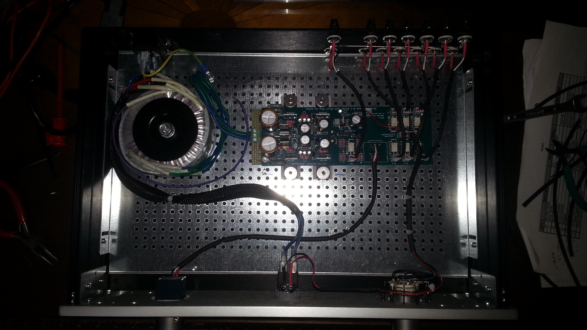

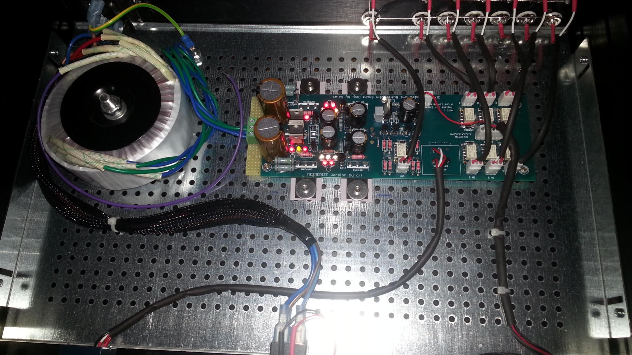

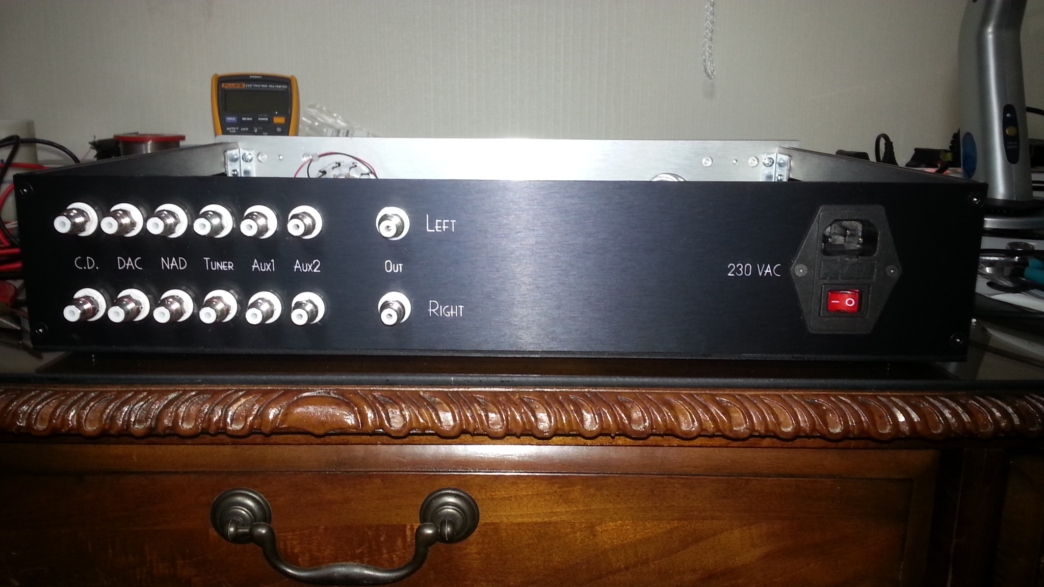

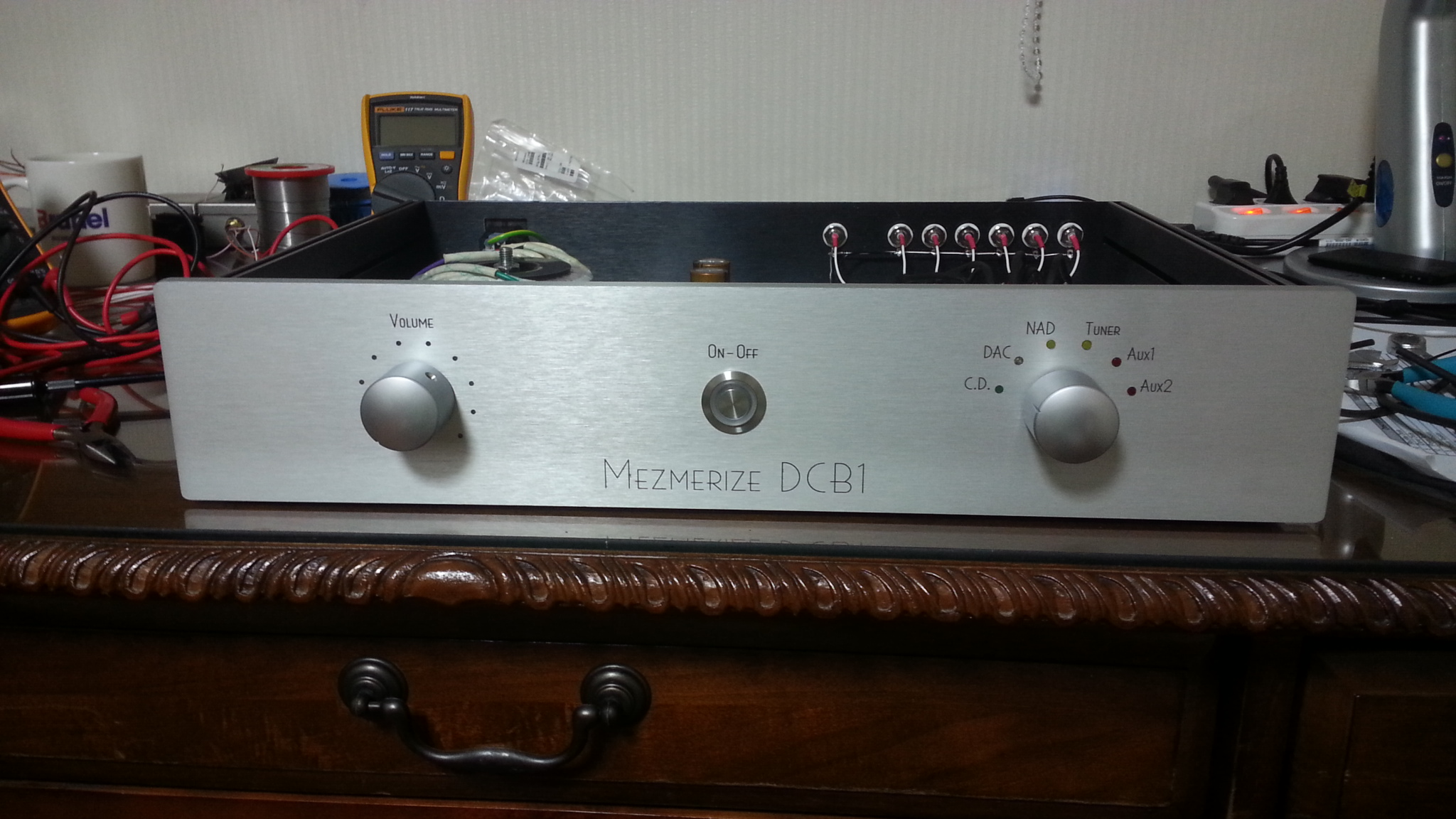

Hi all,
after some weeks I finish my mesmerize... the enclosure arrive two days ago from HIFI2000.
As you can see they do a veeeery nice job :) I am very happy about the result and the enclosure is very well done!:up:
I have a question about the last connection missing... the violet cable from the antek trafo should be connected to ground or leave disconnected? I suppose that is to be connected but I'm not sure
Thanks to everybody for your help and support on this nice project... others are on the way ;)
Ciao
Enrico

Joined 2010
Is the violet wire for a screen between primary and secondary?
If so, then the screen wire should be very short and bolted to chassis very close to where it comes out of the transformer.
Thanks AndrewT for your advice... Luckely the bolt connection is near to the point where the cable go out from the trasformer... may be you can see from the picture where is the bolt.
Regards
Enrico
.............The purple/violet is the earth screen and should be connected to ground..................
NO !!!!!!
The screen must be connected to Chassis. This connection MUST be able to transfer very high frequency interference to Chassis. This DEMANDS a very short lead length to achieve very low impedance at these VHF/UHF/microwave frequencies.
