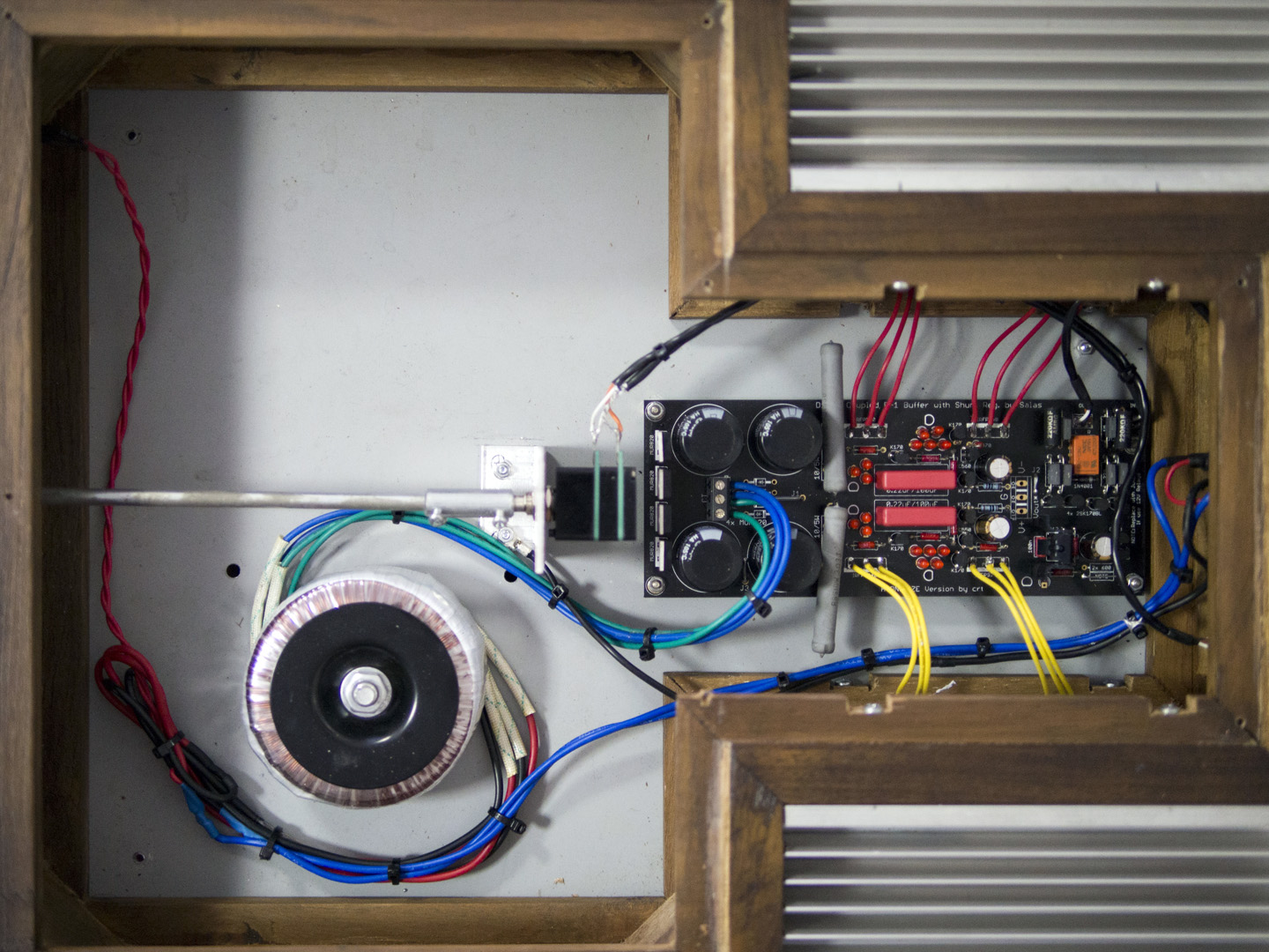

Hi Salas,
The voltage drop across 10R are 1.73V on one resistor and 1.93V for the other one. Is it normal to be this much of difference between the two?
Yes.
The mosFETs have a very wide production variability in the Vgs. You are also comparing -Vgs to +Vgs, that introduces another variable.
What you can do is calculate the current for the two CCS. Then adjust the 1.73V version by adding a parallel resistor to your fixed 10r, so that you increase the CCS current up to nearer the 1.93V version. This gets the output FETs passing similar currents and thus similar gm.
Except that the -ve regulator is very different from the +ve regulator and similar currents may not give similar performance.
Hi Salas,
Thanks. Yes its normal due to different VGS readings between MOSFET samples, especially between "complementary" types.
So if you will ever try boosting it to about double the now current to check how you will like it subjectively, use 4.3R on the 1.73V side, and 4.7R on the 1.93V side. Use 3W resistors mounted a few mm board proud to ventilate better.
