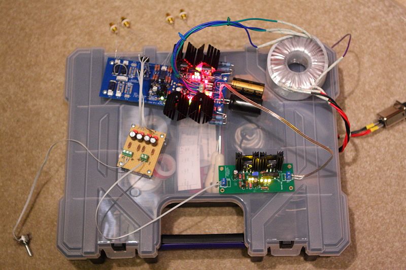

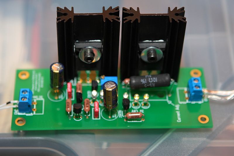

My DCB1 build

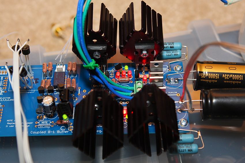

I just finished my DCB1 build and wanted to share what I've done so far. So far, I've only made a few measurements and run a square wave through it. Listening comes tonight - I can't wait!
I used a 100VA 15-0-15 Antek transformer (goal is to use bigger sinks and push bias to about 1A or so. The transformer provides about 15.8VAC which rectifies to about 20.4VDC. The rails for the DCB1 run at -9.83 and +10.23v.
With a 20R bias set resistors, I can measure 1.74v drop across +rail resistor and 1.71v drop across -rail. The resulting bias level is about 86mA and I get 0.3mV and 0.7mV offset at the output. The sinks closest to the PS caps show a 10c rise and the next ones show a 6c rise over ambient. The MUR820 diodes show no temp increase.
I changed the Rset resistor to 10R which doubles bias to ~160mA and the sinks now show 16c and 14c temp rise. The diodes are a bit warmer (but no where near the sink temps). Increasing the bias seems to increase the offset to 1.0mV and 1.1mV. The middle two JFETS in the matched quad measure the same at about 8.57mA. The outer pair measures about 8.56mA and 8.59mA (this is from memory - I have the numbers written down at home).
I had the same problem as HiFi Rookie with resistor leads being too thick, so I just laid them down across the pads and soldered them that way. I also left the "key" output resistors mounted higher above the board for easy swapping to some vishay nakeds when they arrive.

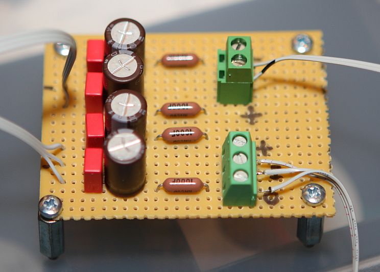

I used one of Salas' regulator boards provided by dvb-projekt to power the LDRs. I tapped the +rail cap for input to the regulator (20.4VDC) and adjusted it to a perfect 5.00VDC output. That first sink gets a bit warm at 51c (a 29c rise) - I was thinking of putting a resistor in series with the power supply to the regulator board to bring the supply voltage down a bit to reduce heat on the MOSFET.
Using George's control circuit for the LDRs (100k stereo log pot, 100R current limiters, and a 100uF cap followed by 0.47uF caps), the LDRs get a minimum voltage of 1.62V and a maximum of 2.18V. This allows the resistance of the LDRs to vary from 22R to about 6k7 ohms.
I'm looking forward to giving it a listen tonight!

From your text I gather that you fully understand what you are doing and what the circuit should be doing.
I would not recommend more than 200mA in a Mez unless you arrange for other sinks and do the "leg trick" though. Its "voiced" up to there max as it is standing.
The newer Hypno was adapted full hot-rod wise, but you could match it for 1A level if you will do as above. Look for the thread "Using the HYPNOTIZE as a general shunt reg PCB" to see the "leg trick". Congrats, nice W.I.P by the way.
