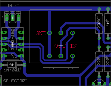

Volume pot connection
About the volume pot terminals on the PCB, can anyone confirm which holes are for input, ground, and output for each channel?

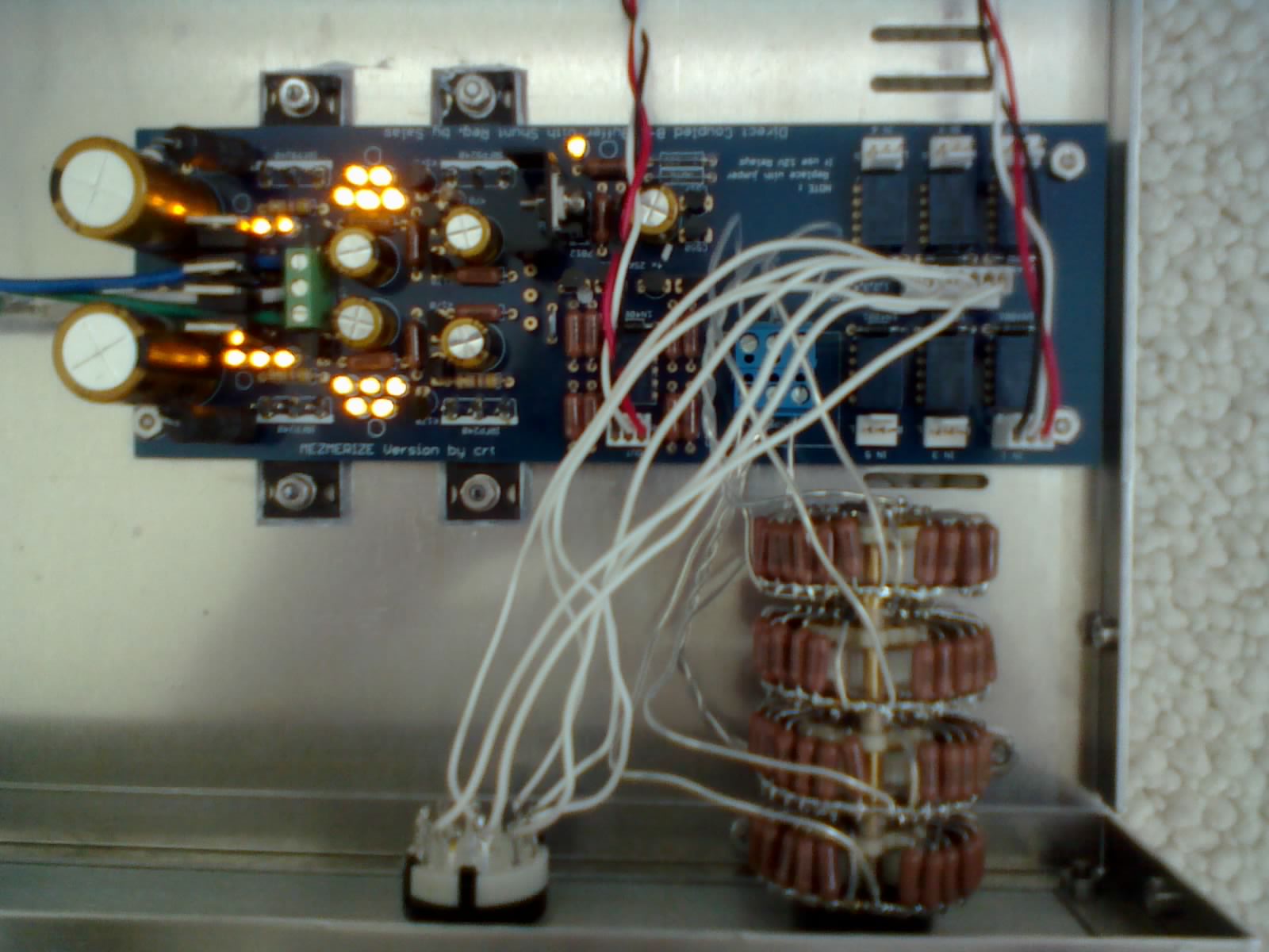

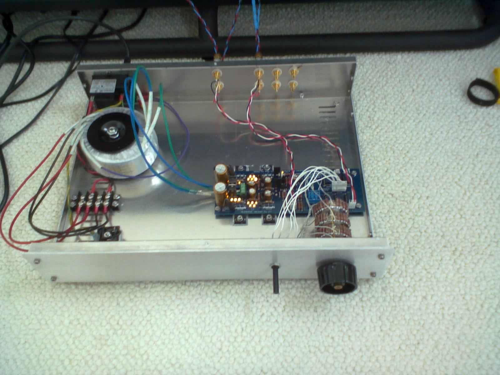

It's alive!
It came alive this morning - this is an "emergency" build, I will finish the details later (top cover, add inputs, wire dressing, tighten all the nuts/screws, etc) 😀
The 25K ladder pot works OK.
My build is hotrodded using 10R resistors in place of 68R - wondering if I can hotrod it some more by soldering another 10W in parallel to make it 5R?
The ground of the PCB is floating and isolated from the earth and chassis - any suggestions on what to do with the PCB ground? Is there any star ground hole on the PCB?

This project is relatively low-cost and low-effort compared with my other projects, but it sounds like ten thousand bucks. My Conrad Johnson PV10 and Adcom GFP750 will go into storage. The Mez sounds very transparent and detailed but neutral.
