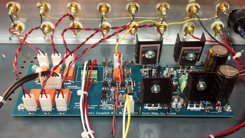

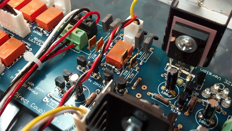

Pics of my Mez

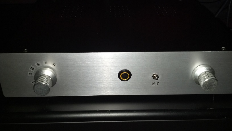

I used my old chassis which housed the B1 buffer. I added an HT switch so my kids could still play their games by just flipping the switch instead of messing around with source and volume.
I am done with my Mez, no more tweaking (I hope). btw going from 68r to 27r made a huge difference in soundstage, music is fuller. I am also hearing a little more in each track.
Now on to Salas' JFET RIAA.....
