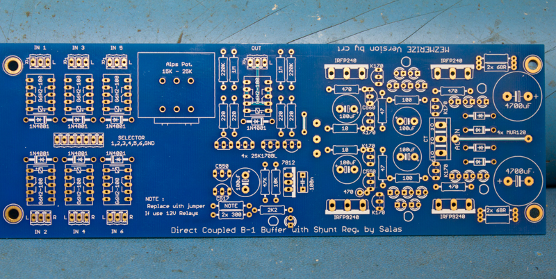

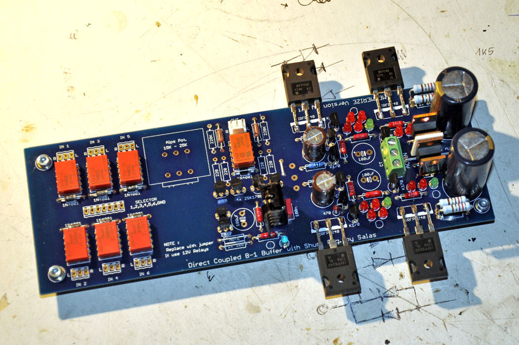

Having read a fair bit on the threads (including DCB1) I am planning to sort of hot rod my Mez a bit... current set resistors are two 12Ohm in // (for about 275mA?), diodes are HFA08TB60 (had them in my drawer), semis will be heatsinked to the bottom of the future case via two solid aluminum rods, and the input capacitance will have some hefty assistance by off board fellows.
There is still a few parts missing, and I've got two questions: I was planning to substitute the two first 'lytics in the regulators with film caps, but space is rather limited. So I could mount some decent film cap off board, or just use 'lytics also. How sensitive is this to sonics (subjectively 😉), and how critical is the value? I have 47uF 50V and 1000uF 25V (again both in the drawers)...
And then there is the 10R under one of the K170's on the board: I read in the other thread that this one has to be changed to 1R. Is this mandatory (because the 10R are already soldered in...? and I hate desoldering :snooty:
Use 100uF (47uF are also acceptable) on the first caps positions now void on your PCB. One thing that works nicely is 220nF COG + 0.33R SMD parts snubber directly on its leads at flip side. DON'T do that on the output lytic. Also 10R to 1R ain't mandatory. I have "voiced" the MEZ using different subtleties than in the HYPNO which is poised for the heavier running aspirations so you may experiment but don't draw directly from HYPNO users experiences word for word. 12//12 Ohm is as far as I would go minding the main electrolytics ability & the bridge diodes best ventilation mounting and temp for reliability. Which is already taken care of in yours by substituting with TO-220s as I see. Good luck then.

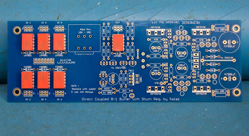

I hope you are right on this and before any question , want to thank you for this great design and all the help that you provide to people with little knowledge like me. Thanks in advance and I have some photos of the building process.

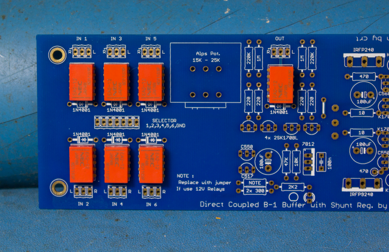

I want to be 100% sure that I understand this one correctly, every time that see a note on the board and if I using a 12v have to use a jumper, that means 2 jumpers in place here ?. see photo
One jumper is enough, two are maybe more aesthetically complete. (NOTE & 2X300). A fancy colored heat-shrink adds the cherry. Maybe in orange to compliment the NEC relays or in another like the LEDS of choice. 🙂
