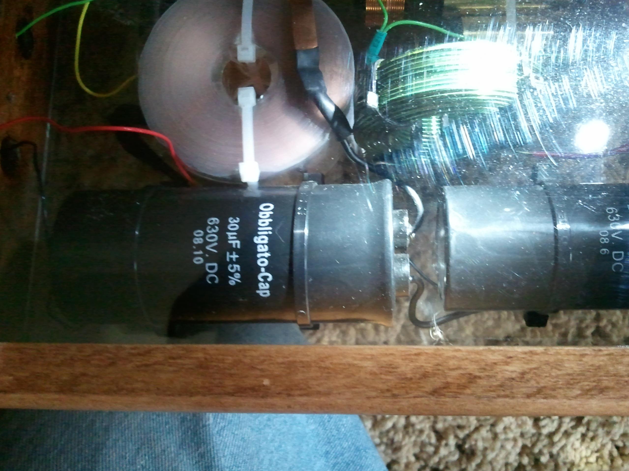

It is a radial type of can, both flying leads on the same side (end), not the axial type of cap?but an Obbligato MKP oiler, the one in black can with flying leads should be economical and effective since you need some uF.
About the potentiometer-mutistep switch: what DIY-selfers use the most as a good aesthetitac approach and most nice rotation feeling, is it a Alps type 20kOhm potentiometer or DACT, GOLDPOINT Stepped Attenuator?
That capacitor model is as you described.
Alps is smooth rotating with good log taper (volume rises intuitively louder as you turn it up). Its not harsh but not that transparent or focused. For better results you would need to spend on a good stepped attenuator. There are cheap SMD resistor stepped ones on ebay for around $20 also. They sound good but their long term reliability has been questioned some times.
Those on your picture are the "Obbligato MKP oiler" as you recoomened as DC blocking caps, and would be even beter than axial Gold series?
The pot or switch should be linear or Log. I tought Log is what should be used for volume regulator, but others are using linear.
Hes not suggesting its better, hes suggesting its decent and inexpensive.
Log raises volume slow and then faster. Linear is fast at low volume. Log is best. Linear might be okay with a really low gain amp.
Log. Linear will open up the volume weirdly fast for the human ear loudness perception curve. The Obbligato MKP oil are excellent value for money and they come in big uF. Plus they are not harsh. Can be mounted sturdily with a bracket. There are step ups from there, including their own gold line claimed to be better which is still fairly well priced. There are many much more expensive choices of course. Read around, ask members. We use the DCB1 as DC coupled by majority.
