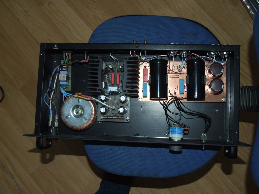

Bnorrish, here's how I built my Mesmerize. I used shielded wire for the 4 signal leads in and out of the pot and am very pleased with the sound.

Thanks. I hooked up my Pearl 2 last night. Shame to have a Yamaha HT receiver with pre-amp outs between Pearl 2 and F5!
Now you have one more thing to look forward to! Does your receiver have a pure analog mode? That's how I ran my Denon for years and the sound wasn't bad.

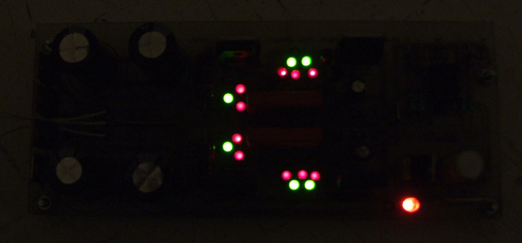

Just try a few different coloured LEDs to get the voltage right.
Mine uses a mixture of RED and GREEN.
After this photo was taken I separated the Salas Reg from the B1 and used it with a Pass B1 PCB (copy).

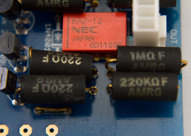

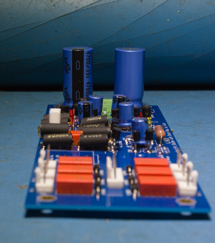

What about those AMRG resistors? Are they any good in use? I see them pop out here and there in last years. Are they to appeal where RIKEN was appealing or something? They look heavily built nonetheless.
Funny... Just yesterday I soldered in the same resistors in my built...😛What about those AMRG resistors?
Put them in upright though...
I have no idea how they will do but will find out soon.
I used some in a valve preamp build and to my ears they sound really good.Solidly made inside an alluminium sleeve.

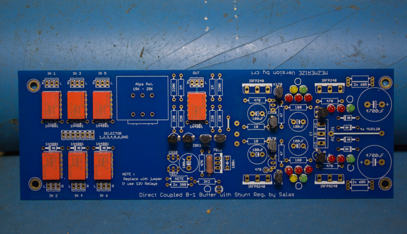

Mosfets... matched pairs?
I have a question about the mosfets (2x IRFP240 and 2x IRFP9240). Do they need to be matched pairs or is that not important in this part of the circuit?
