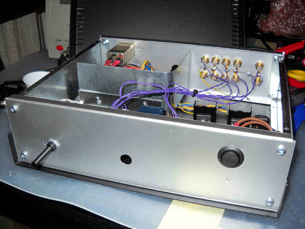

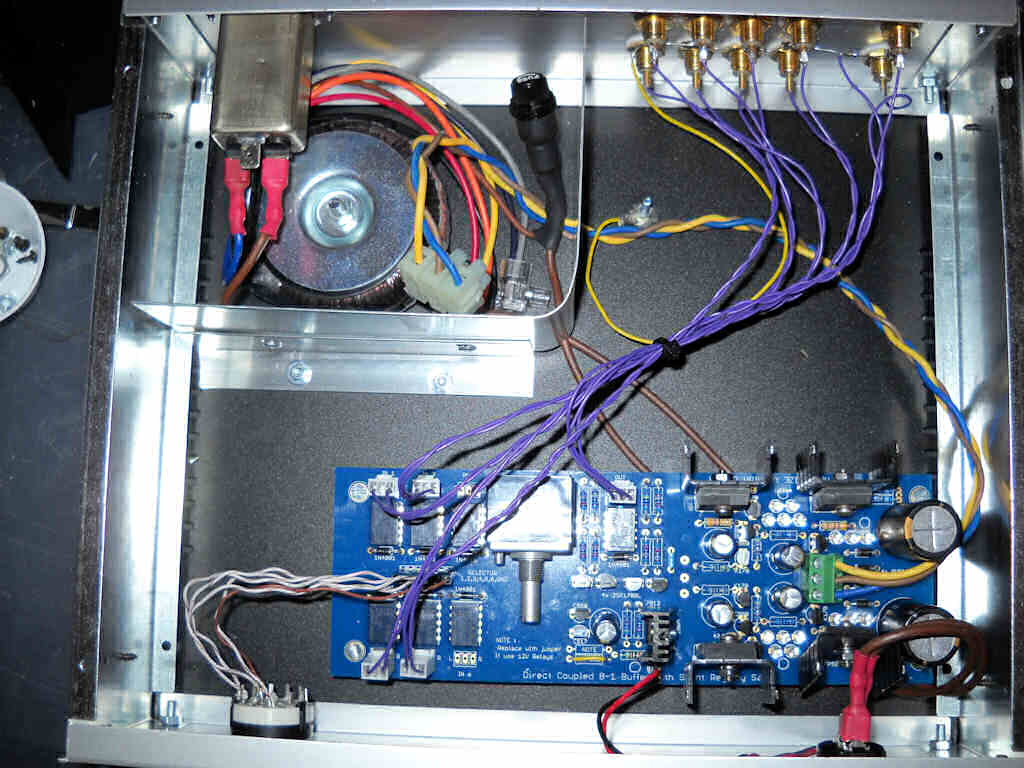

Some pictures
still something to mount...
x Salas & Andrew:
Do you think i can hot rod this , just to add little more gain?
and how?

Only if you had mounted the mosfets to the floor *see ramallo's a few pages back. Then you could use 10R 5W or 22R//22R 2W where your 68R//68R are now and achieve around 200mA CCS with your Vdrops. With the little sinks you got its dangerous. Hot rod achieves more robust sonics from the regs, not voltage gain by the way.

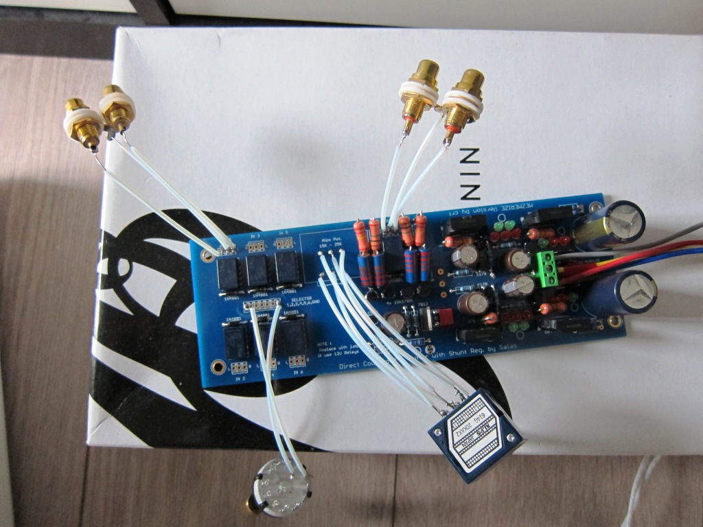

I've just hooked it up to an amp (My_ref revC) and there's a big buzz coming from my speakers at full volume. This is when I turn on my amp, without even turning on the mesmerize itself. This seems weird to me and I can't discover anything wrong. Could it be that it has something to do with my amp?
I've included a picture of the mesmerize in my test setup.
Erik

the Mezmerize (and the Hypnotize) disconnect the output when turned off.
This leaves the cable acting as a high impedance aerial connected to the receiver and that is very susceptible to interference.
There is an easy fix that cuts much of the interference. It is already incorporated in the Blue Hyp.

The T-Mod is incorporated into the Turn on relay on blue mez, the new run of blue hypno's will have it incorporated into it.

Does the amp buzz even with nothing connected to its input? Do that check. The Blue Mez shorts its output to ground when off.

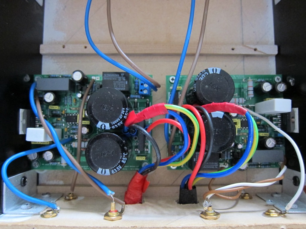

Yes it does, although only slightly. I've included a picture of the inside of the amp. There is no capacitor connected to the input, like suggested in the My_ref revC ultimate BOM. Could this be part of the problem?
Thanks for hour help!
Erik

It can be a ground loop being formed, or it has some sensitivity to DC coupling. Does it buzz if you just short its input to ground with a crocodile clip right at its RCA, is its chassis grounded to mains earth?
