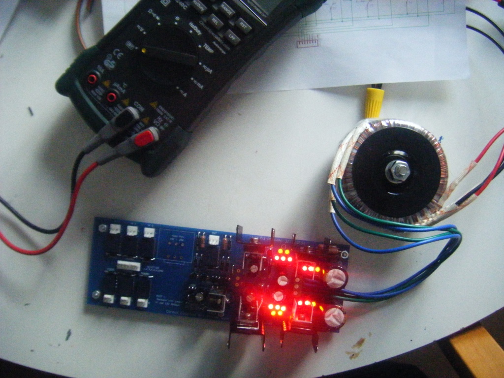

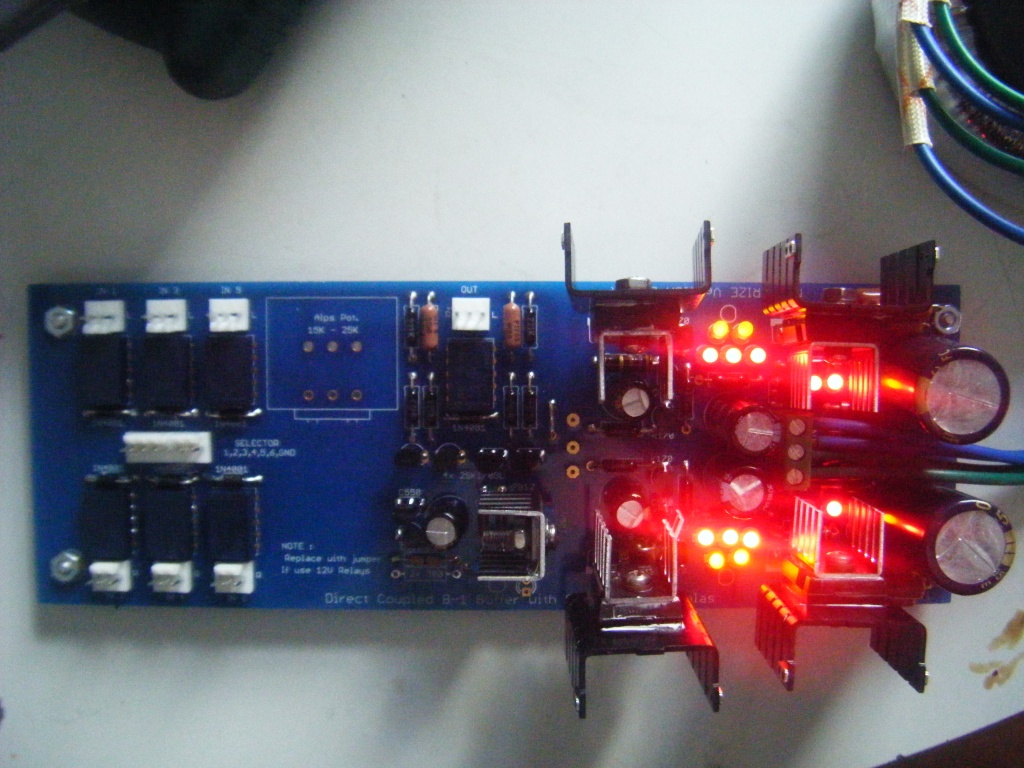

I finally finished my Mezmerize board and powered it up. Everything seems to check out OK. Power supply voltages are +10.03V and -9.57V, output offset voltages are -1.1mV and +0.3mV.
For current-setting resistors I used 3x61R9 0.5W on each side (Vishay RN65, selected for low temperature coefficient), so 20R63 effective resistance. I measured voltage drop across the resistor clusters of 1.640V and 1.716V, so current through them is 79.5/83.2 mA if my arithmetic is right.
For the LED's I used a mix of reds and yellows; the reds are supposed to have a Vf of 1.7V, the yellows 1.8V. When I measured them I found the reds were in the range 1.741-1.751, the yellows 1.950-1.963. I have not measured them in the actual circuit yet, but am curious how well the voltage refs match.
Here are some pics. You can see that I was goofing around with heat sinks a bit -- I had some TO220 heat sinks lying around so added them on the front of the MOSFETS, which looks ridiculous and probably accomplishes nothing. However, after about 20 minutes the heat sinks and the transistor cases all measured about 25C, so everything is nice and cool.
Now I need to order a case and a few other bits -- guess who forgot to order phono jacks? So I can't listen to it yet!

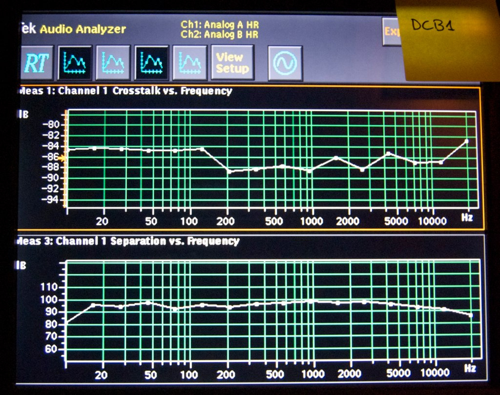

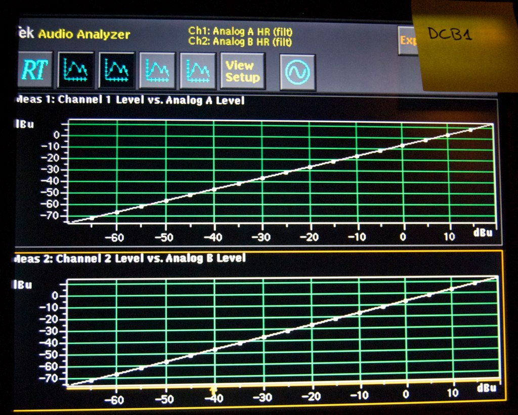

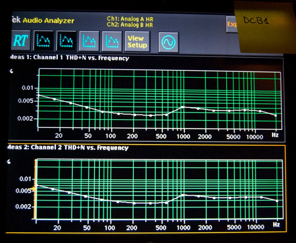

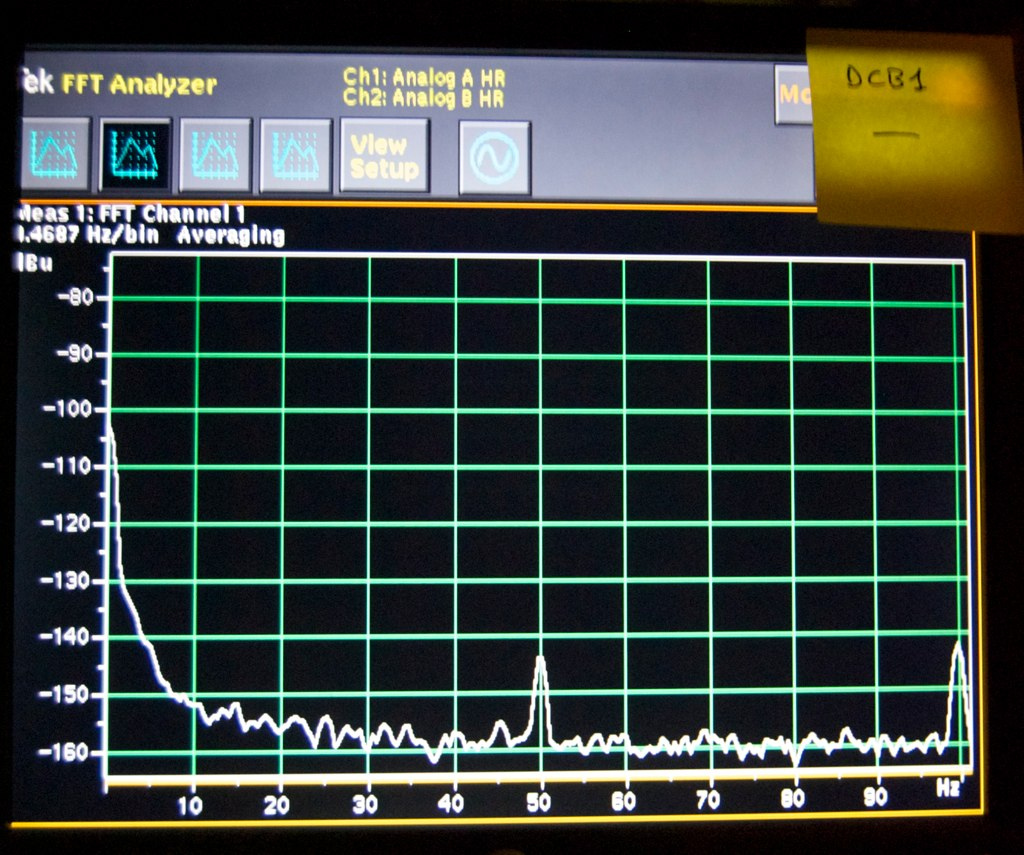

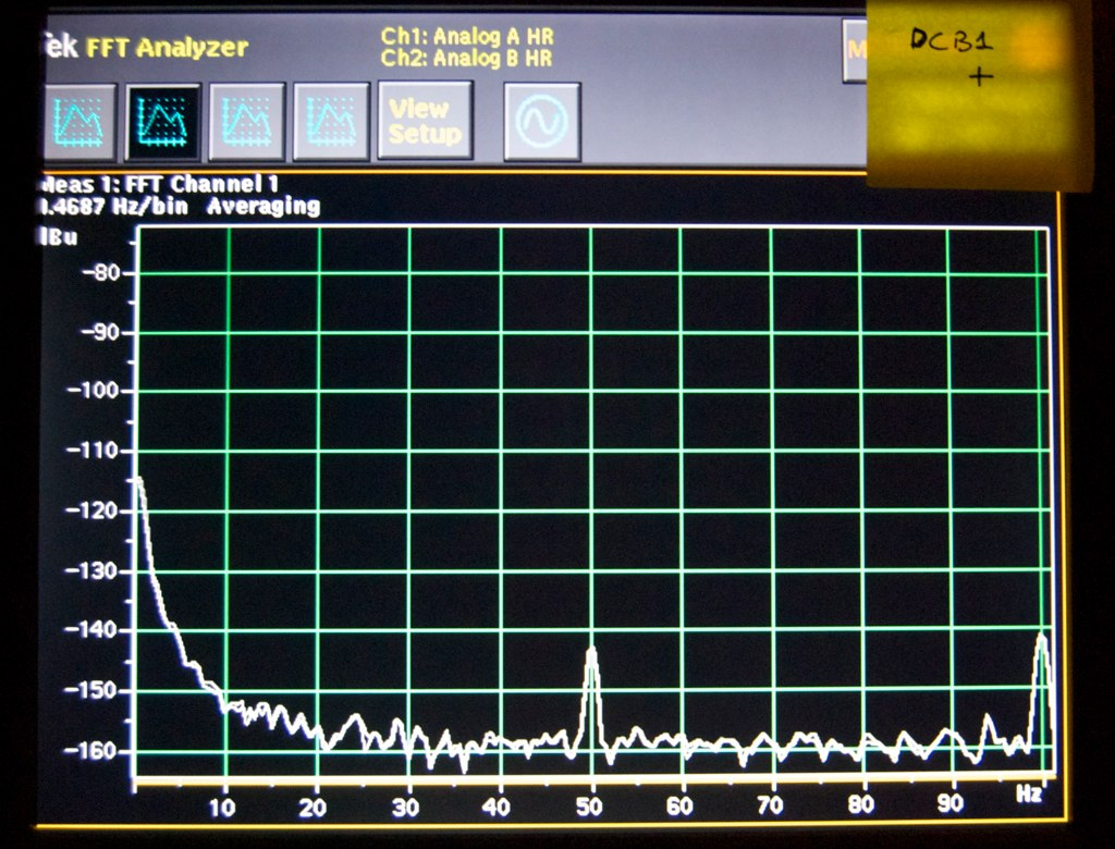

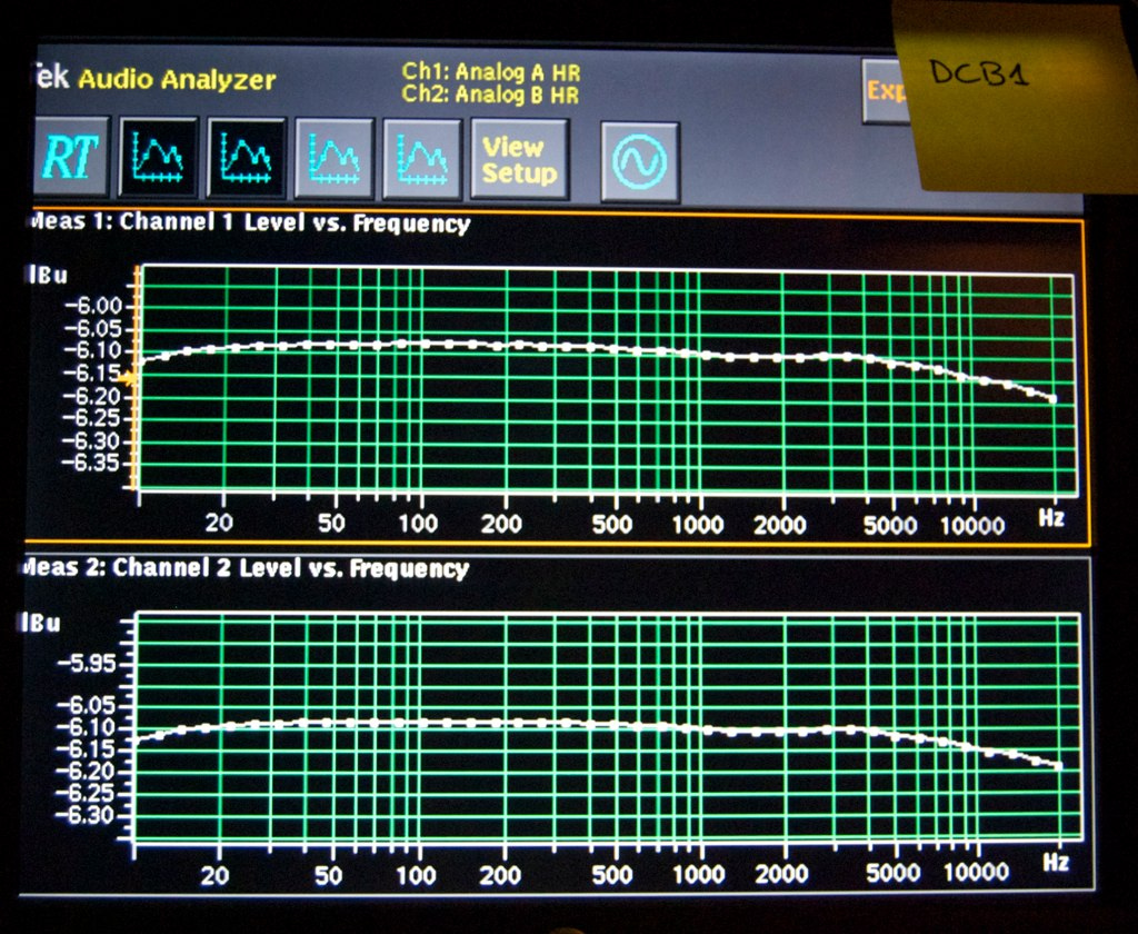

Hi guys, thanks to ramallo we got a nice set of measurements for the Mezmerize you make here. They are taken on a Tektronix AM700 audio analyzer. I don't know more about measurement conditions, levels, etc. I just got them as shots. His Mez build measured. Thank you Suso. Great stuff.:up:

That's the fully constructed Mez thing passing signal through its layout and relays and Alps pot. Not some direct proto test board. Don't know the signal levels used or more details. For one thing the noise floor and hum levels on its PSUs is fine.:magnify:
Good. Because its unlikely someone will use a 600 Ohm amp here. Was the volume pot fully open?
Yes, fully open.
I choose 200k because I'm using an F5 and is near (half).
If you want a specific test, let me know, I'll try to do.
Regards
Edit 🙂: I have plans for do a dual DCB1 Hodrod on the same chassis (one for channel) (all symmetric) for control the studio monitoring. I'm very very impressed with the 200mA DCB1 sound. But in the new one I'll try to go to 500mA by using a power amp chassis (2 or 3 unit)
