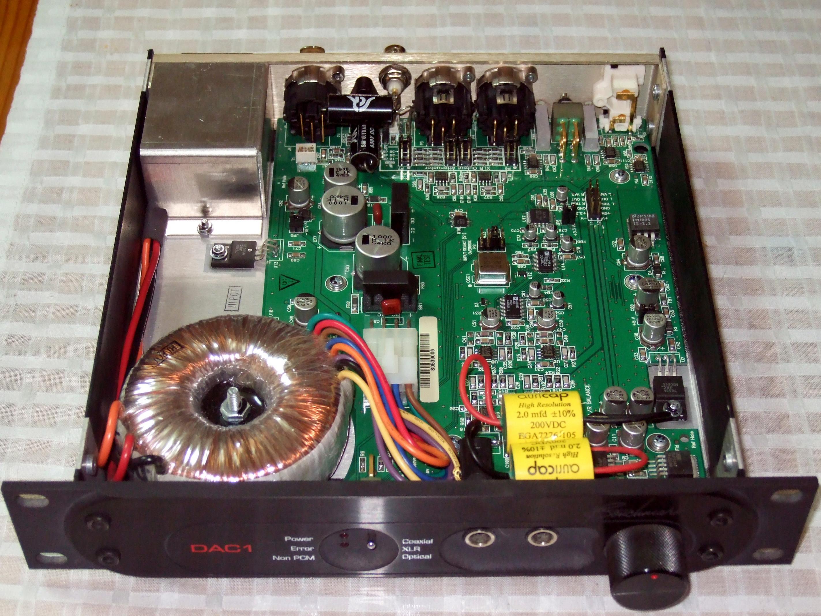

There was a range of opinions about Lavry VS Benchmark among studio people. Did you ever compare? The Benchmark revealed quite a chunk of extra performance after I substituted its only internal signal coupling electrolytic cap for Auricap. Highly recommended if any of your studio friends has a DAC1 as they are ubiquitous in pro circles.

My Benchmark DAC1 is very old (Rev B), the new Benchmark DAC1 have some changes (to good), they changed the output OP's from NE5532 to LME49720, they changed the electrolytic capacitor at I/V output to a film/electrolytic combination (in parallel). The variable circuit is better (The variable out of the original DAC1 isn't as good as the fixed). Between the old and the new DAC1 unit you can have noticeable differences in sound (Much better the new units).
But I prefer the Lavry DA10 sound than the DAC1 (old version), with the new DAC1 is difficult to say.
I changed the coupling electrolytic capacitor by a Mundorf ZN with better results, but the great thing is change the OP amps (But need change the feedback loop of the OP amp because the LME49720 is faster).
