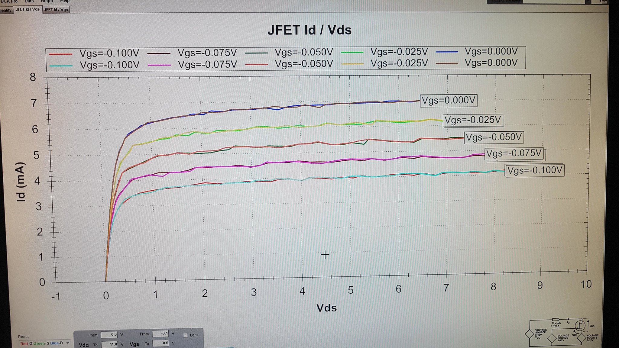

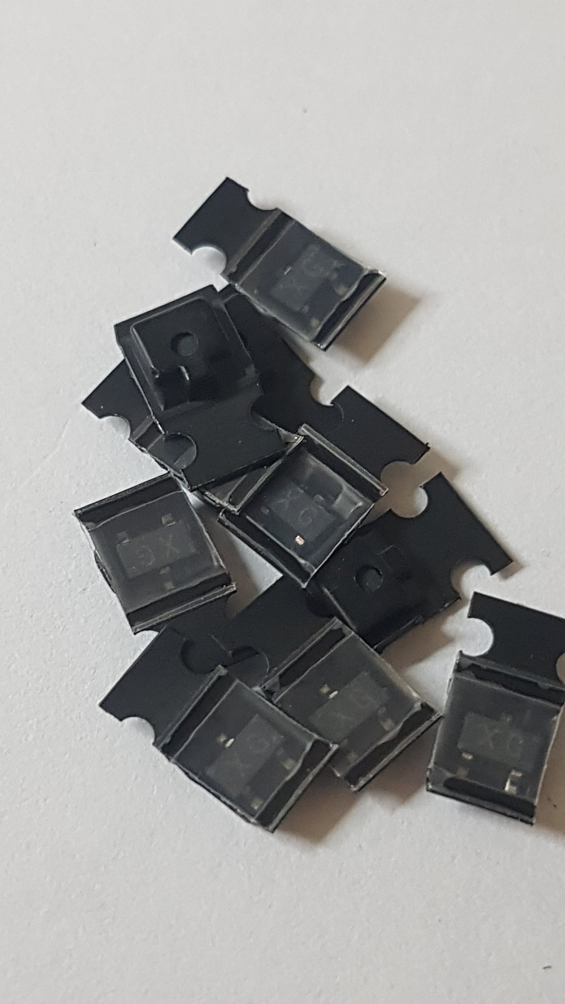

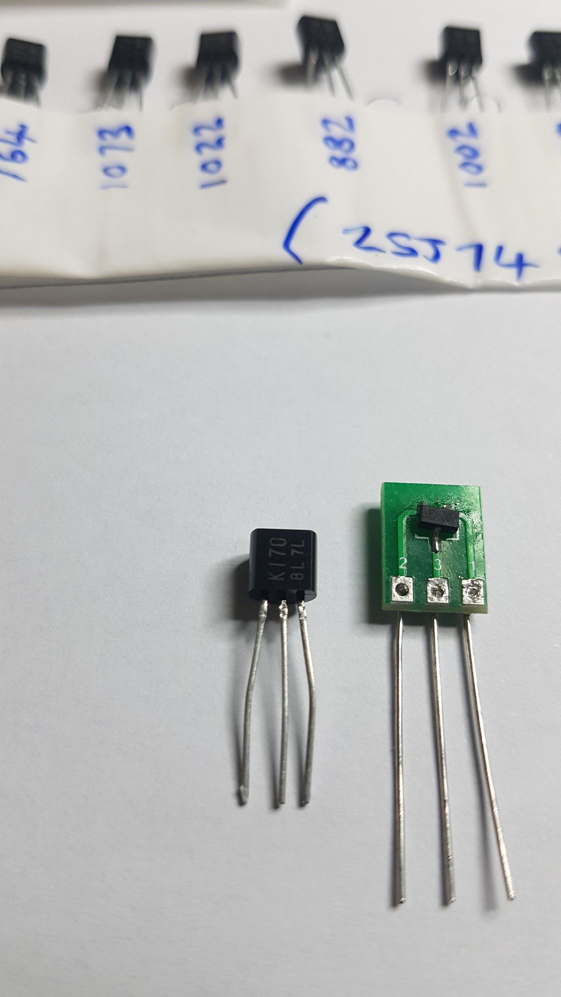

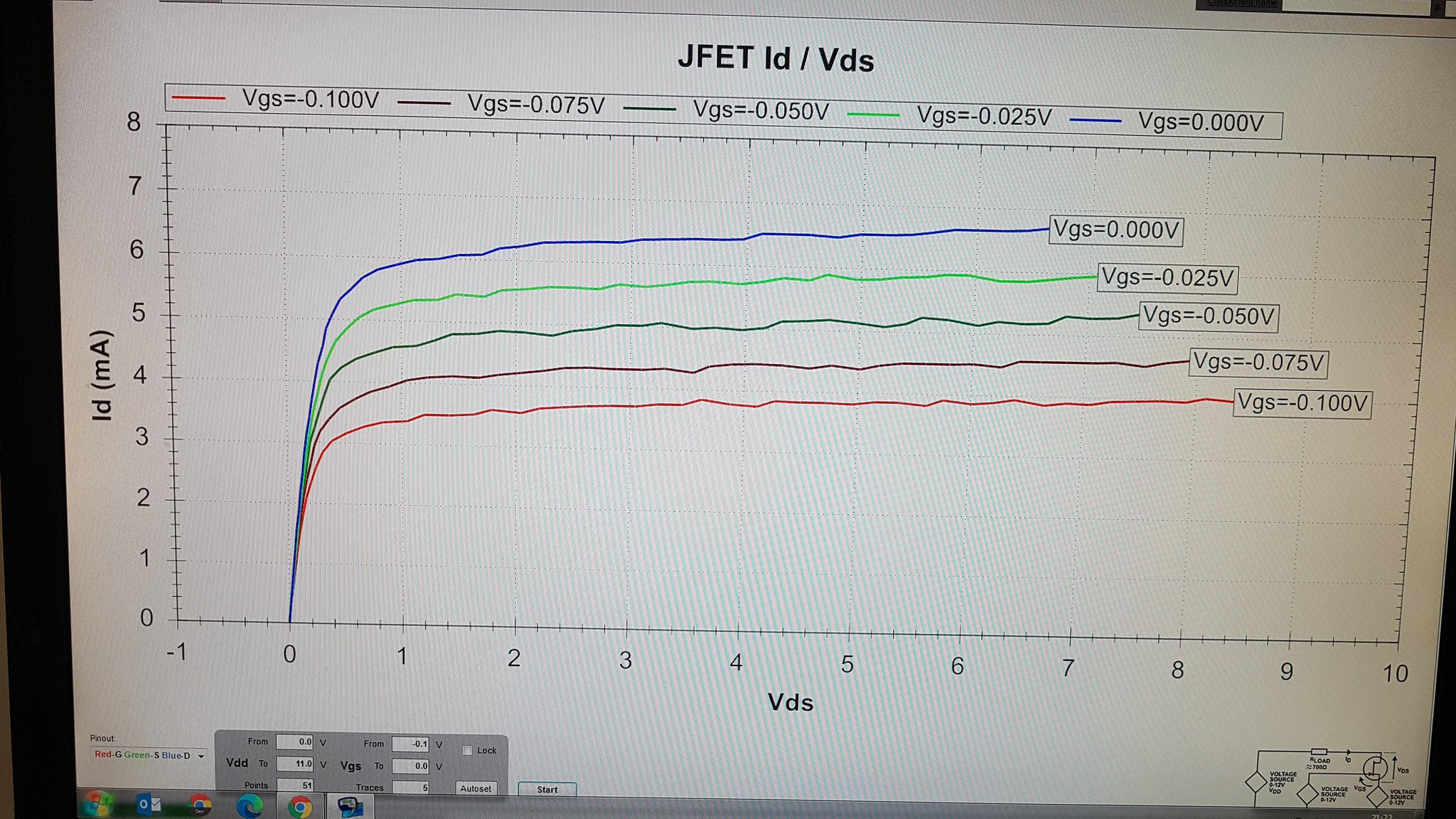

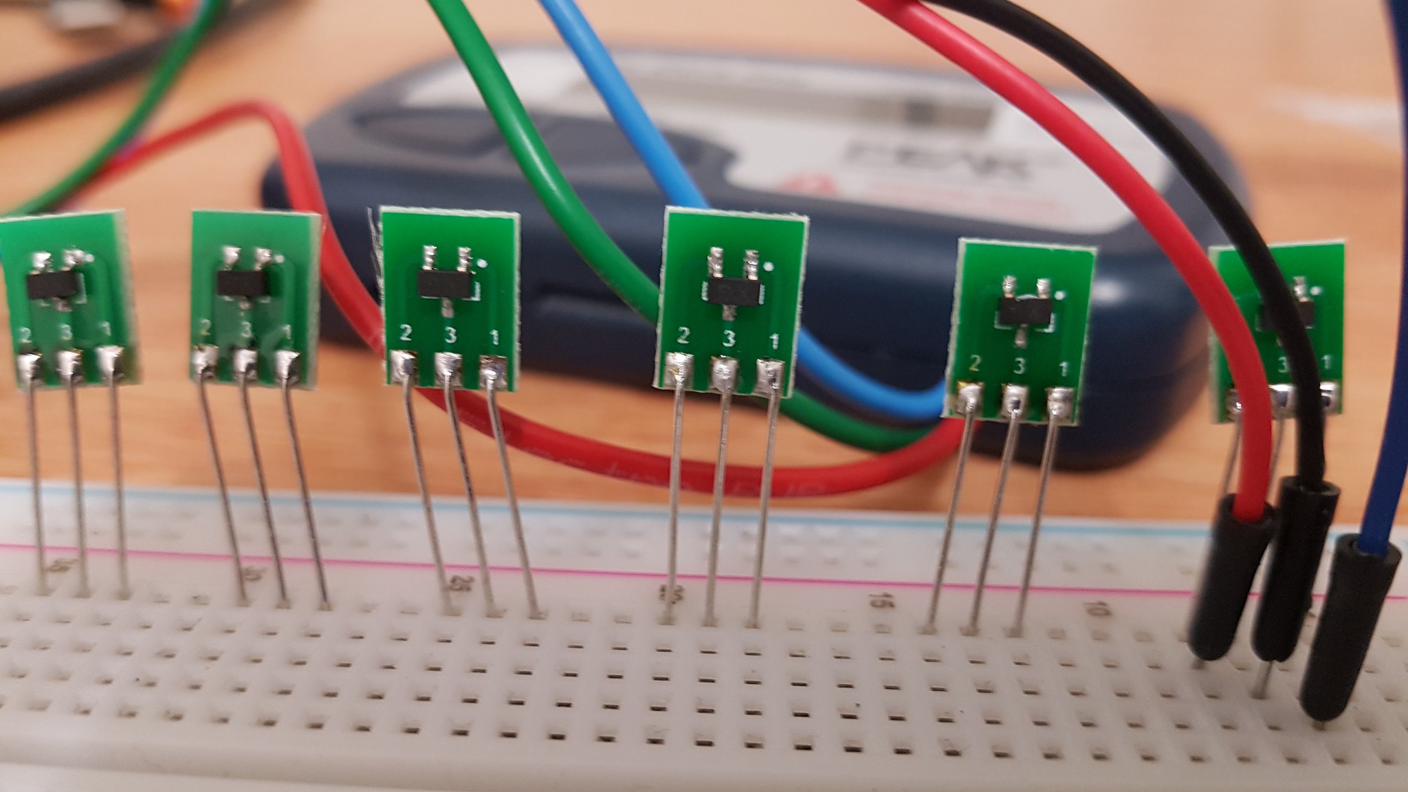

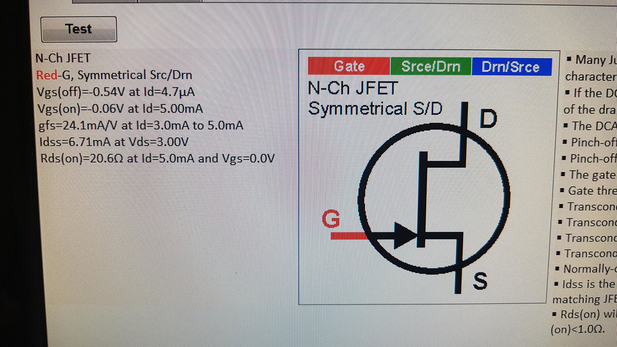

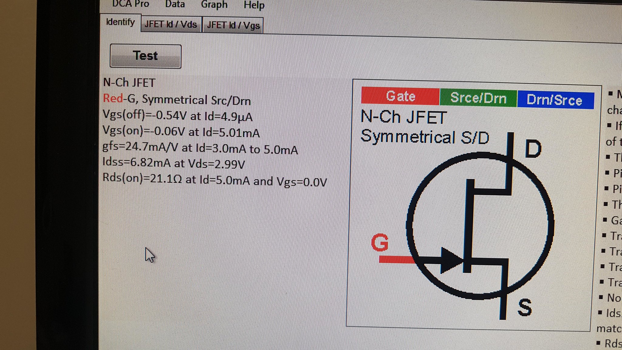

just got hold of a few 2sk209gr
the trace is fets 1,2,3,4
fet 10 is 2x2sk209 back to back
the back to back ones are they any good for the 4 matched ?
has the 2sk209gr got a complimentary fet like the 2sj74 is for the 2sk170 ?
