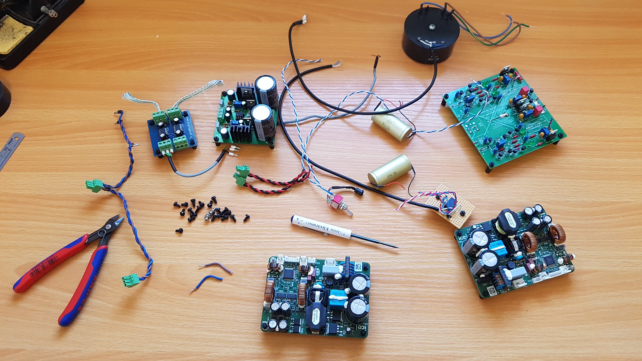

just need to rip my stunt chassis apart to put it into which has 2x class D B&O modules and a unity gain b4 buffer alps Black Beauty pot .

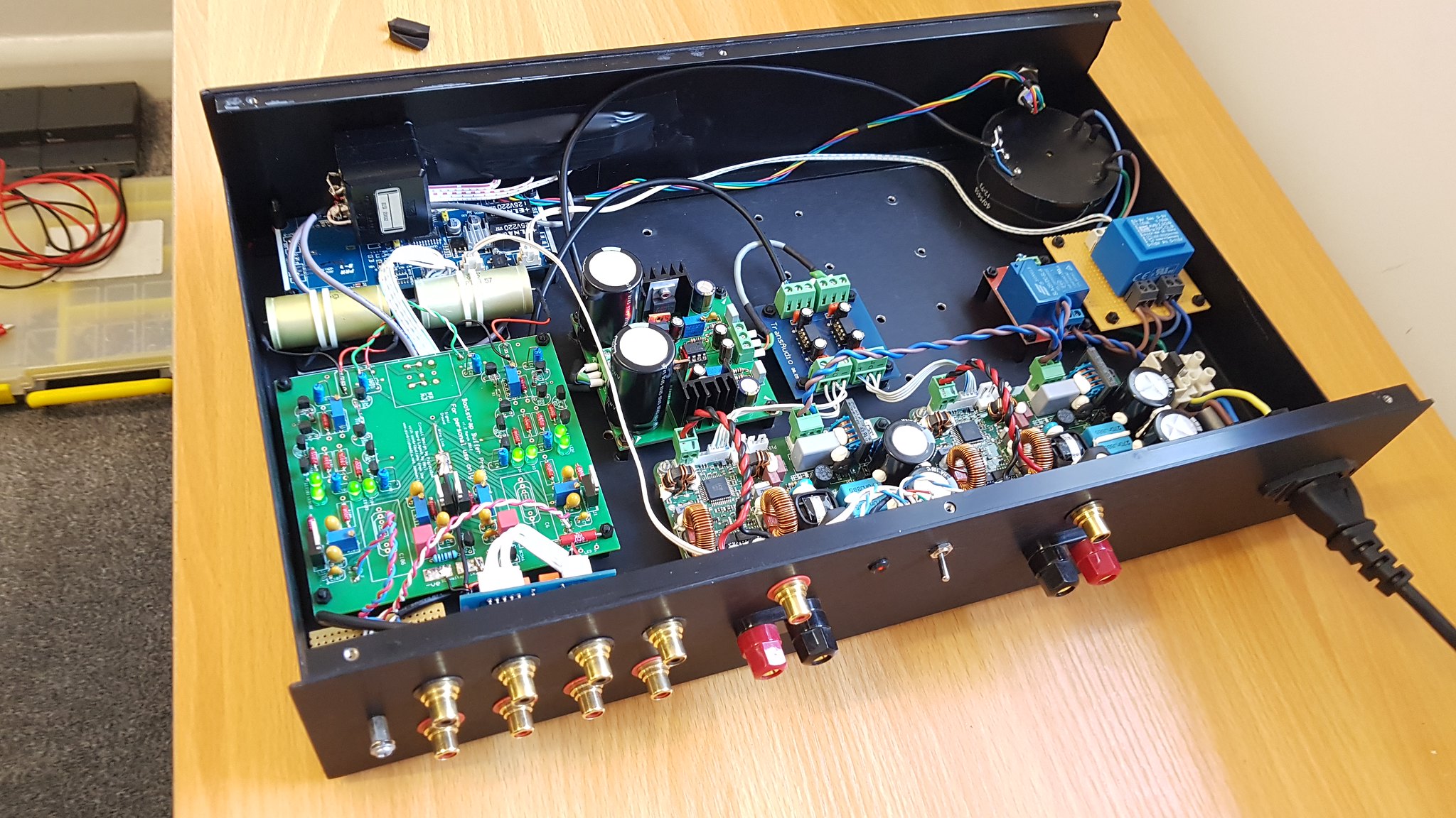

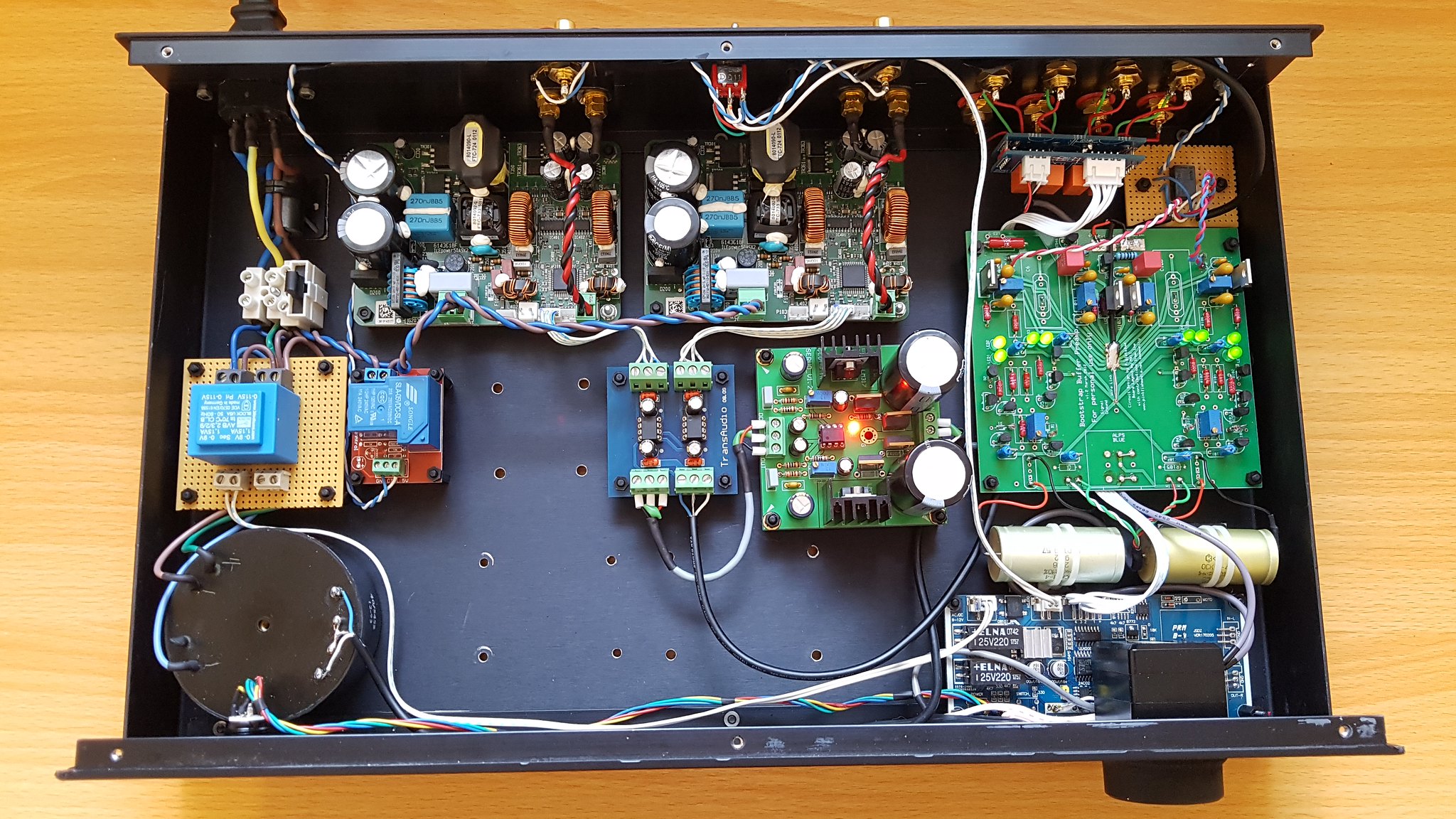

I'm mostly listening to music from a Allo-Katana-based Roon streamer (which will go in here, together with new UltraBiB and L-Adapter power -- am waiting for the PCBs), and a Bugle-2/Linn LP12/Lyra Helikon SL.
BTW, the Mez housing in the picture is from an old tube-based DAC, the Mal Valve DAconverter, ca 1995.
This will now drive my Elekit TU8600 (of which glimpses are visible in the picture) and Zu Audio Omen DW.
All this electronic is quite new, and is replacing a big Gryphon Tabu integrated amp, the power amp of which had broken many years back. Back then I could not find a way to get it repaired and didn't think I had the skills (should have tried harder, I now know). Anyway, I had replaced its broken output stage with Hypex nc400 class-D units, while using the still-working Gryphon pre amp. It had a very nice phono stage, which I managed to fry a couple of months ago in an ill-advised experiment...
The Bugle-2 was meant to go in front of the Hypex nc400s, which found a new home in a Musical Fidelity A100X housing (cute!) -- which my wife took over for the family room. She loves it driving our "old" Dynaudio Crafft Monitor speakers (it has an Allo BOSS for Roon streaming).
I'll post a picture tour of all this at some point...
The next projects are to replace the Bugle-2 with a Paradise phone stage (I got the boards, but am wondering how to source all the components, some of which seem hard to get), and to build a Pass Lab F6 amp into the Gryphon housing (got the boards, the transformers, and the JFETs). I'm looking forward to alternate between the sweet, sweet sounds of the Elekit B300 SETs and Nelson's FETs.
I found out about DIY audio embarrassingly late in my music listening journey, there is lots to discover and "catch-up" on -- it's very exciting!

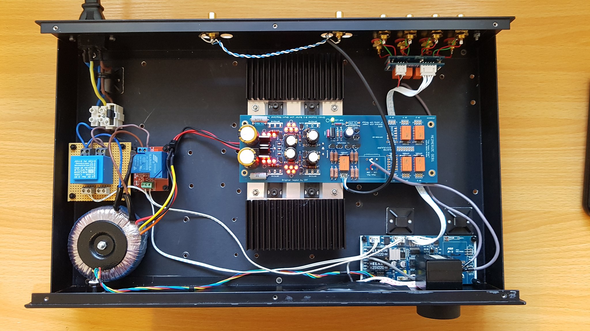

Hi friends
I'm working on the B1 in the little spare time I have these days.
I plan to enjoy it as much as possible and then make some adjustments (trying various resistors, hotrod to 200 (if I haven't already 🙂 ) and not least work out the knobs. (I ditched the Idea of adding a balance. I'll eventually swap the stereo pot and use two mono-pots...
Because I didn't spend attention to the size of the parts/construction, to be sure it all fits I got myself a U3 280 x 280 chassis from modushop. Huge beast that is... so there's plenty of space, which I could use for additional stuff, like
- a nifty on/off relay according to this thread 😎 : Power-switch & Volume-control in one?
I'm not sure wether I should insert a DAC and Phono-Pre. And if so, which... they should be an adequate partner for the B1 (thus, they must be good). (On the other hand, I don't think Sala's simplistic RIAA would fit into the box)
What gear would you guys recommend?

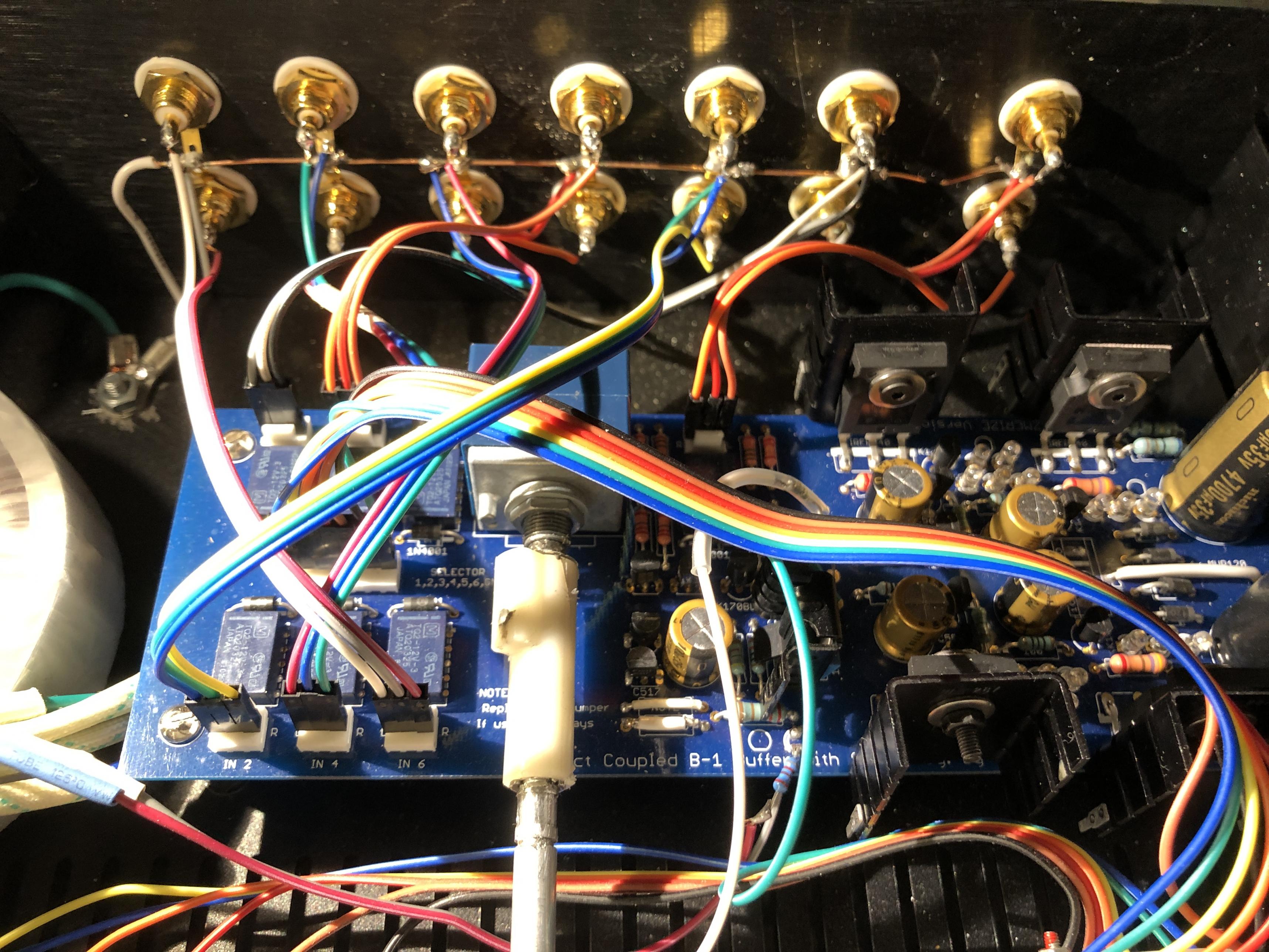

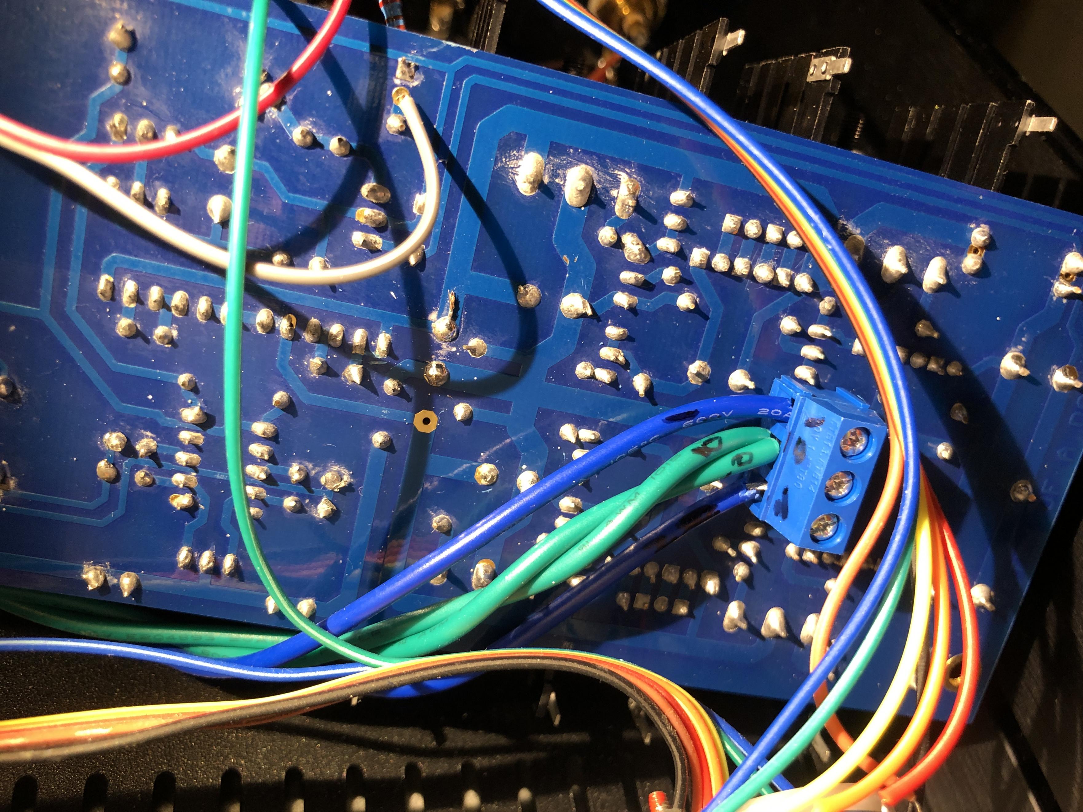

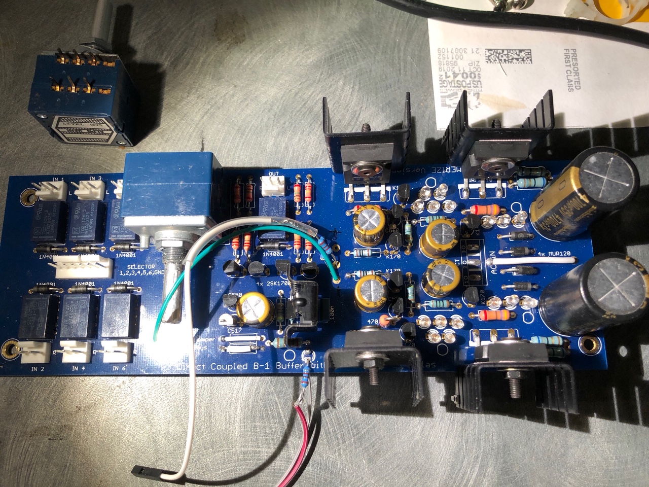

I built the preamp a while back and when I hooked it up I can only hear one channel playing. I immediately suspected the Alps pot because I didn't test it before soldering it in. Upon disassembly of the board from the chassis and checking the pot - it was working fine so it's not the culprit! All the LEDs are lit so I assume they are okay. Forgive my newbie approach to troubleshooting - I'm a newbie. So now I'm lost. Can anybody direct me what or where to start investigating? Help please? I may be able to upload some photos here....

Check the small black & white signal connectors first. Trace their continuity with the DMM between RCAs and input/output pads. Next contact problem suspicion could be looking all over for cold joints and retouching them with the iron.
To check the whole route including semiconductors and relay you could hook up a sinewave generator on the silent channel's input (even a PC or a mobile phone with a gen app will do. Set 300Hz 1V RMS) and trace the signal path with the DMM on ACV mode all the way to the RCA output. Red probe on path points black on ground. See where it stops reading. If signal goes in to a connection or into a part and it does not come out, there should be the problem.
Thanks for the advice. I will do that and hopefully I can zero it down. Again, thanks!
Good luck and let us know. Stay safe.
