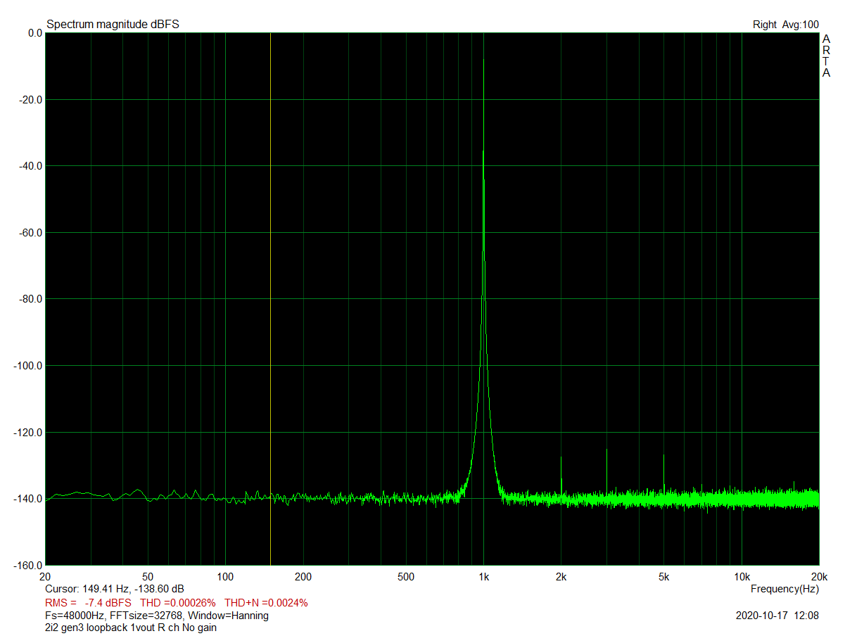

Do you have any means of FFT to compare Doubled up 2SK209GR DCB1 THD with a 2SK170BL DCB1 THD spectrum?
I also have the 20MHz version of your scope. HM204-2. Good models those. An adequate soundcard like Focusrite Scarlett 2i2 and free software like ARTA, REW etc. would allow small signal FFT and other interesting charts. Maybe something to pursue at a point. You will like it.
I have owned the Focusrite 2i2 gen 2 for a couple of years and really liked it. To me the absolute THD value is not as important as it is for matching channels which I now find indispensable. I have replaced it with a gen3 and the THD levels are substantially better. Here is a pic of a loopback test:
What are the 3rd gen's maximum RMS input/output voltage specs? Are you happy with the stability of its Windows drivers or using Asio4all?
Sorry, I dont know the RMS specs. I am using the Asio drivers with an old windows7 computer. Here are the details from the Focusrite site and also below a comparison between the gen3 and gen2:
