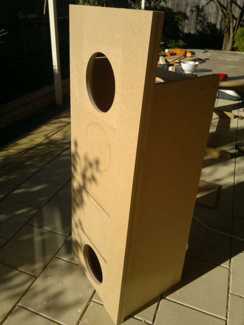

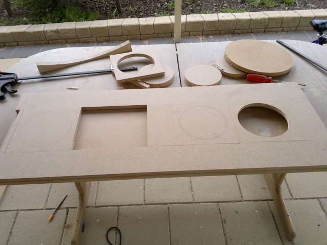

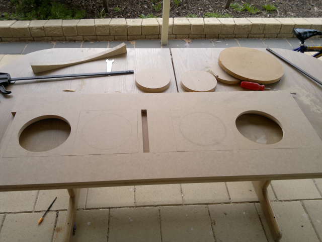

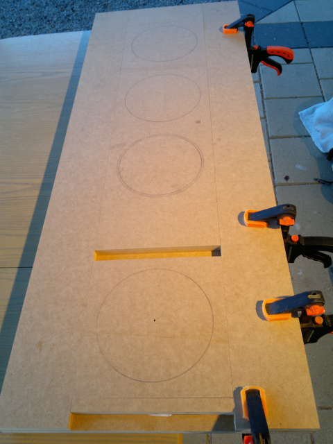

Here is the open baffle test chassis. I can locate the driver anywhere up and down the baffle, and cover up the holes that I am not using. I will use cardboard initially to add wings or increase the height of the baffle. Probably add piano hinges later and use wood for the wings. Anyway just getting warmed up. :devilr:
