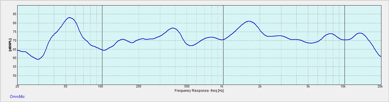

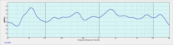

I love how the frequency response is smoother on the PHY OB. Even with wings at 60 degrees it is quite nice
Go back and compare it to the lumpy response of the other baffle (woofer on top).
I could upload it again
Post 39 ……………………………. the graph of the big open baffle.
It works out according to my numbers.

Take 1129 / [43.62” / 12”] = 310hz (there should be a dip there, driver is 180 degrees out of phase).
Now divide the dip in 2 (driver front and back only 90 degrees out of phase, thusly adding) making the Feq hump @ 155hz.
Just like the graph, only I see a +3db hump instead of 6db, but I do see a definite knee there at 150hz.
If the wings were 24” deep (71cm), that should get you a hump around 130hz, then against a wall would go even deeper (like you've shown).
Using the an15, you lose the 3.85” of driver edge to wing, but if the wings were 71cm long (24”) it hump and roll around 140hz.

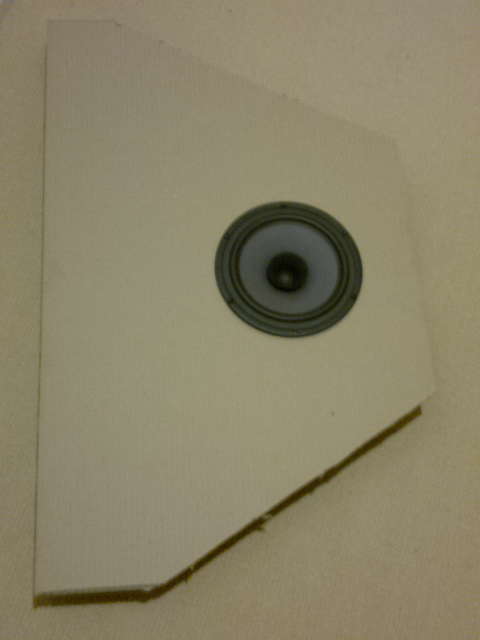

OK. Guess what I am going to do with this?
