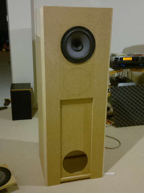

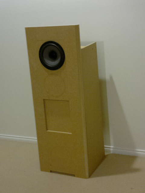

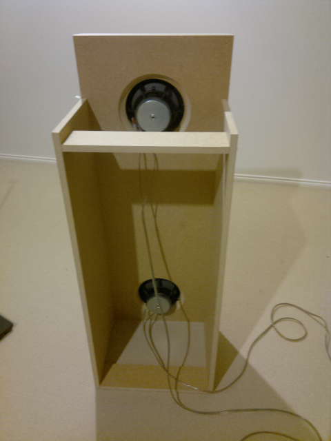

Melon Head: Your wood-working ability is highly impressive.Here is the open baffle test chassis. I can locate the driver anywhere up and down the baffle, and cover up the holes that I am not using. I will use cardboard initially to add wings or increase the height of the baffle. Probably add piano hinges later and use wood for the wings. Anyway just getting warmed up.![]()

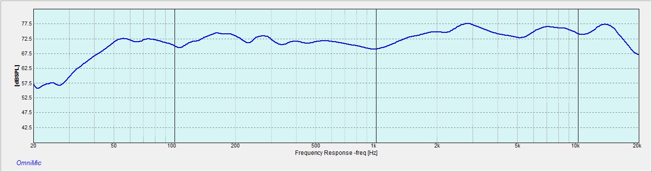

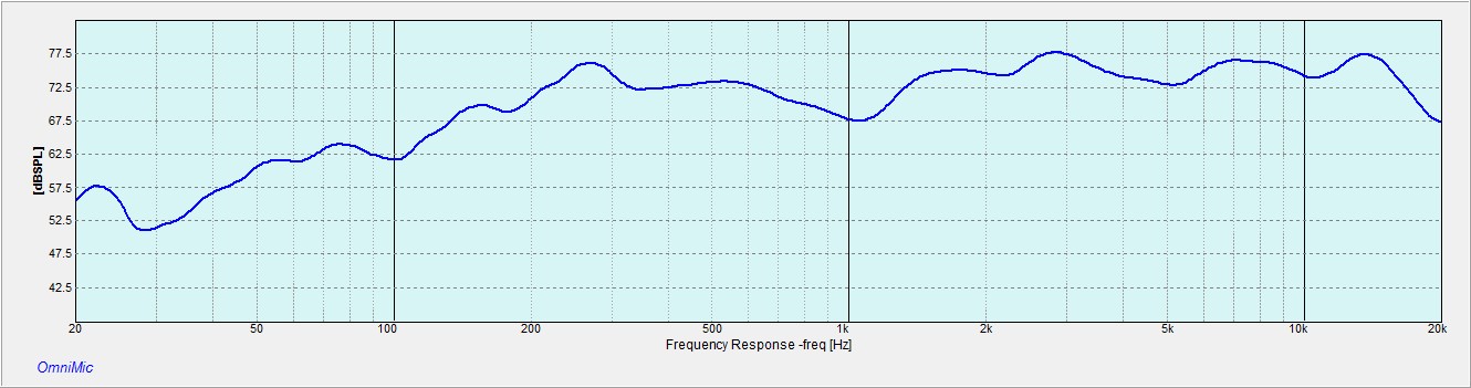

Frequency response.
Ported Open Baffle. LOL

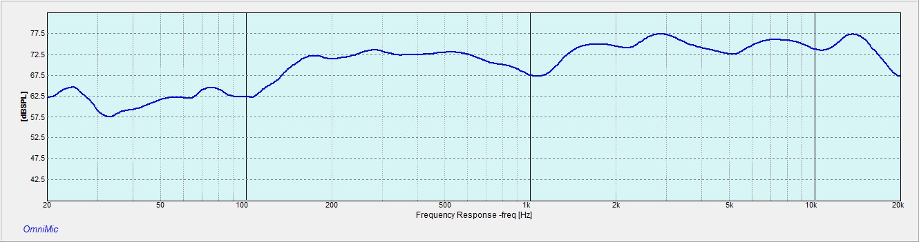

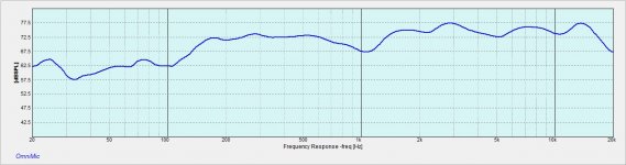

Just out of curiosity, I thought I should measure it with the bottom cut out exposed.
Doing so extends the bass response another 100Hz before it starts to drop off
EDIT: Later I might see what happens if intentionaly put in a port tube

I don't get the pictures.
Can you show it from behind ?

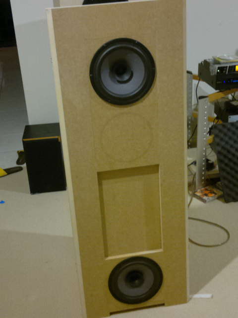

Is the top driver open baffle and the bottom driver sealed or ported ?
Have you seen the Tekton Design 4.5ob or the 6.5ob ?

Why not just do U baffle for the woofer amd OB for the FR. Same thing without the interference cause to FR. I bet imaging and soundstage would improve.
Mellon Head,
I don't want to rain on the parade, but the best way to make this OB work is to get some 12 cheap 8" bass drivers 😀. Then, you could leave that Seas on top, and build a Slot-loaded bass support with 2x3 8" bass drivers...
That would be too orthodox. I like to try dumb ideas, espescially my dumb ideas. Haha.Why not just do U baffle for the woofer amd OB for the FR. Same thing without the interference cause to FR. I bet imaging and soundstage would improve.

Yeah, yeah. That makes too much sense. I am only doing this purely to try ideas and to confuse people. In the end I will probably throw the Seas in the bin. The Seas FR drivers don't excite me at all.
Having said that i do intend on building the slot loaded baffle but with 4 x 10 per speaker
