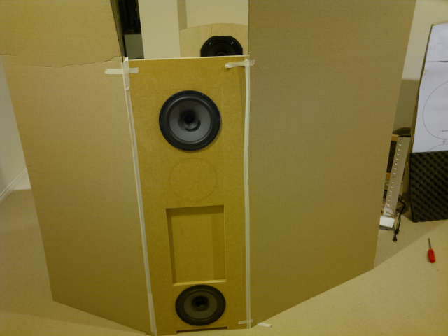

I will start testing the AN drivers on PHY baffle soon. I just need to get more cardboard.
After that I will try slot loaded PHY baffle

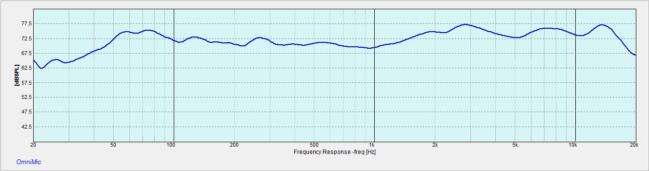

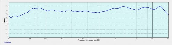

I'm surprised that the baffle with 2 drivers (without the wings) goes as low as the graph shows. Then again, how tall and deep is that baffle (without the wings) ?
Is the bottom one running wide open or is there an inductor on it ?
And it is believable that the wings do nothing. The front and rear short circuit over the top. The top one's rear short circuits the bottom one's front (makes sense to me).
Me too.
Wait I will do the measurements
The centre baffle is 120cm x 45cm
The wings are 102cm tall x 35cm deep (at the bottom) and 30cm deep (at the top)
The change in depth from top to bottom occurs in a linear fashion
1.5 way rememberIs the bottom one running wide open or is there an inductor on it ?
There is a 4mH inductor on the bottom woofer
Yes the top one short circuits quite quickly, but what about the bottom one?
I would have thought the additional width might have had an influence on extending FR on the bottom woofer.
Yes
This makes sense. Although I would have thought to a much lesser extent because it has already short circuited itself.
Just trying to make a bit of sense to this. I think you are right though
