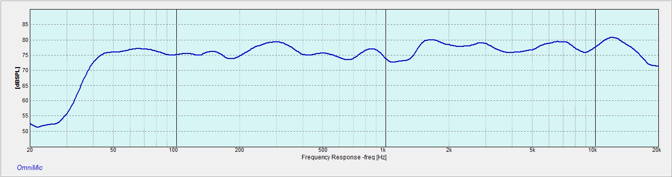

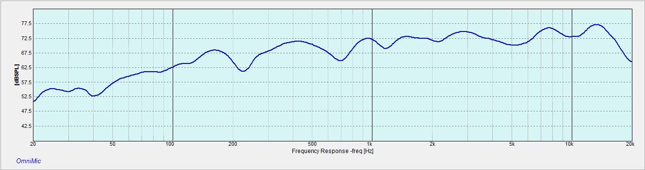

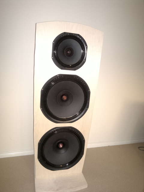

This is what I achieved on a narrow baffle.
However I reckon the PHY baffle will be much better.

how are those drivers hooked up ?
A honker inductor across the 15's ?
response looks really good except that 10db hike past 1khz and 10db hump around 300hz.
I'm not sure the huge ob will help it much.
Flat to 45hz, what more do you want out of it ?
Norman
but the an10 +2 x an15 looks real flat 100hz-1khz (minus that crossover hump at 300hz).
Crossover 6db ? You may want to lower the low pass an octave............
but you are right, it is a fullrange driver plus bass assist.
To me, I get nervous when a woofer goes so high, but if it works..........
Norman
Well remember it is not a woofer. It is a fullrange woofer excellent in its own right, manufactured with the same construction, so tonally it is very similar to the 10" so it should mate fairly seemlessly, and indeed it does. The crossover needs more work though
I agree it would be nice to low-pass around 100Hz to 150Hz, and with the PHY baffle I will predict that will be the case
The filters are just Inductors (ie 1st order)
