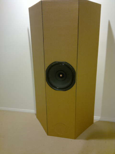

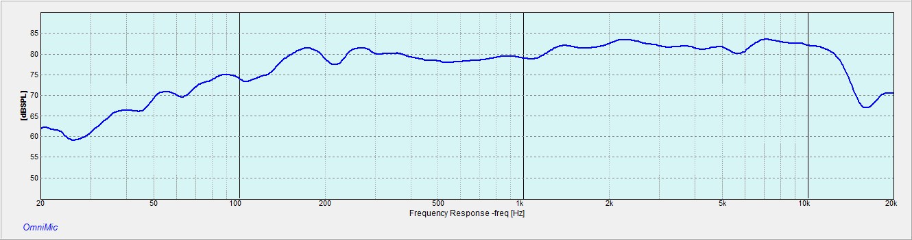

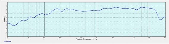

OK here it is.
It doesn't tell you what it sounds like but here is FR plot

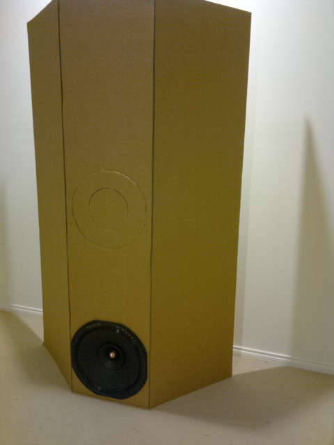

I will also repeat the response with woofer positioned near floor to get an idea of what a 1.5 way should look like once crossed over.
Then play around with inductors till I have it perfected

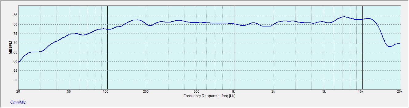

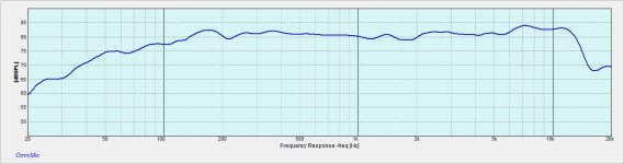

Ok here it is
Here is the first one for ease of comparison

How deep are the wings ?
Are they 24" (61cm) deep ?
Can you please give us the exact dimensions of the baffle and the center of the driver ?

It is exactly the same dimensions as what was used for the Seas.
IE 40cm centre baffle width with 50cm wings. The centre of the driver is 95cm above the ground. The height of the baffle is 6 feet.
Yeah I will measure it against the wall.Oh yea, and the phy OB closer to the wall, that should go flat to 100hz I bet !!!!!!!!!!
