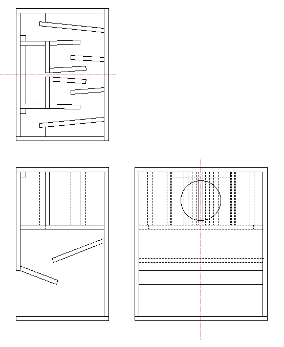

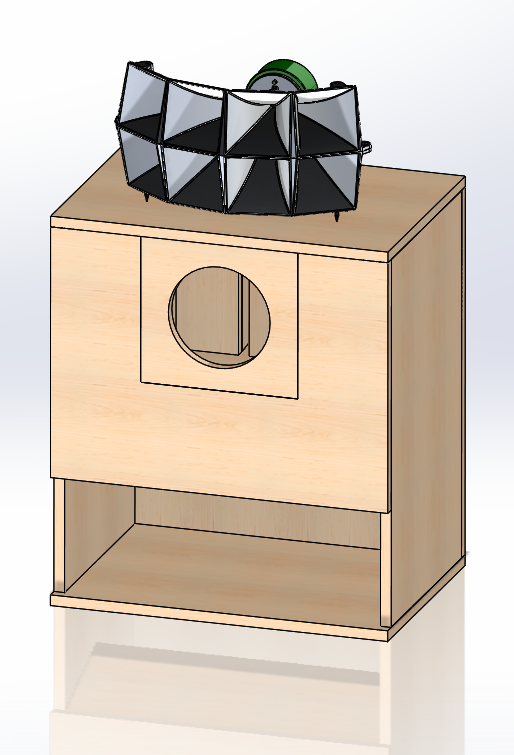

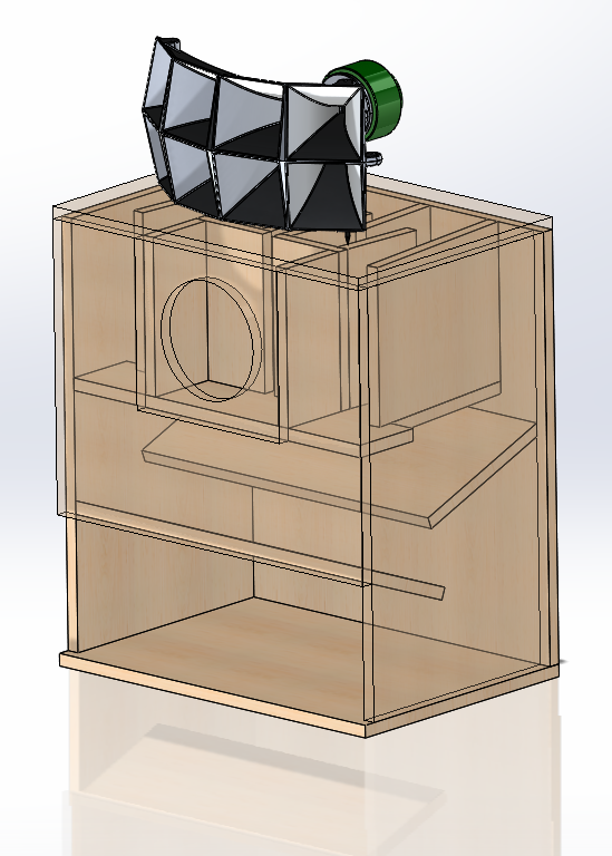

hey Dave - here's what I had in my email box from 2007 - can you make out enough to do a drawing?
I already did a drawing sufficient to generate the 3D. Probably only needs dimensions and minor details.

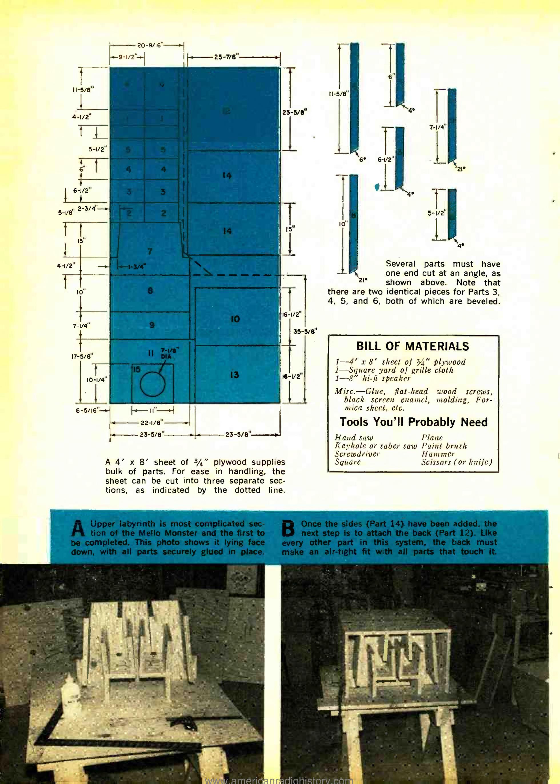

BTW: the article has an error in (at least) one of the panels, so it may not fit into one sheet of 4x8.
dave

there ought to be drivers today which are a good fit parameter - wise. It would be nice to see clear plans and any notes not published in the magazine article. (link below)
https://worldradiohistory.com/Archive-Poptronics/60s/62/Pop-1962-10.pdf
(any previously unpublished Karlson history is welcomed too. I think there's a paper associated with the later Karlson Twelve which told how many holes to drill in the port panel for a particular speaker)

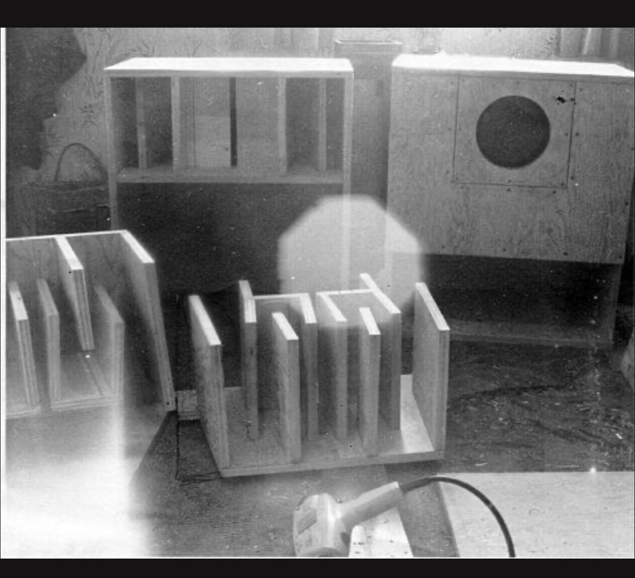

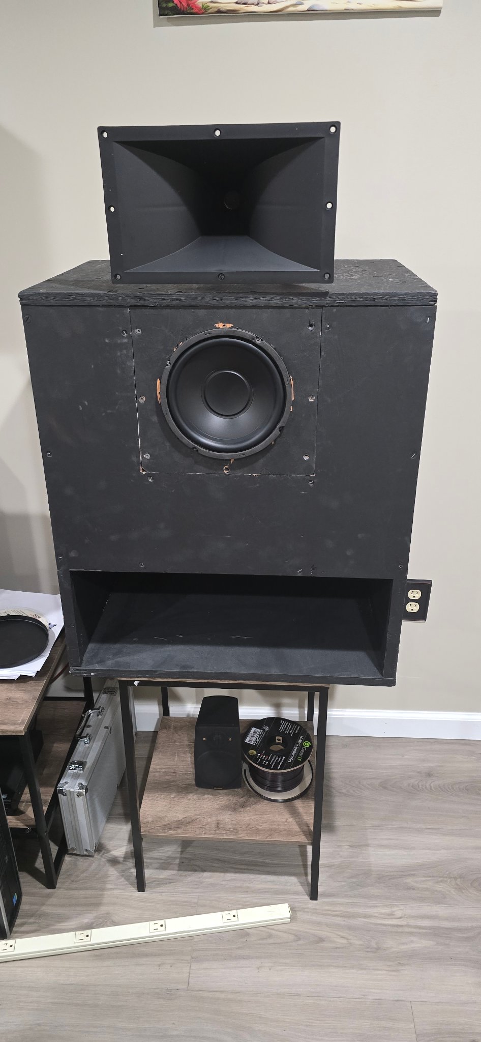

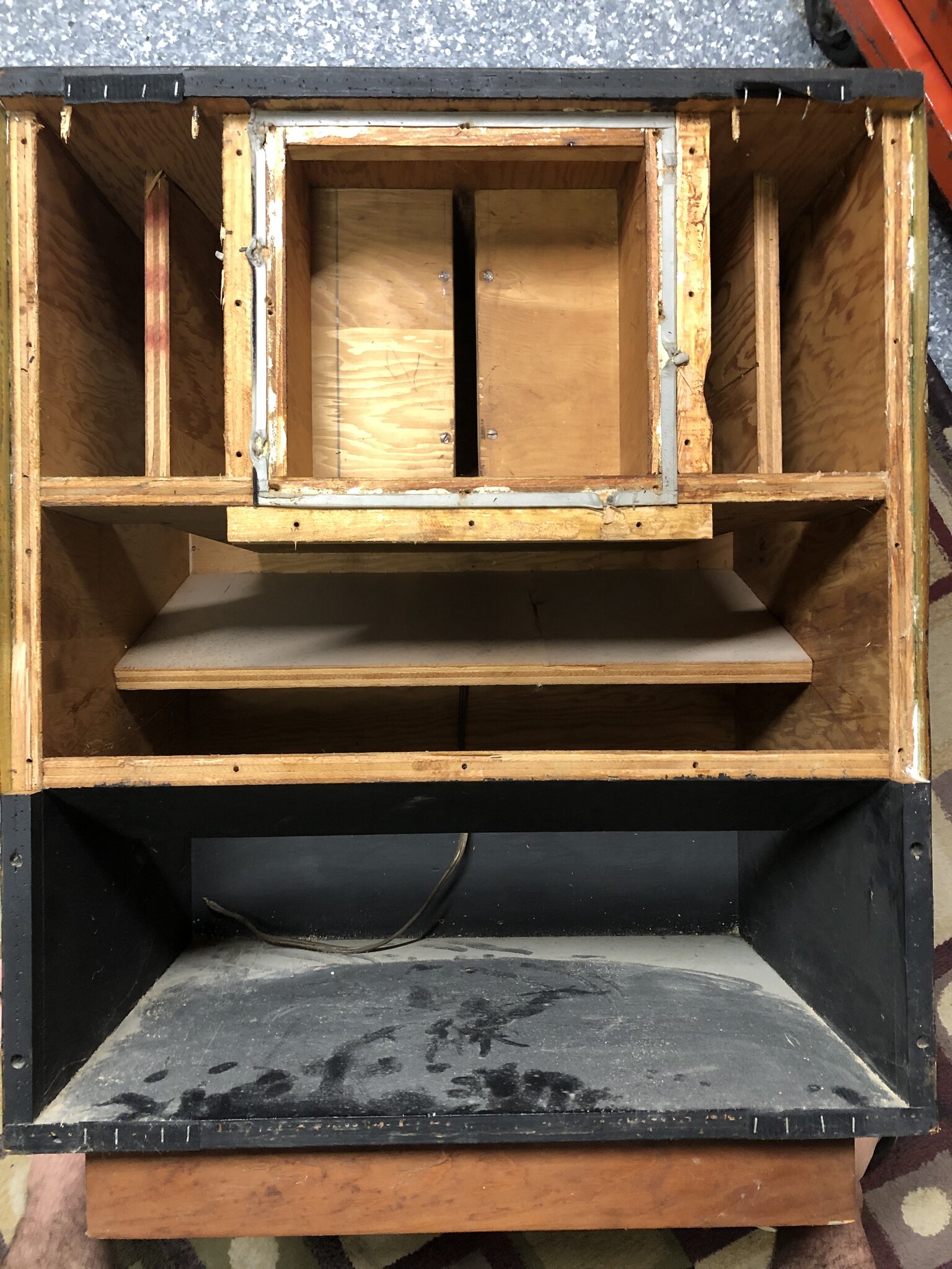

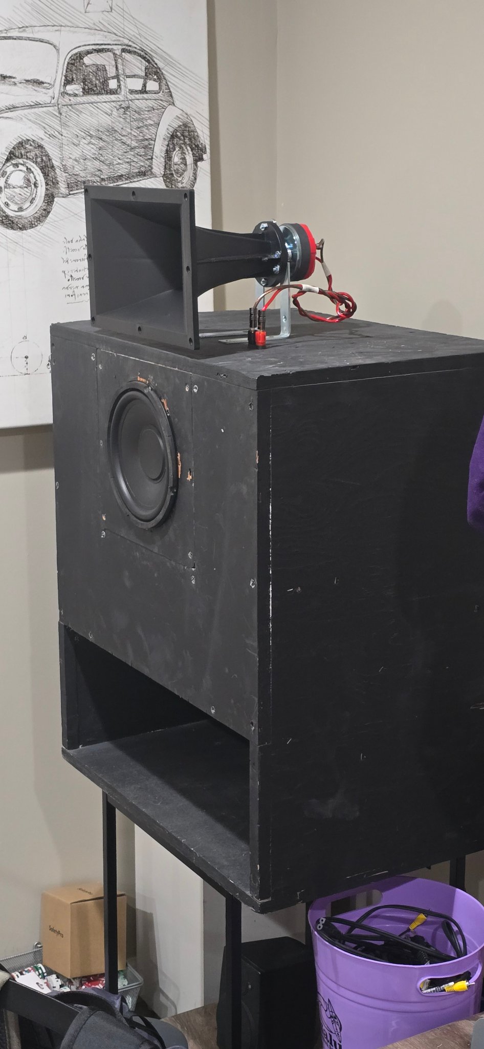

Just to enrich this post with more information about mellow monster I am sending the images I found in this link:
https://hifihaven.org/index.php?threads/the-mellow-monster-and-a-lil-coral.8894/

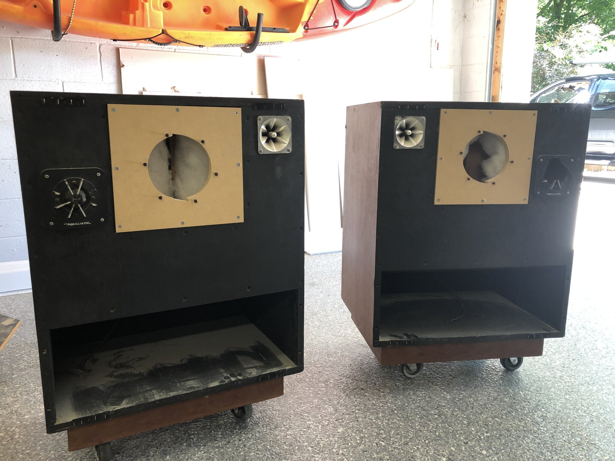

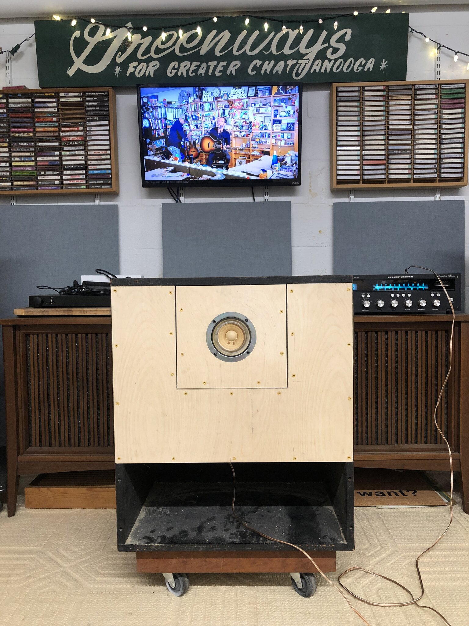

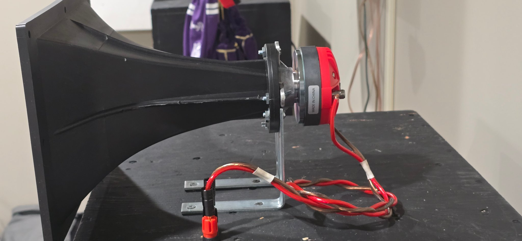

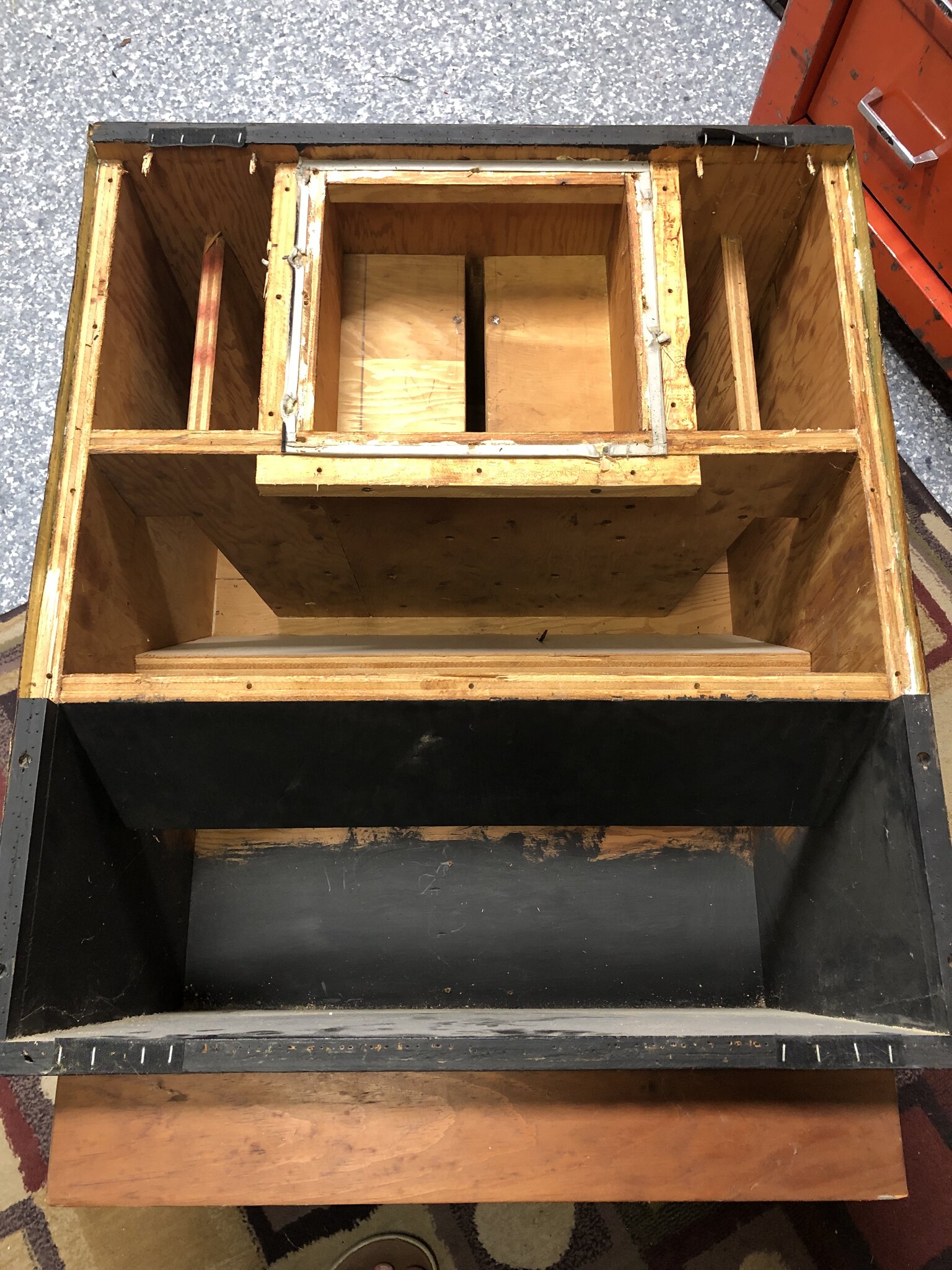

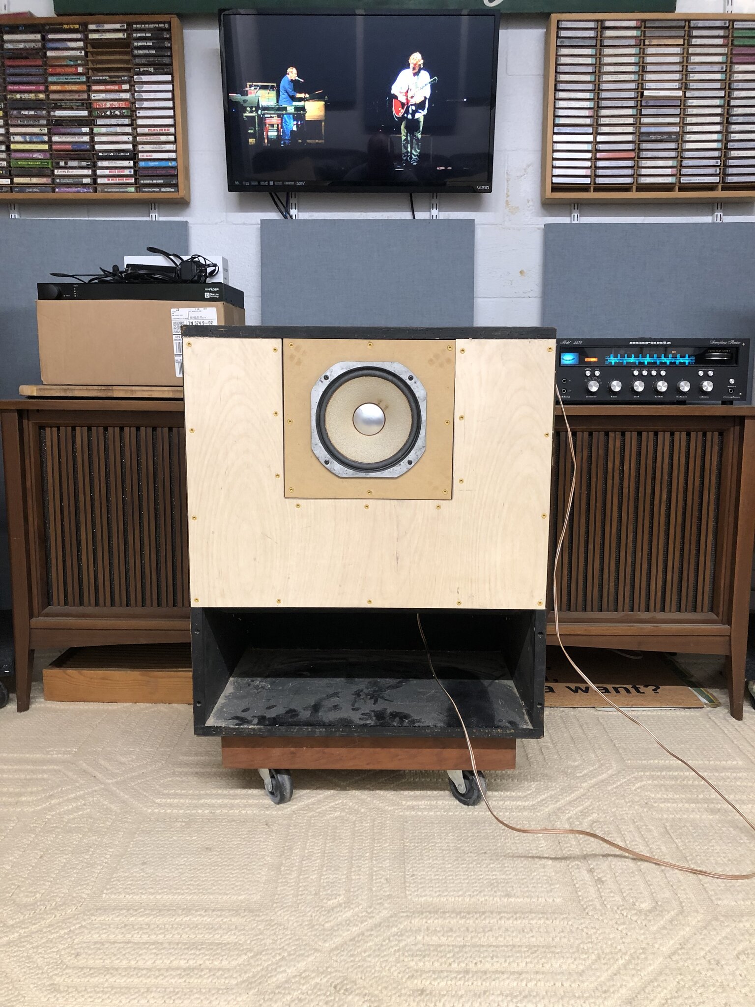

I love the Mellow Monster, was given a few years ago and didn't do much with them. Decided to revisit them over the last few weeks and make some changes. The outsides are a little rough so the next project is to veneer them.
