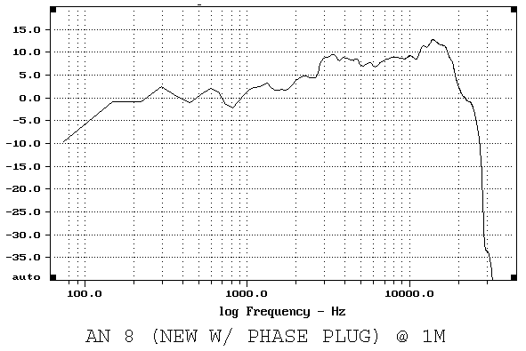

901Fixer said:I wonder if the 8" has the ability to produce the HF without tweeter help.
Here is a curve taken from 1M on a large flat open baffle.
Nelson-
Thanks for that data.
If I'm reading the scale correctly, your data shows the output crossing the 0dB baseline above 20kHz. Is that correct?

Actually, I have not begun to address correcting this response curve. It does,
however, answer the question asked.

panomaniac said:Ouch! Put an inductor on that thing, Nelson. 😛
Well, it's the listening that counts, I think- tough to tell from a graph. Anyway hearing response is far from linear anyway, and the picture gets worse with age.
Human hearing thresholds
I did try both a Zobel and BSC filter with my AN10s and didn't notice much difference (I had it set up with switches so I could do some AB tests more easily.) Perhaps I wasn't listening to the right kind of music to show up the differences.
