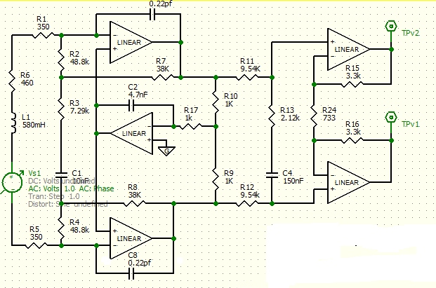

May be I may give some comment on Russ White's circuit diagram.
It mentions that is meant to be used for a MC Cart.
Gain is 50dB, which is very low for an MC Cart, should be at least 60dB.
But it has two 100 Ohm resistors in series with the cart, producing 2nV/rtHz, which is killing the 1.3nV/rtHz that the OPA1632 is producing.
So these two resistors should be reduced to zero ohm.
With the cart connected in that way, you have a real virtual input circuit, although delpending on your Cart, gain might be a bit high now, but that can be corrected by reducing R1,R3.
One other minor point is that R22,R23 and C11 are playing no role at all and can be omitted.
The full Riaa curve is implemented in this circuit, so your DSP has no corrections to do.
When however you would prefer to involve your DSP, then you can pick the signals Vout+ and Vout- from IC2.

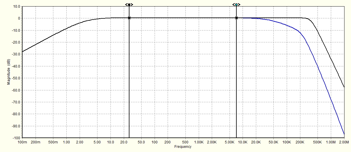

Here's a simulation of TL082 versus AD745 for U1. Single ended Aurak 3, with NE5532 as U2. Both plots with C14 2pf (strays only) and C13 100pf (hf roll-off control). TL082 blue, AD745 black.

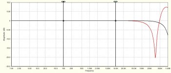

Here's a swift simulation of OPA1642 (Red) versus OPA1632 (black) in the front end of balanced version of Aurak 3.
The effect around 300kHz et seq is due to GBW limitations in the 1642, so if one is going to allow the circuit to operate at such bandwidth, this might be sensible to intentionally roll-off before then for the OPA1642, I think, for stability.

LD, can you please show the circuit diagram that you used for this simulation, because none of my sims does show anything like this.
Hans

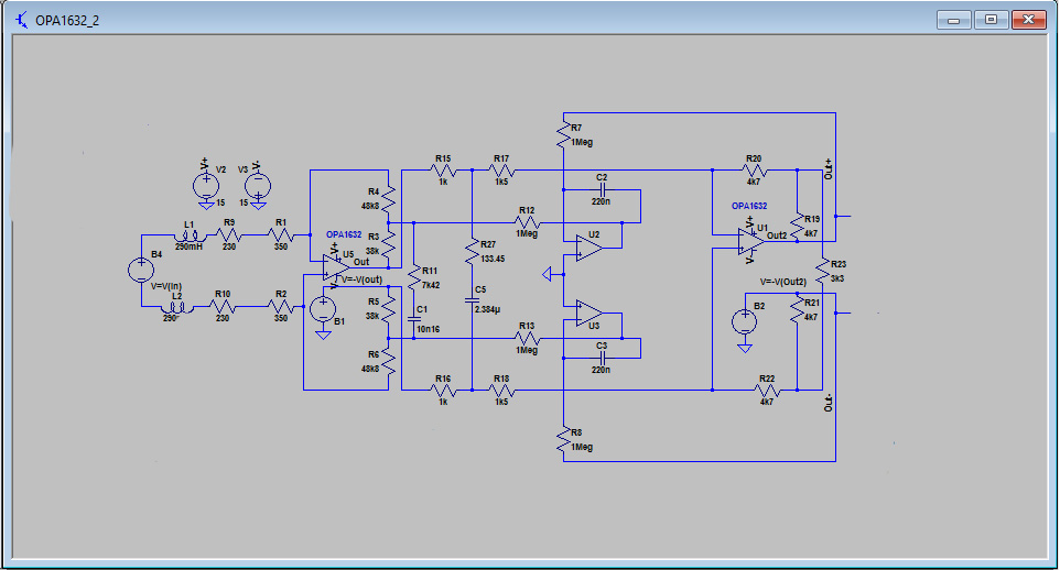

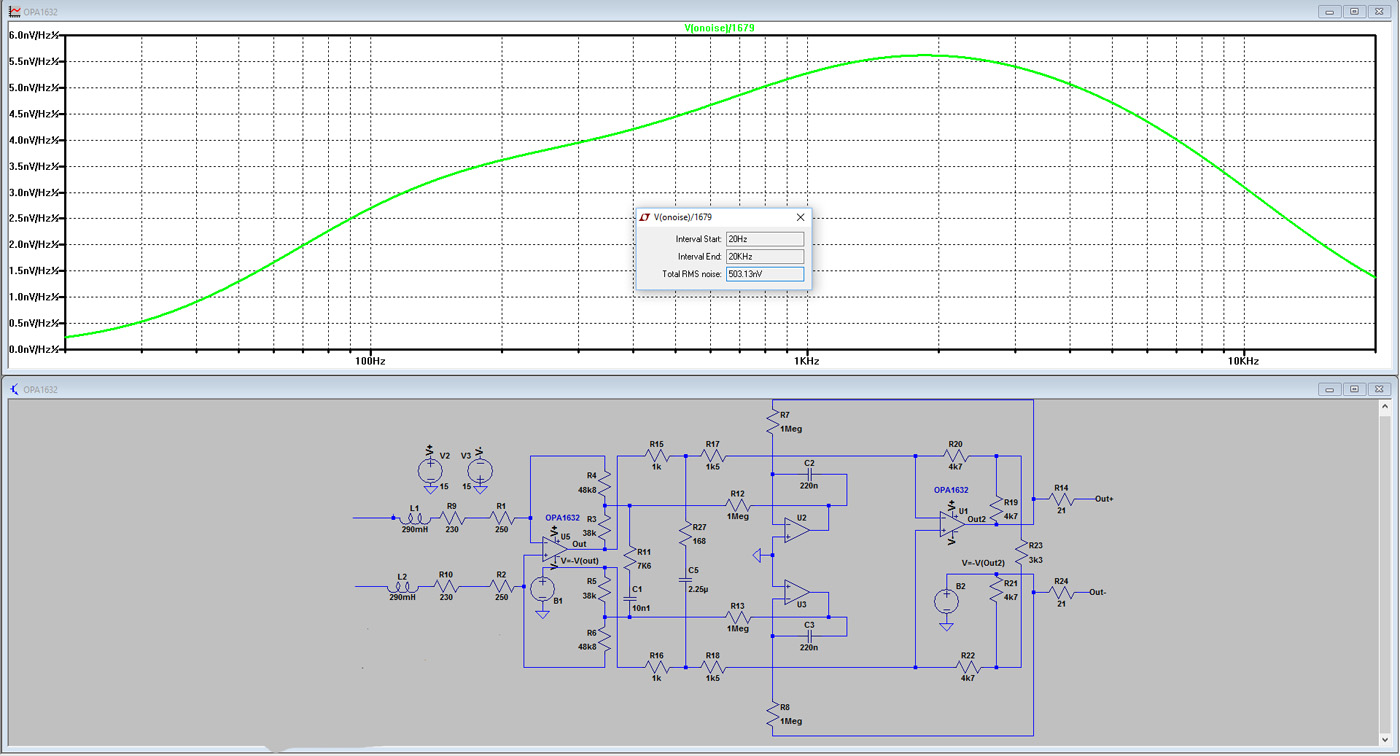

Hi Bill,
I simulated the OPA1632 circuit for which you can get a PCB, and yes it turns out that this OPA can be used very well.
Measured noise was 79.9 dBA, even one dB better as with the OPA1642.
See the modified circuit into an Aurak design below.
Hans
Hi Hans, here's the simulation schematic. What GBW value is in your model for the 1642 ?LD, can you please show the circuit diagram that you used for this simulation, because none of my sims does show anything like this.
Hans
PS included are 0.22pf estimates of miller C due to strays.
LD

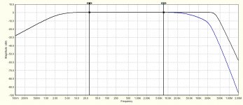

Phase margin of the OPA1642 at 0dB gain is 67,5 degrees. In my simulations I used a worse phase margin of 45 degrees to stay on the safe side. So the question is, what model did you use for your simulation.
Hans
TI's spice model dated Oct 2011.So the question is, what model did you use for your simulation.

Then again, can you show the circuit diagram that you used, there must be something that causes this effect.
And what Sim program do you use, LTSpice ?

As you may have seen, I had used 2* 250 Ohm resistors in the input instead of 2* 350 Ohm, to fulfil 2*L-R for 580 mH and 460 Ohm.
Here is the corrected diagram. Noise is still the same.
