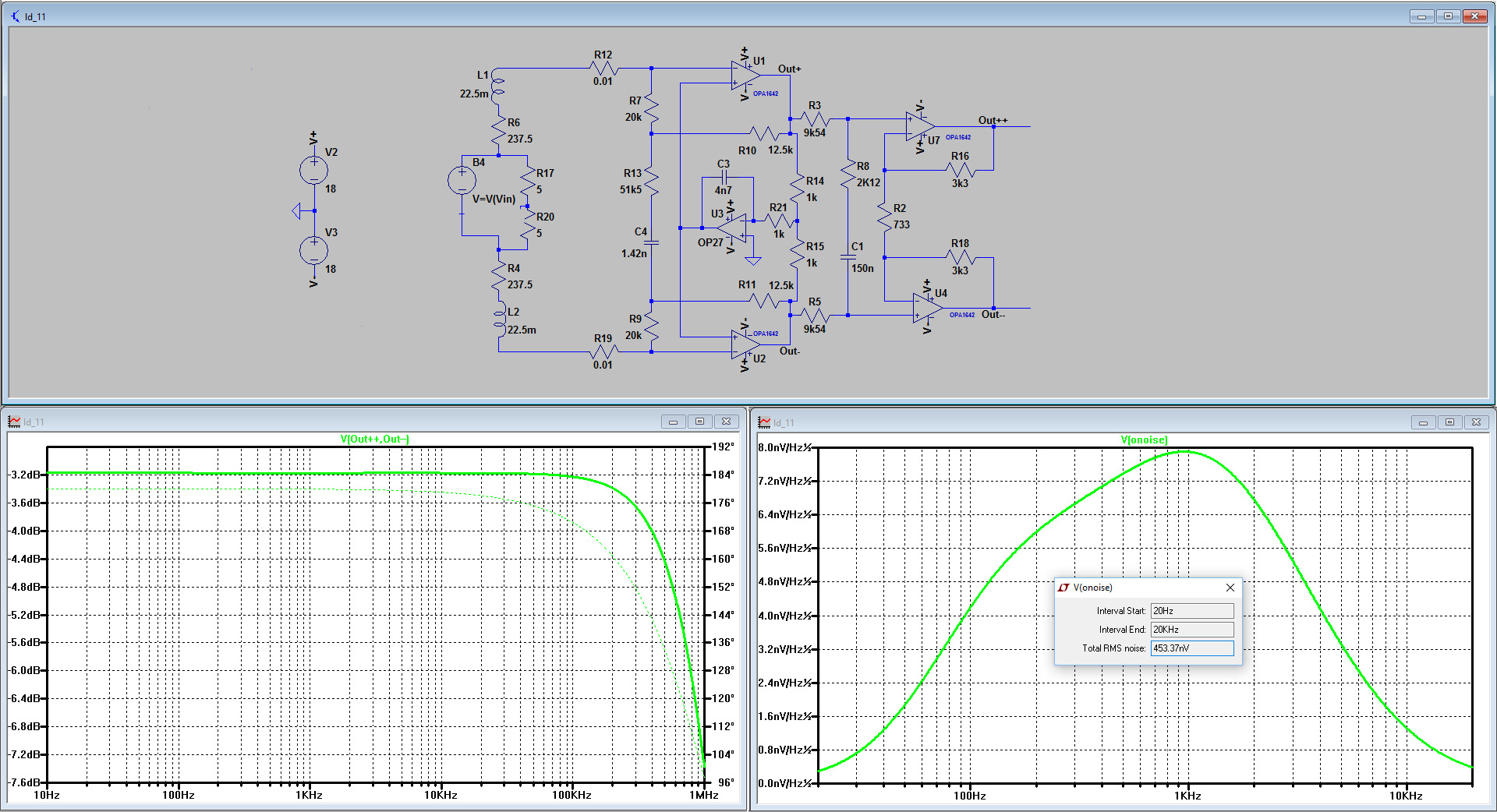

R ends up as negative for the case of Shure M97xE (Lo=588mH, Ro=1345 Ohm, thus R= -169)!
Is it because of this that you wrote the idea works with some cartridges and it doesn’t work with others?
Any suggested way to go around it?

I thought R = 2L - Rc law almost covered them all, but evidently not ! For exceptions, rejig to R = 3L - Rc seems the way, which is easy enough. For the single ended Aurak 3 sketch, using standard value partsHi Lucky

Hans, in your sims have you looked at how noise changes depending on where you put the first pole? I know it's low enough to actually not be worth worrying about, but the expectation would be noise would go down as the pole moves up in frequency.
Whith poles moving up in frequency, either Lcoil is smaller or Rcoil is larger.
The first one results in less noise, the second one in more noise when Rcoil is the only resistor in series with Lcoil.
When for instance looking at the 580mH and 460 Ohm Cart that I used, I had to insert a 700 Ohm resistor in series to fulfil R= 2*Lcart-Rcart.
This gave a pole at 318 Hz.
Had I left the 700 Ohm, the pole would have been shifted down to 126 Hz and noise generated from the 700 Ohm resistor would have been avoided.
After some recalculation of resistors around the first stage, this would have given a slight improvement in dBA.
However a 700 Ohm resistor generates 3.5 nV/rtHz as against 5.1nV/rtHz for the OPA 1642, so I do not expect anything significant.
R=2*Lcoil - Rcart is good enough and no reason to worry.

I was more thinking (getting nursery sorted over the weekend so only limited thinking time), that the lower the pole, the more gain you need. Front end gain is a key source of overall noise so there might be a sweet spot. But if the series resistor dominates noise that's not a worry.
Plus I'm overthinking about what can be done downstream in DSP!
Why not give us the exact details of the Carts you have in mind.
With your DSP in mind, proper advices can be given in more detail.

Well I have 3 cartridge options to consider
1. AT150Mlx 2k3Ohms, either 350mH or 450mH (need to confirm)*
2. Ortofon Super OM. 1kOhms 580mH
3. mono strapped super OM (as 2. doubled).
*looking around I think I will need to measure it or find someone who has. There are numbers all over the shop.
EDIT working back to DC from the numbers I have (which are not from AT website but vendors) at 1kHz gives 356mH and 530Ohms, which I can believe

For your AT150MLx a modified Aurak has to be used, because 2*350 - 2300 is a negative figure, but don't worry I can fix that.Well I have 3 cartridge options to consider
With this modified Aurak I can give you the value for the series resistor for both Ortofons.
What I found for the mono Ortofon is 330mH and 700 Ohm, but that may be a different type.
So when having the exact figures for the 3 elements, I will present you a solution for an amplifier that only does the 75usec correction.
Within your DSP you have to do the 318 and 3180usec.

2k3 seems awfully large.........? More likely that's impedance@1kHz, whereas what you need to use is dc resistance, Bill.

I did note in my edit that I worked out the impedance. Did that not show? 356mH and 530Ohms.
Hans: I was talking about serial strapped super OM so 2kOhm and 1160mH. This is a config LD already uses.
BTW any good reason OPA-1632 wouldn't work as the front end?
Yes, soz read the post, did some stuff, then replied. So missed the edit. Seems plausible 530R.I did note in my edit that I worked out the impedance. Did that not show? 356mH and 530Ohms.
OPA1632 should be great, superb gbw amongst other things, needs good layout of course.
