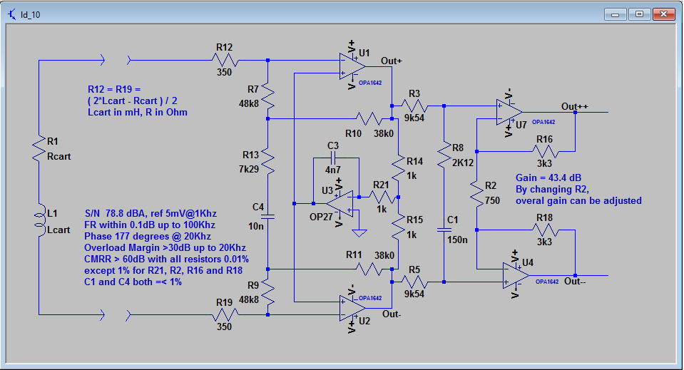

I think C2 should be a 100k resistor?Hans,
In the schematic from post 331 (above), should the value of C2 be 100nF?
LD
Hans,
Sorry, something went wrong in the transfer. C2 should in fact be a 1K resistor and not at all a capacitor.
And FR is within 1dB up to 400Khz and not within 0.1 dB.
Hans
So Hans, Good work here on this new balanced Aurak. How to solve the old R1 gain now to make this cart specific?
The algorithm is still R1=2*Lcart-Rcart. So a 580mH + 460Ohm Cart gives 1160-460=700Ohm.
In the balanced setup this 700 Ohm is divided in two equal parts, one at each input, to achieve an optimal CMRR.
Hans
Hans
What if R1 is negative?
Quite simple, a new pole higher than the current 150 Hz will have to be used and all values around the first stage will have to be recalculated.
When you have a real example, I can show how this will look.
Hans
Hans

Yes, the current spec on the motor assembly for most of them is 45mH and 475 Ohms. Seems a high ratio (fewer turns of crazy small wire???) or do modern high N magnets somehow enable this, I'm out of my element here.
This element would have it's -3dB point at 1680Hz without a resistor inserted in series.
With a modified Aurak, this -3dB point would have to be shifted from 1680Hz to 2123Hz (=75usec).
This is still easy to achieve with C4=0.6n and R13=115K.
Hans

Just for the record:
After having optimised the circuit for 45mH and 475 Ohm, having now the same 43.3 dB Gain and the same overload margin as before, S/N ref 5mV@1Khz is now an unbelievable 80.8 dBA with the Grado Cart connected.
Hans
Hans
Hans
That is in general my finding with using a normal MM input (47k) the inductance and inevitable cable capacitance resonance with the inductance does not add as much noise. Using JFET's one can approach the noise limit of solely the series R. In any case, 80dB would leave you with surface noise only I suspect.
Yes, IME Riaa preamp noise above ca. 65dBA can't be heard at normal playing levels with the PU Arm in the air.
So 80dBA is way above the surface noise and offers a very comfortable margin.
Hans
