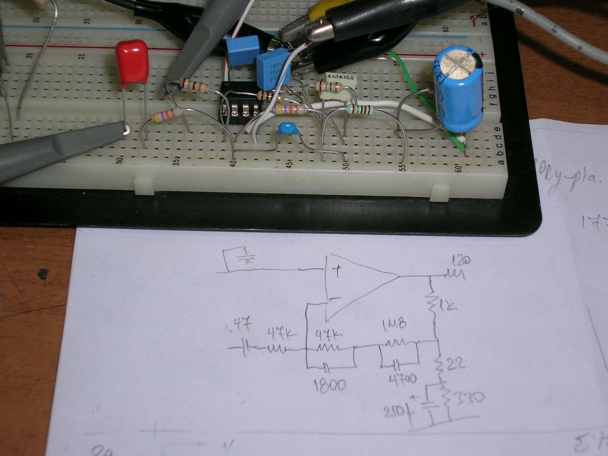

I guess the JLH Liniac version in John Broskie’s tubecad #373 is one of the non-traditional RIAA arrangements, although simple and with standard component values (*)
In simulation it behaves very well.
I bread boarded it today with a TL082 in place of the liniac amp, intentionally a bit of a mess to check if it oscillates, amazingly though it doesn’t. 😀
I’ll build a proper dead bug version on copper sheet and I’ll report back
