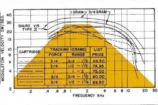

Which is all good stuff based on a premise that the cantilever is rigid, but not so good if it isn't. IMO, it's not that such physics is wrong, it's just misapplied.
Well, enough dots are there, they just need joining slightly differently, IMO.Being a good engineer, Roger explains that effective tip mass is a calculated parameter, not a measured parameter. It is an abstract concept that is solidly grounded in physics but it is not directly measured. The measured parameter is trackability. It is the gap between the measured trackability and the ideal trackability (calculated using the effective tip mass) that is of interest. As Roger puts it:
Therefore, the answer to the original question "Equivalent Mass - Fact or Fiction?" must be an emphatic "Yes!"
What determines trackability is mechanical impedance to stylus motion. For tracking high acceleration, ie high curvature grooves, this impedance is typically limited by inertia of whatever moves. One can work backwards from measured trackability and determine mechanical impedance, from the limit of trackability versus VTF for swept frequency.
Attached is such a published mechanical impedance measurement for a V15, along with Shure's published trackability chart, for interest, one can see the approximate inverse correlation quite well, I think.
Such real deduction of mechanical impedance naturally embraces what is really going on, whatever that be, in terms of contribution from suspension spring, damping, and inertia from the moving parts.
By choosing different specific frequencies, classically one might estimate cartridge suspension spring, damping, and inertia of moving parts, based on assumption that impedance is pure spring, damping, or inertia.
So, determined this way, 'tip mass' would be a restatement of measured trackability, and would seem bound to differ from inertia calculations, mostly because real cantilevers aren't rigid, and non-zero contribution from suspension spring and damping.
However, a few years back dlaloum noted a strong correlation between his measured mechanical resonant f and published tip mass figures, from many and various cartridge manufacturers. Thesis is that tip mass, as published, might be a restatement of mechanical resonant f, worked backwards assuming a standard spring constant. This correlated far better than tracking performance, IIRC, and was tough to explain otherwise I thought......
Anyways, 'Fact or Fiction?', I agree it's probably both, but for sure isn't what is commonly understood to be !

Well no, the published plot is mechanical impedance to motion of the stylus. Well, strictly the magnitude of mechanical impedance at a specific frequency. It was derived from measured VTF required at the onset of mistracking of a given velocity. It's not great physics, but is OK and it's what was done in the day.In fact, the variability of the damping coefficient is what is shown in the first chart for the Shure V-II, not mechanical impedence.
So all effects contributing to trackability are rolled up in there, including, but not limited to, damping provided by the elastomer. Incidentally, impedance at 100Hz was read off, expressed as if it was pure spring, and this is the meaning of compliance at 100Hz as used by Japanese cartridge manufacturers. Even though at 100Hz impedance is more damping than spring, and not much inertia.............whatever !
