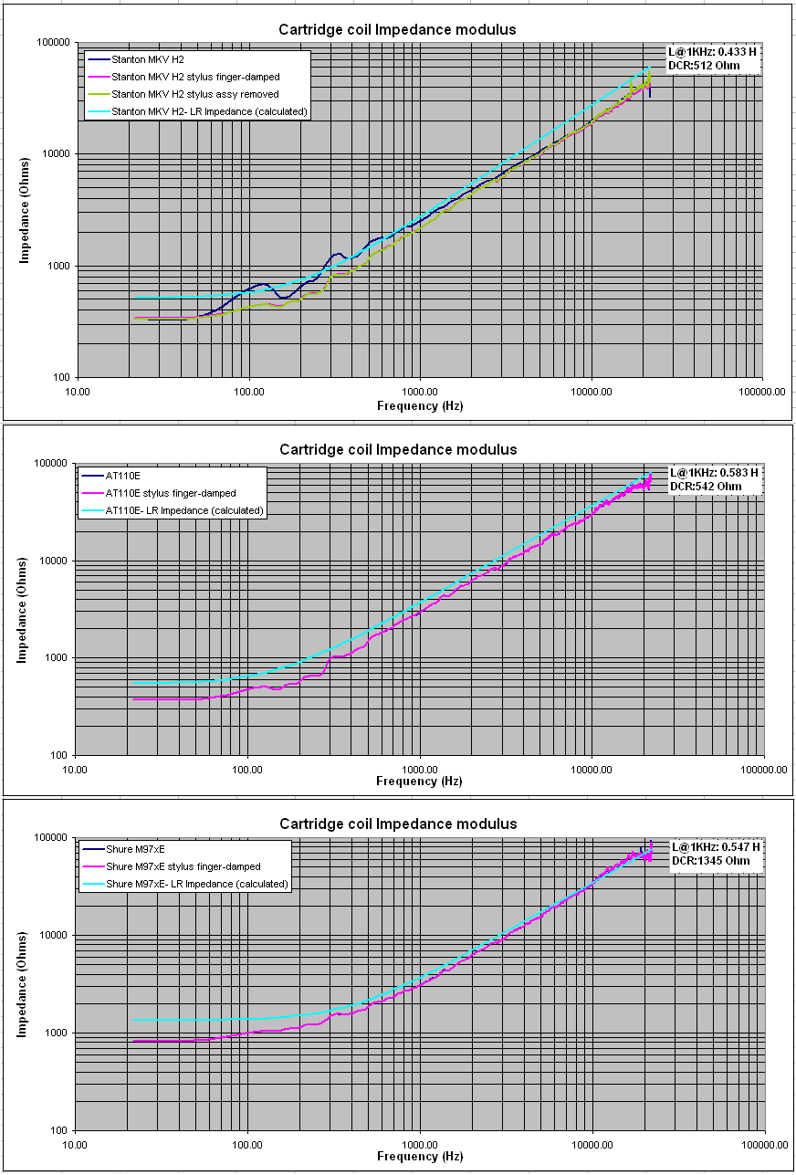

Thank you bondini for the measurements.
Here are some Impedance sweeps (22Hz-22KHz) using Speaker Workshop SW.
Data imported into Excel and smoothed exponentially with a D.F. of 0.9
Impedance measuring standard jig
Ref Resistor: 1KOhm
R coil measured for each cart.
Loading is the input impedance of the audio card, which together with the jig wiring is 10KOhm//110pF
George

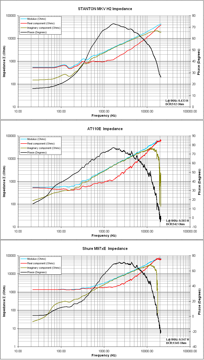

One needs to consider electrical impedance to be 'complex' in the mathematical sense, when either or both inductive and capacitive elements are in play, if one is to describe them so as to meaningfully work with them here. For example, to consider the ratio of voltage to current, ie impedance, which is a 'complex' parameter, or so as to work out power transfer function of the cartridge generator.
So be careful out there if dealing with complex variables as magnitudes. This approach has limitations which might otherwise mislead............
IIRC, I noticed previously that typical MM carts appear to behave as a generator as though inductance was somewhat different (smaller?) than that measured by simple meters..... perhaps a factor of 10-20% from memory.... that might fit with some of these recent measurements ?
Otherwise, IME the output impedance of a typical MM cartridge within the audioband closely follows an LR law for practical purposes. Generator transfer function, which typically follows a 1st order roll-off, and which, for better carts does not appear in the audioband or reasonably above it, is super-imposed on this.
LD

Gpapag was correct in mentioning impedance "Modulus", because that is exactly what he did. There is nothing misleading to my opinion.
Hans
Hans
Agreed. Any complication might arise if one were to treat magnitude or modulus as 'real', which isn't nec so, of course. But George hasn't done that in any event. I was trying to get my head around, and interpret Bondini's posts, when I thought to mention the general point.Gpapag was correct in mentioning impedance "Modulus", because that is exactly what he did. There is nothing misleading to my opinion.
Hans
LD
The AT440MLa is a well-designed, well-made cartridge.
For what it's worth, my take on the impedance measurements for the AT440MLa up to 20 kHz are very consistent with modelling it as a generator, resistance and inductance, all connected in series.
In my view, neither the impedence data nor the Miller Research output data show artefacts of mechanical resonance in the bandwidth up to 20kHz. That is not to say that there aren't such things above 20kHz, but that is beyond the capacity of my hobbyist instruments.
Slightly off-topic: The AT440MLa's elevated output at high frequencies is well known. It can be ameliorated somewhat by altering the loading on the cartridge (yes, I have tried). But, as Werner Ogiers showed in his excellent 2008 TNT Audio article (Load the Magnets!!! - [English]) it is a process of compromise. As he puts it:
Both electrical and mechanical aspects must be incorporated, and this means measuring the real thing, or failing that, listening to it. Or vice versa of course.
Agreed, and well put.The AT440MLa is a well-designed, well-made cartridge.
Did you get as far as trying transimpedance loading, bondini ? That cart's a good candidate, and the boxes you identify are those that need to be ticked for this to work out well. After that, TI is the way to fly with MM carts that can do it, it's sort of rude not to IMO.........Slightly off-topic: The AT440MLa's elevated output at high frequencies is well known. It can be ameliorated somewhat by altering the loading on the cartridge (yes, I have tried).....

Thanks again Hans and Lucky for the comments.
With post #270 I wanted to show the Impedance modulus trend and the observation that the modulus is not affected almost a iota from the finger damping of the cantilever or from the total absence of the moving magnet (another indication of the lack of reciprocity due to very weak magnetic coupling)
I withheld the complex data for a bit later. But since you asked… 🙂
I have only “touched” the phase data below 300Hz (too rough variations due to only few sampling points –thirteen- below 300Hz). Otherwise, data is legit.
I opted for log vertical scale, so that differences btn the modulus, real and imaginary parts are clearly visible.
The drawback with the log scale is that it can’t display the negative values of the imaginary component at high frequencies.
Shure turns negative above 17780Hz, AT above 19550Hz and Stanton stays healthily positive up to the measurement limit of 22KHz
George
