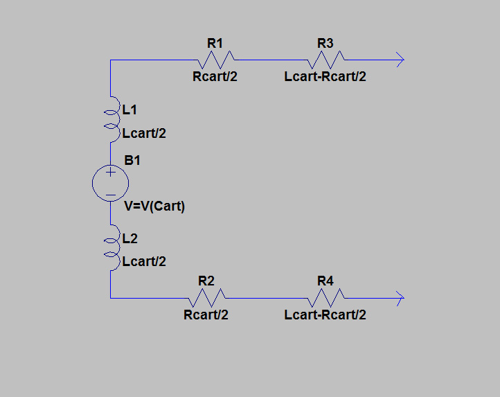

I know what caused the dip at 300Khz in your FR.
When you don't have a floating voltage source and when the 580mH is all on one side of the voltage source, one halve of the differential stage has no phase turn from the coil and the other has the full phase turn.
Either split the coil in two equal parts and place them on both sides of the voltage source or use a floating voltage source just like your Cart.
Even better, just to prevent any misinterpretations, is to have a floating voltage source in the middle and equal parts of Lcart, Rcart and R on both sides.

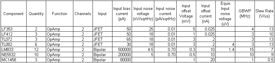

TL082 GBW is actually a bit skinny for U1.........
Here's a simulation of TL082 versus AD745 for U1. Single ended Aurak 3, with NE5532 as U2. Both plots with C14 2pf (strays only) and C13 100pf (hf roll-off control). TL082 blue, AD745 black.
LD
Thank you Lucky for commenting and for the sim.
I have to work with what is in my parts bin (and dual PDIPs when possible, for dead bug construction).
The NE5532 (and the LM833) would be good candidates even for IC1 but I think FETs at the input are a protection against RF noise ingress, therefore a JFET IC has a place there.

Yes, agreed that is the cause, and a balanced voltage source with split impedances avoids the problem. Then I obtain similar plots/stability as you do, Hans.LD,

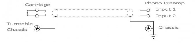

I think in reality this means, for the balanced Aurak versions, the cart coil should be floating, ie one side not grounded, which is worth noting. This might interact with/degrade ground screening of environmental sources of noise, relying instead on CMRR, I suppose. But at least transimpedance input impedance is low.
LD
well I have never liked having cart -ve strapped to the body and prefer cart grounded to tonearm*, then twisted pair wiring with good screening. As this method is immune to capacitance you could even go the whole hog and use star quad for total overkill.
If you swap carts and have different headshells for each then there is the possibility of the series R being at the headshell end. Slightly tricky soldering job but convenient.
*As shown by George on one of his threads.

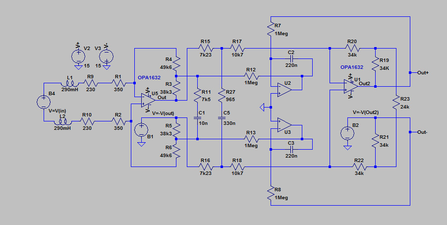

Like this
Starting with 10nF and 330nF for the two important capacitors, I have recalculated all resistors to existing E192 values.
Most resistors still should be 0.01% to keep CMRR below 60dB.
A 330nF 1% cap is much more affordable then 1% values of 1uF or above.
Going down with the cap value from 2.25uF to 330nF causes an equal increase in surrounding resistor values leading to a slight loss in S/N, but 79dBA is still more than good enough IMO.
Bill, this is not the final solution for the 3 Carts that you have, but when I have your final and confirmed values for Lcart and Rcart, I will do another sim for you as promised.
Hans

Basically, but with a line from the tonearm to the cartridge gnd.
Hi Bill,
What do you mean with cartridge gnd ?
I think that all TT metal including tonearm should be connected to the TT chassis gnd, at least that is what I did with trouble-free results.

There is often a separate ground connection within the cartridge to internal components and screening, and sometimes the cantilever ground. It is sometimes hard-wired to one of the cart ground pins, sometimes it is produced at the top plate of the cartridge for pressure connection to the tonearm/headshell.What do you mean with cartridge gnd ?

Hi Hans,
Thank you I'll get some PCBs ordered and try and get final confirmation soon.
Ref the 0.01% resistors. In your experience is it better to get 10x quantity of 0.1% and select pairs with closest tolerance?

What is important for CMRR is that all pairs on both differential sides are within 0.01% to each other like R4,R6 and R3,R5 etc.
In absolute value 0.1% is good enough.
So you are right, you could select from 0.1% resistors pairs that are within 0.01% to each other. I do not think you even need 10 pcs for this selection, probably 5 will be enough.

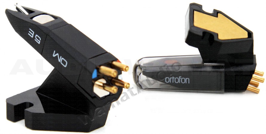

That’s a very clever idea Bill.

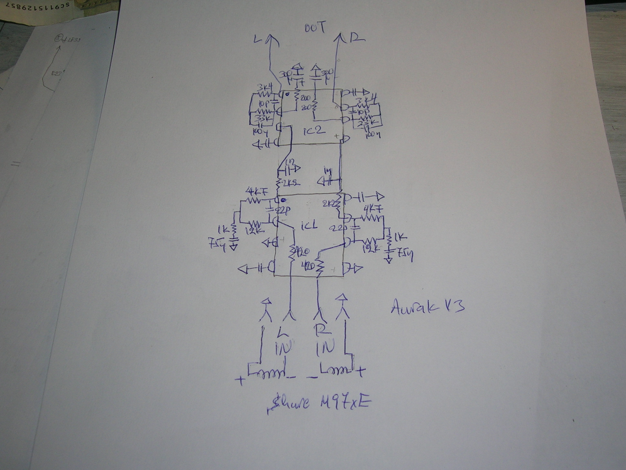

This is correct but please consider the detail that single ended Aurak 3.0 is inverting the signal.
Thus with a standard tonearm wiring and a non floating cartridge coil, signal polarity is reversed.
If one wants to preserve the absolute polarity when using single ended Aurak 3.0, the cartridge wiring has to be reversed (+ for – as shown in the hand drawing in my previous post #403) and consequently the cartridge has to be (or made to be) floating.

One practical point for the balanced version using a floating coil: consider the possibility of static charge accumulation or discharge to the floating coil. Not sure if the 1632 has internal clamps, but probably a good idea to protect the input pins with a network in any event, methinks. Also consider the condition when power is off and discharge might occur.

Esd rating is +/- 1000 Volt
Hmm... that seems skinny in the context here, esp since that is HBM. Plus the input diff voltage spec suggests protection might have deferred to speed perhaps?Esd rating is +/- 1000 Volt
For the balanced version, some external protection by way of diode clamps to both rails for both inputs seems sensible.....and external cross-clamps for +/- inputs? It's harmless and cheap and prob a good idea methinks, esp if the layout is not finalised.
Also, the 1632 has layout guidelines which seem worth following, though anyone designing with it prob already knows this.
