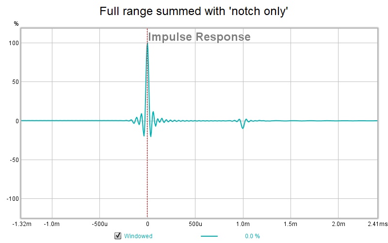

Currently I've moved to QSC's q-sys and its Core110f. Awesome platform for experimenting...you can lay out virtually any processing design you want. Tremendous processing power...even let's you embed a dual channel FFT's reference and measurement points anywhere in the signal chain you like.
Below is an electrical impulse experiment I am toying with, for if and when a measured reflection worth trying to neutralize pops up.
The impulse is a full range signal, mixed with a 1ms time delayed small 'notch-only' signal.
signal. I'm studying how FIR files combine, making a single FIR for the impulse shown, vs making FIRs for the individual signals and combining them in REW.
I don't think i could try stuff like this without the q-sys design flexibility, and awesome capabilities of REW and other measurement programs.

The previous 'notched' signal measurement was without any FIR.
It was just from normal dsp, albeit trying to do something a bit tricky.

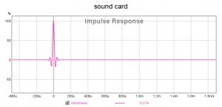

Have you looked at impulses from pure soundcard loopbacks?
Here's a straight loopback from a rme baby face pro...I don't see its impulse as all that different from the 'notched signal' impulse, in terms of pre-ringing.
Would you say the rme impulse below has pre-ringing?
Hope not, cause if so, I gotta just shake my head..

Well, actually, it does.

You can see it like you want but if the amplitude is twice as high and twice as long as the correction signal, it clearly has more influence on the sound than the correction does. Or in other words: If you can ignore the pre-ring, then you can even more ignore the reflection.

So you both deny it's worth discussing if it is an issue or not? As I said, if the amplitude is twice as high and twice as long as the correction signal, it clearly has more influence on the sound than the correction does. So why is a signal error much higher not important anymore? If that's acceptable, then the reflections are a non-issue anyway, that makes then no sense what-so-ever.
