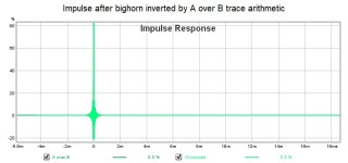

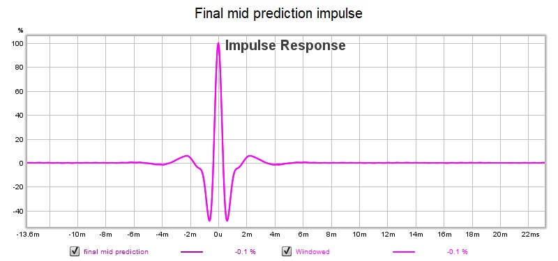

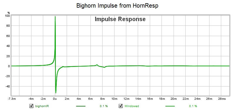

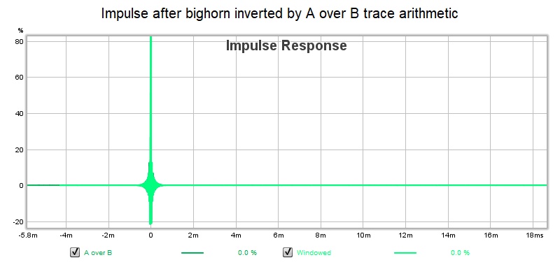

You are too kind. Anyway, I continued to think about this problem of separating out the reflections. I beat my head against, in fact, until finally some sense penetrated.

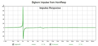

I modeled a conical horn that I hoped was big enough that the mouth reflection would be far enough out in time to be separable.
Then I tried to separate it with impulse gating. In playing with the gated impulse in REW calculator I inverted the impulse and got a flat line in frequency and phase.
Not a perfect dirac because of the ringing but all traces of the reflections are gone! Simply by inverting the measurement impulse we not only cancelled the mouth reflections but we also equalized the response.
So what do we do with this insight - that inverting the impulse eliminates the reflections? We already knew that since some room equalization products do exactly that and are aware that its not necessarily the best thing to do, depending on where/how the measurement was taken and where the reflections are from. Reflections by definition are not minimum phase and as a general rule we don't equalize non-minimum phase artifacts. But the same math that equalizes by impulse response inversion also cancels reflections. And if the only reflections in the measurement are those from the mouth and throat of a constant directivity horn, the chances are good that the corrections will be of benefit over a wide enough area to be useful.
What I would encourage you to do Mark is to make another crossover for your Synergy in which the "equalize flat for a couple octaves around crossover" steps before applying the target XO slope filter is replaced by a "invert device measurement impulse" step. Use that inverted measurement impulse as a filter in the XO in place of the prior flattening filter, cascaded with the other XO filters.
Since the impulse inversion filter equalizes the measurement flat from DC to daylight it will need to be cascaded with a filter to respect device limitations. E.g. a woofer will need a high pass filter that restores its natural roll off, a tweeter will need a low pass.
Hopefully you will get a sweeter sweet spot out of this and not do perceptible damage to the response in the rest of the room.

I suspect that restoring natural roll off at both ends of the spectrum will take care of the impulse ringingSince the impulse inversion filter equalizes the measurement flat from DC to daylight it will need to be cascaded with a filter to respect device limitations. E.g. a woofer will need a high pass filter that restores its natural roll off, a tweeter will need a low pass.

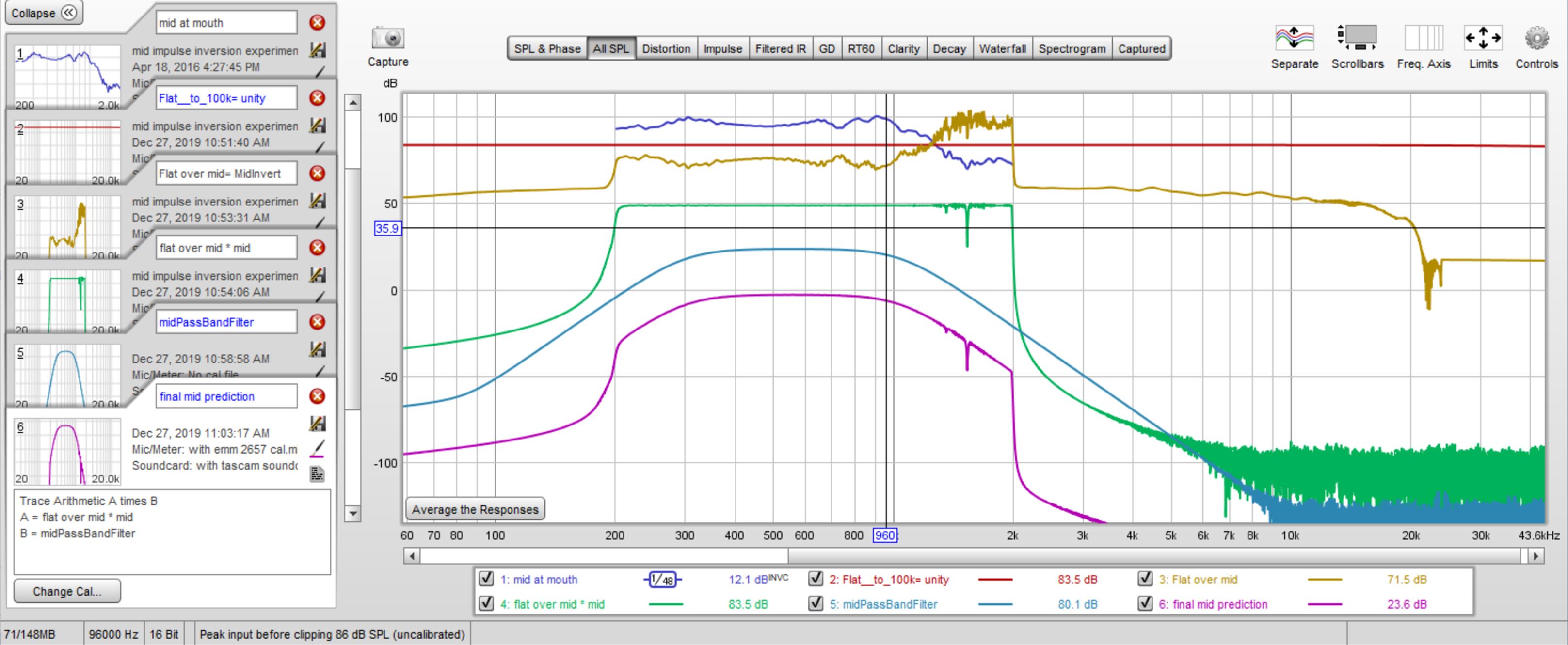

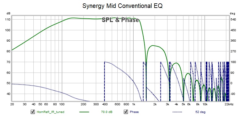

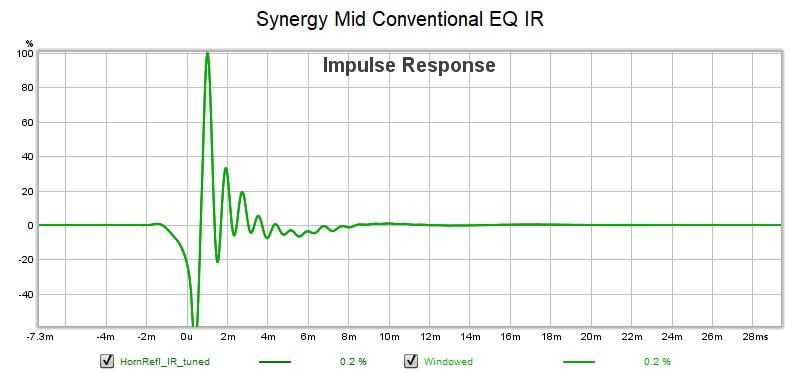

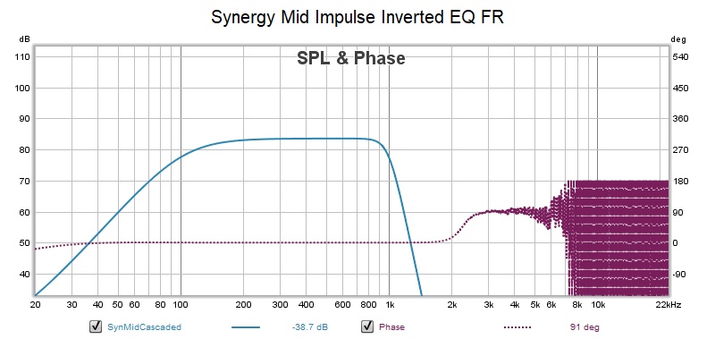

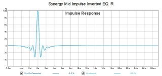

Applied technique to my synergy mid simulations

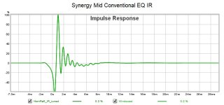

First the result with conventional EQ

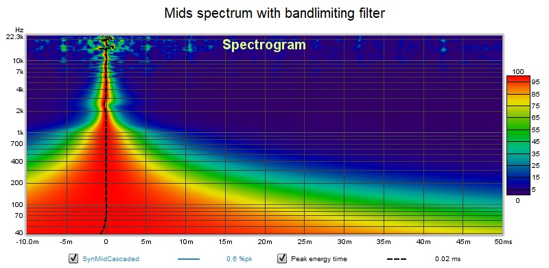

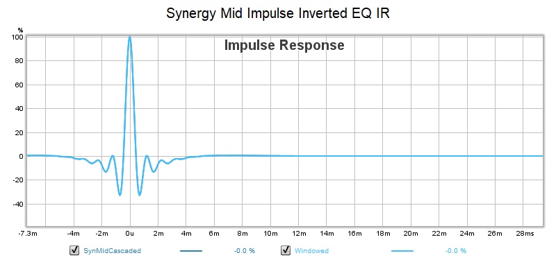

Now the results by impulse inversion EQ with second linear phase filter to set roll off at each end of band

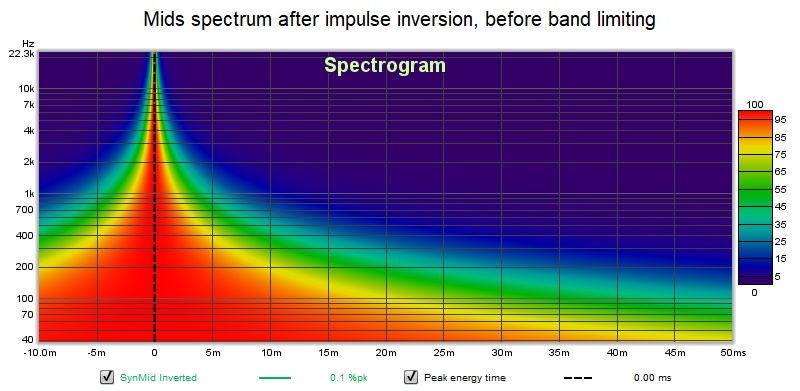

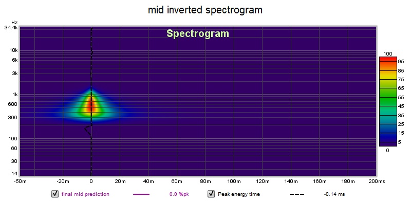

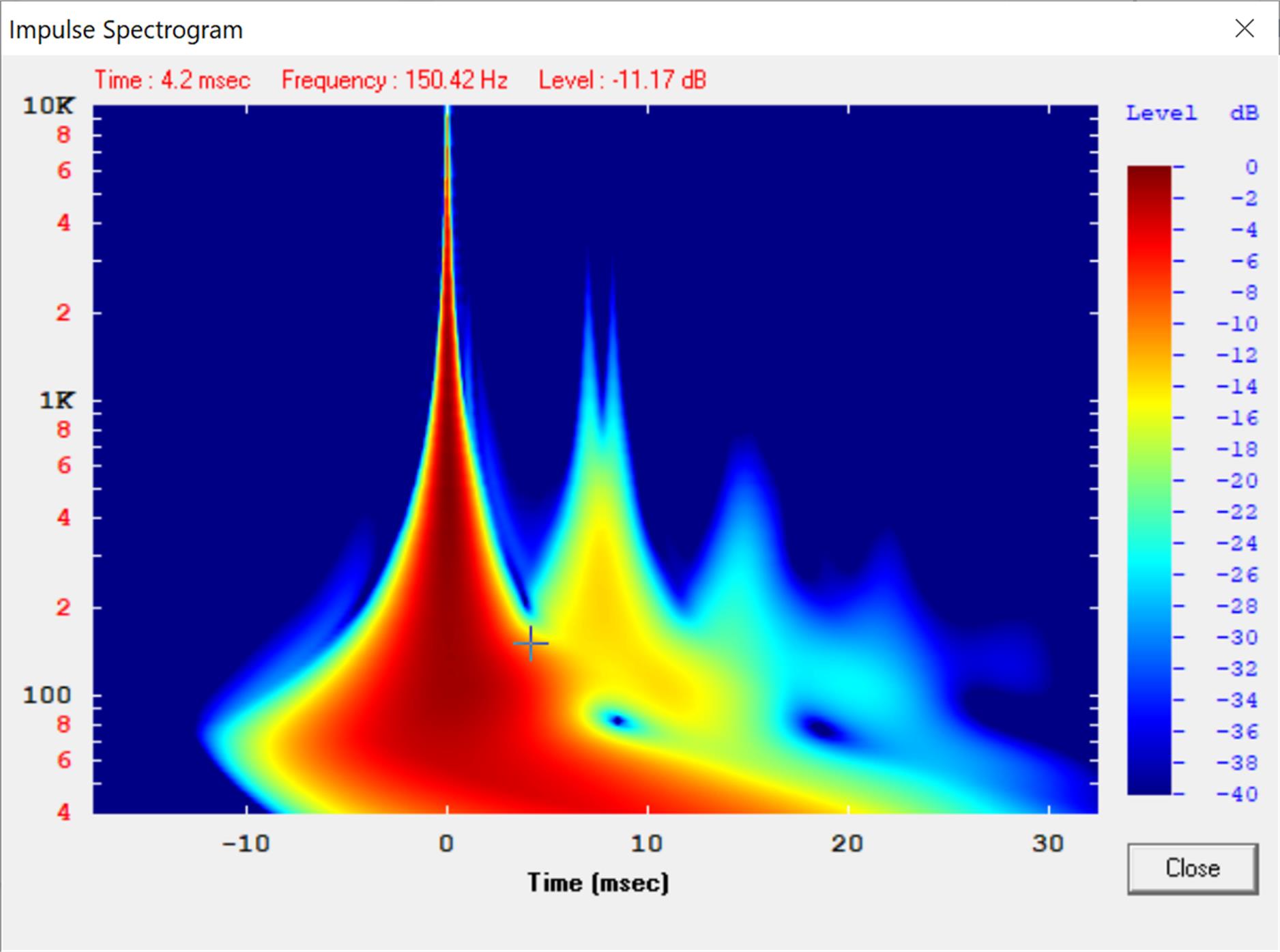

Looking at spectrograms shows I need to pay more attention to the filter that establishes the roll off at each end of the mids band 100 hz to 1 khz.
The spectrogram before bandlimiting is ideal
the spectrogram with bandlimiting departs from ideal outside the mid's passband
This confirms my suspicion that establishing smooth roll off at both ends of the band would reduce/eliminate the impulse ringing seen after impulse inversion

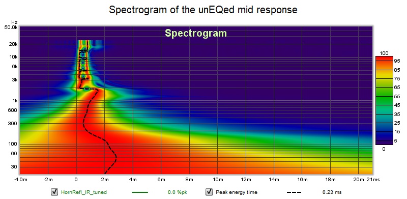

To complete the comparison, here is the spectrogram of the raw, unEQed mid response

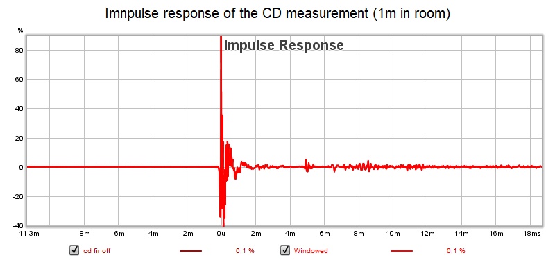

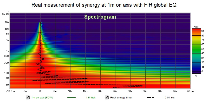

I actually built this design so I will dig down into my archives and see how it measured. This response has the IIR EQ and XO with a laver of FIR global EQ
I was able to flatten the phase. The room is intruding even with the mic at 1m from the corner horn. The mid reflection from the throat isn't apparent because its a system response with XO below the reflection null. Mouth reflections were 26 db or so down in the sim and aren't visible in the REW spectrograms.
I don't think I need to point out that these comparisons aren't quite apples to apples. They don't establish a dramatic improvement except perhaps in the shape of the IR, whereas FRs were substantially the same.
I think listening tests are needed to know if this is worth the effort. Don't forget the mouth reflections we wanted to eliminate were down 26 db to begin with.

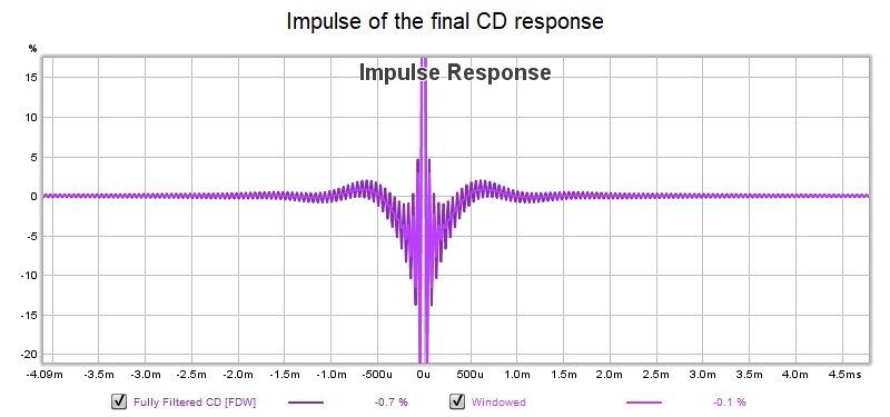

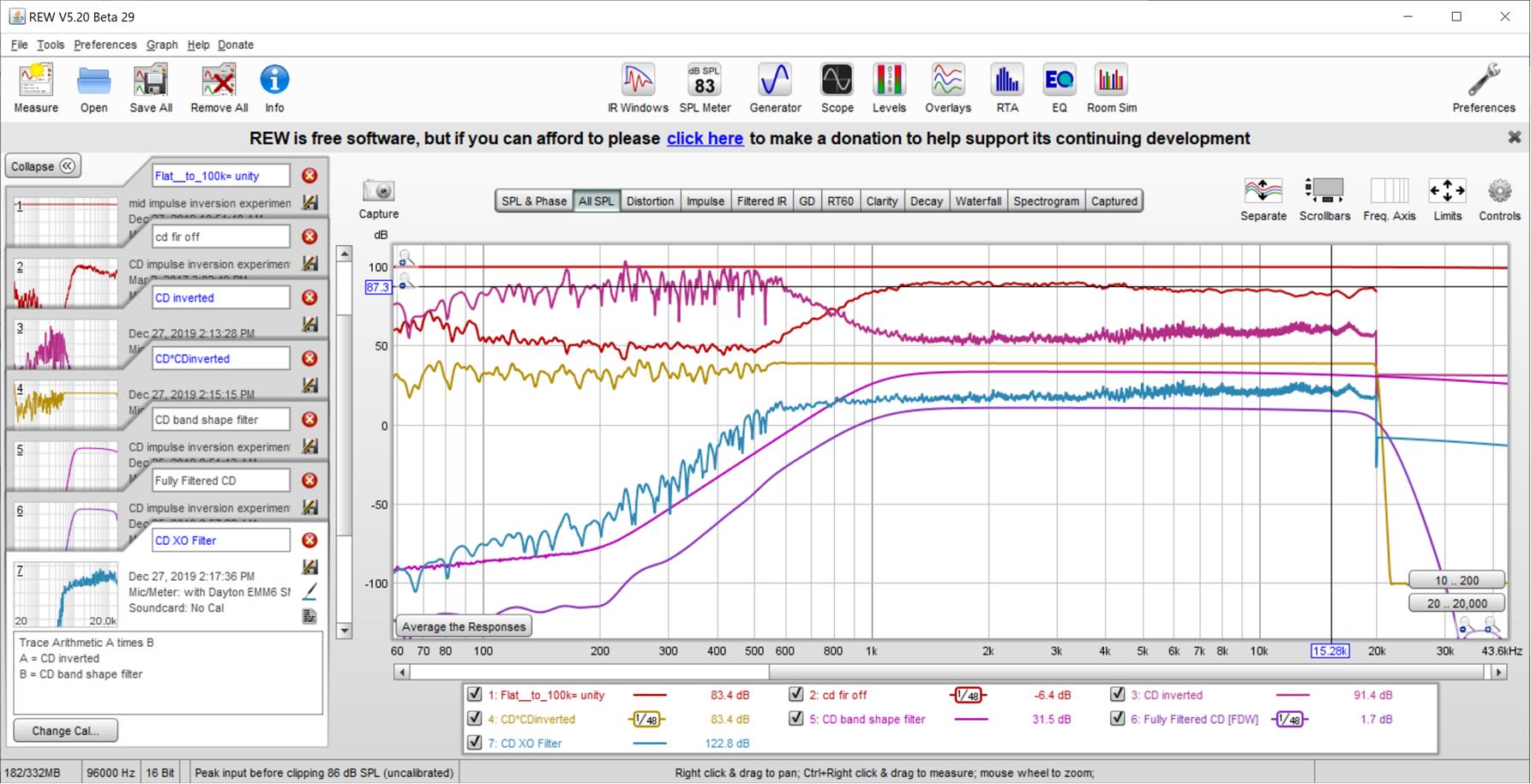

well simulation produces pretty graphs. Here is one built on readl measurement data - my synergy mids with the mic right at the center of the mouth of the horn.
My old measurement was taken only 200 to 2000 hz so we see artifacts of that in the graph. By the way, the final prediction has a near perfect impulse despite being able to see remnants of the throat reflection null in the frequency response.
I don't imagine it would look quite so pretty if I actually implemented a new XO and took measurements but I'm not set up for that at the moment

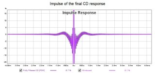

That worked as well as it did because the measurement was clean. What is the result when there is too much room in the measurement?
The teal trace is the final XO filter - cascade of pass band filter and CD inversion filter. Its correction is much too fine grained to be of any use. The measurement had a lot of room noise below passband in it, which might be the cause of the problem.
Need cleaner measurements!!!
