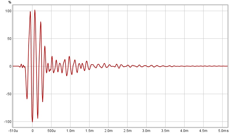

Attached is one of the impulses.
I know I have a single sample pulse...that's about it really haha..
Ok, I figure the first 4 tall positive peaks (and their negative oscillations) might all be due to the impulse. Measured distance between the VHF and HF sections in the 4594HE is about 0.08ms, which kinda matches high peak to low peak timing through those oscillations.
I'm thinking reverb between the sections...Pure spitballing …
Anyway, that set of large oscillations is over at about 0.33ms....and I'm thinking the following junk are reflections that end a little past 1.5ms.
Am i even on the right track....?
Windowing suggestions? I'd like to get the big oscillations out as a start, but have no idea yet what REW is telling with windowing with a few quick pokes at it..

Yep, a "thought typo". I was thinking of the distance to the mouth and back, but then wrote about time. About 56 cm round trip, or 1.6 ms more or less.
FWIW, that impulse is a mess. Maybe that comes from recording with one part of the driver as a mic. If I were looking for reflections at the mouth, I'd put a mic at the horn mouth, maybe a little in front of it. Take a measurement with the horn alone than change the mouth somehow and take another measurement. Compare the two. Use a swept sine measurement.

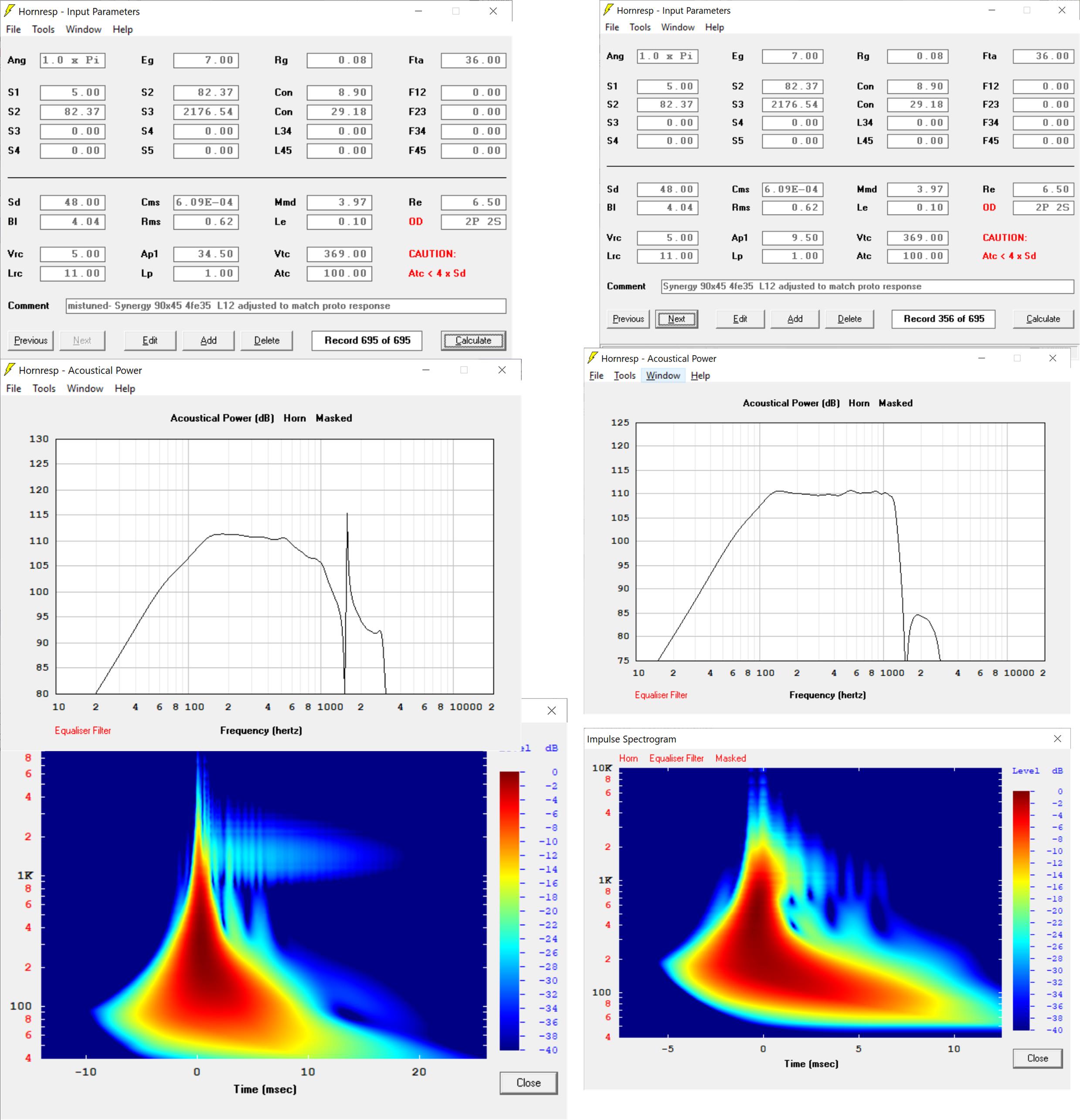

I revisited the HR sim of my synergy mids. Clearly saw ghost IRs in the impulse spectrogram. Exported the IR from HR and brought it into REW for a closer look. All I saw out at the delays corresponding to those ghost IRs were some small bumps. Not very encouraging unless to indicate that reflections aren't a big problem. Time to reread the Gunness paper and patent
but the bandpass chamber of those mids had been carefully tuned and equalized to optimize the response. Mistuning the chamber to maximize the null, I get clearer picture in impulse spectrogram and very different IR.
So reflections are visible in these impulse IRs from HR; but not clear how to extract the reflections from them. The simple process I had in mind earlier today fails in the face of even simulated data, never mind measurements.

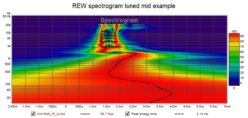

Having some fun with simulations; more comfortable (and controllable) than doing measurements and gives us an idea what we are up against.
I imported the simulations IR into REW to see if I could reproduce the same spectrogram there. This is as close as I could get and shows a distinct reflection in the HF and that the reflection is so close (synergy mids reflecting off throat) that both primary and reflection IRs are on top of each other

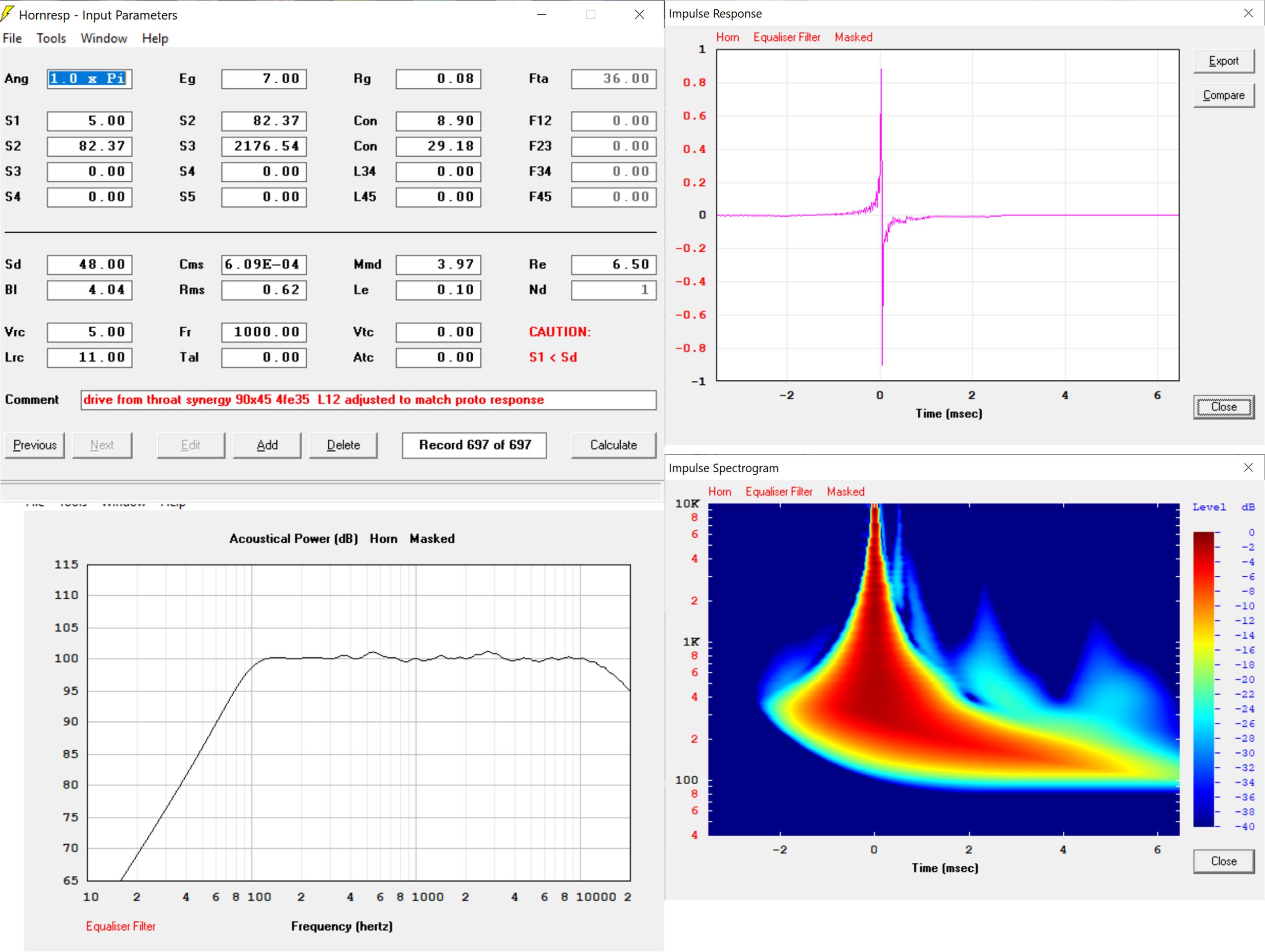

So that was the Synergy mid. The mouth reflection doesn't show up there so I modified the sim with a driver at the throat and no mid. This is the same mid driver but EQed flat because I'm only interested in the horn characteristics.
Distinct reflections again appear with the earliest one being about 26 db down. It turns out this is too faint to show up in a REW spectrogram so I'm not showing the REW.
Again, as we discussed earlier, the trick will be separating the reflection impulse from the primary impulse in order to do cancellation. You can see that the visible reflections are at higher frequencies than the primary where the two overlap in time, so some kind of time+frequency discrimination process might work....
