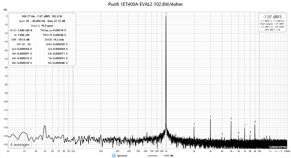

Or, perhaps, it's because all of those plots have relative levels in their measurements. Generally, that's what people prefer to see for distortion measurements. As in, how many dB below the signal is the seventh harmonic. Or whatever.Wondering if the issue might have to do with assumptions involved in converting average noise to RMS noise?
If you want an absolute number for something, you need to know what the absolute reference is. In the case of most of the plots I posted, you'd need to know to know what 0 dBFS represents. For all you know, it could be 871 Volts. (It's not - it's 4.5 Vrms)
You likely won't be able to track that data down from most published test plots. So, you're stuck. If you can, it's better to do what PMA suggests and measure it yourself. In some published reviews that include measurements, they tell you what the SNR is, in what bandwidth, and relative to what level. From there it's easy enough to determine the noise density. Even there you'd be assuming a flat noise floor, which it often is not.

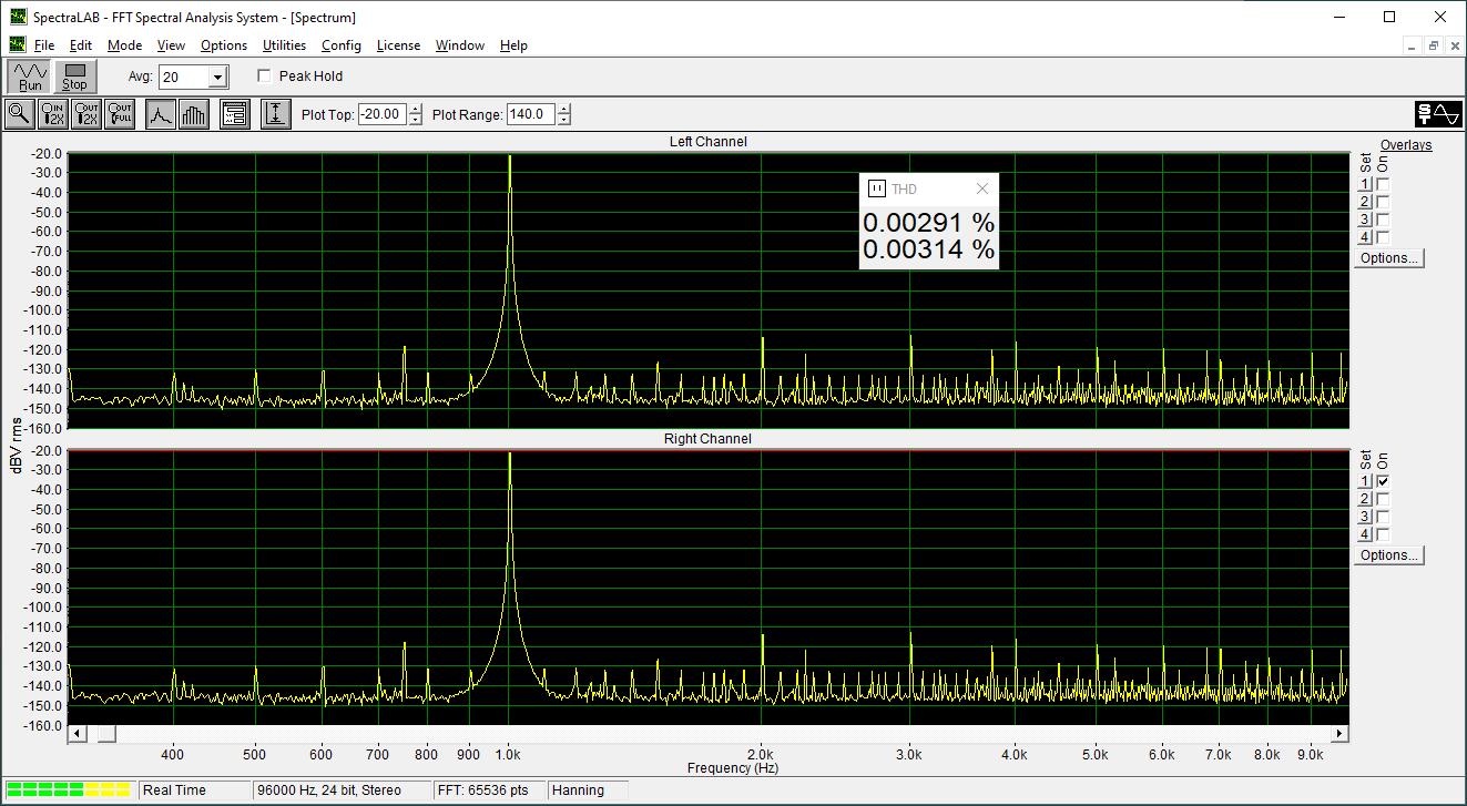

Results count, nothing else. Below an example of measurement “on the cheap” measuring system, USB DAC, USB ADC, one isolator, power amp.

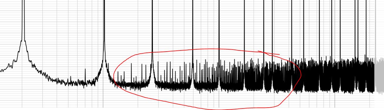

Back to my question, These are IM products, not noise, and they are not present on the Multitone plot even though everything up to the digital processing is the same?
You can tell they are IM products by the symmetry and discrete nature. This is what I usually see with these tests. Its quite good with the IM products all below -120 dBFS but the Multitone is too good to be real with zero IM. Especially weird since Multitone is an IM test.
