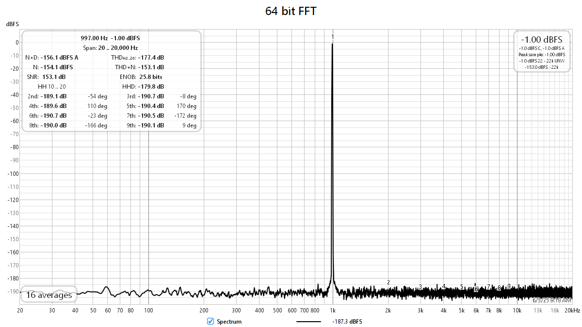

I tried various settings and the results are basically similar with the same main difference (spuriae in REW). I also tried to add dither in REW (one may choose any bit level of dither), because the REW records may indicate to dither issue. I tried to analyze wav test signals as well.Are you using the same window function, FFT length, etc. on the two setups?

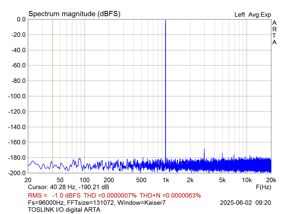

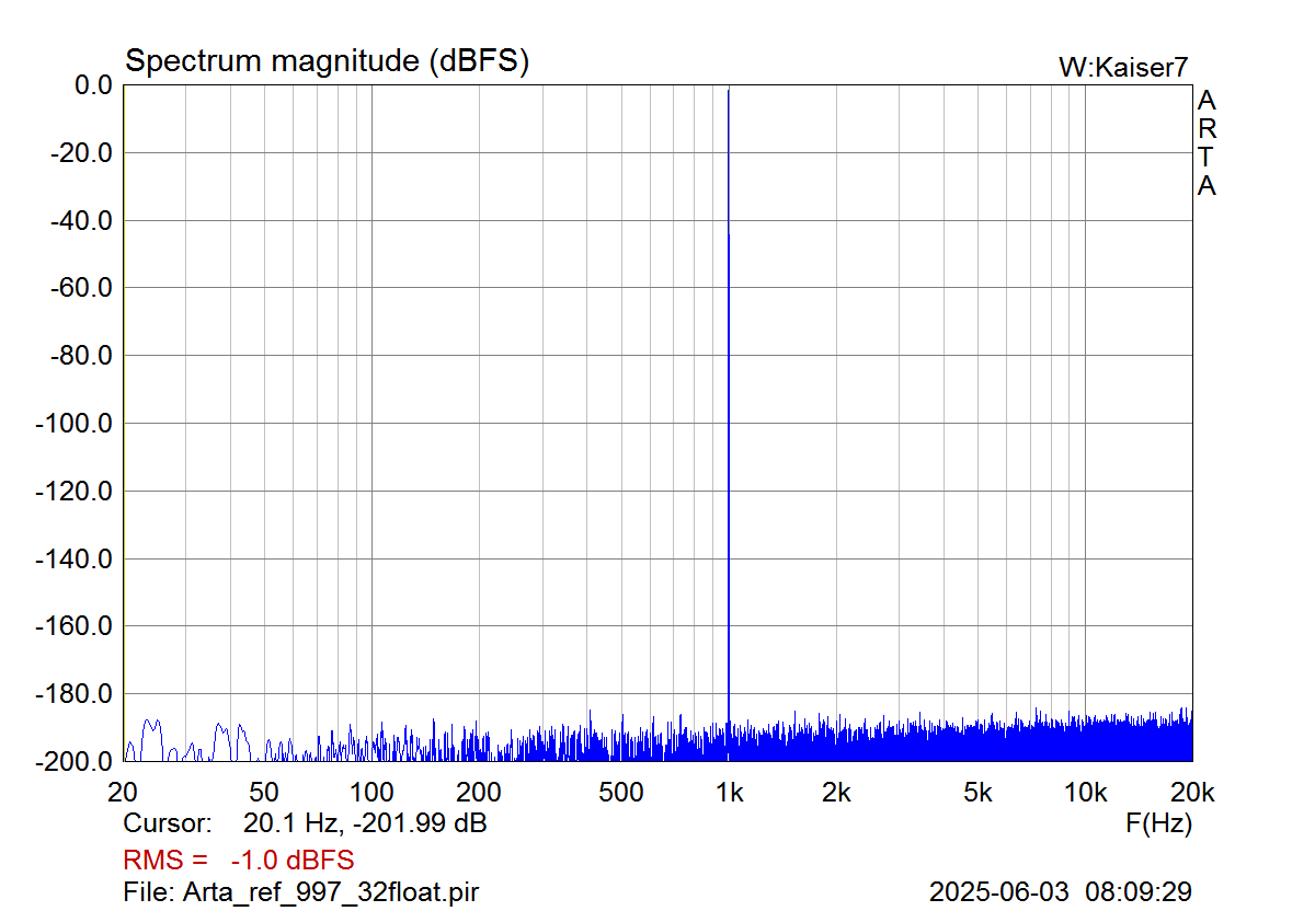

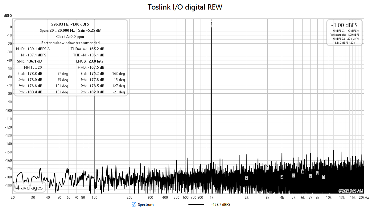

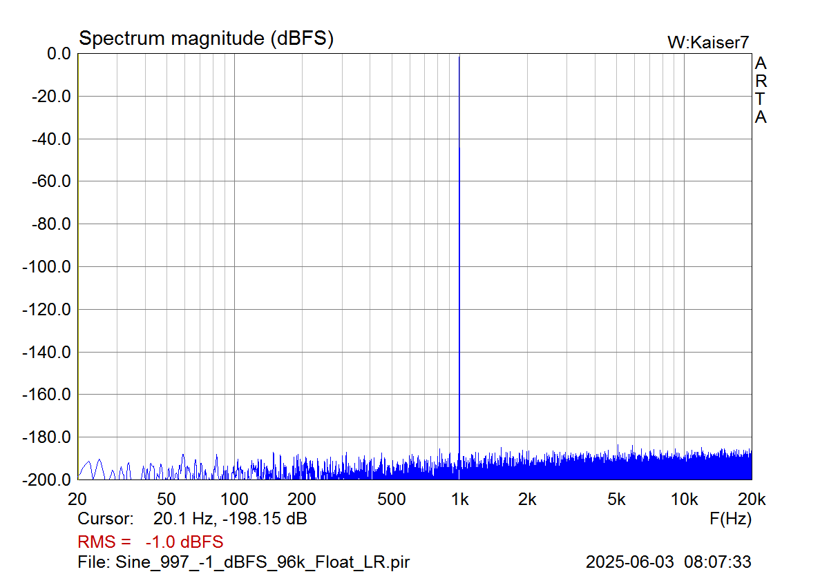

It seems the difference is only in the way how Arta and REW display the spectrum. I generated 32bit float 997Hz test signals in Arta and REW and they are identical. But in REW analysis RTA window they look like 24 bit undithered. However, they are both "clean" with Arta analysis window.
REW test signal
Arta test signal
As I have mentioned earlier, this is absolutely unimportant for audio, as everything discussed here recently. Just a matter of curiosity.
REW test signal
Arta test signal

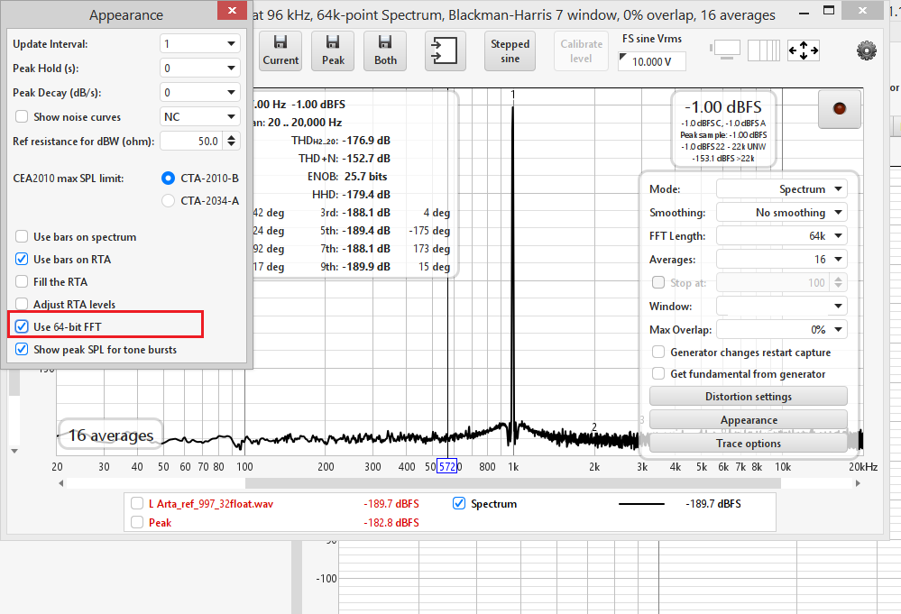

AFAIK REW RTA uses 32 bit floats for internal calculations. That is equivalent to 24 bit integers which would explain the higher noise floor.
That might be the reason. In REW RTA analysis, 24bit PCM, 32bit PCM and 32bit float generated test signals all look the same. But they are not and it is properly shown in both Deltawave and Arta. That might also be the reason of those multitone differences posted earlier.
@bohrok2610 : Thanks for the hint! Mystery revealed, I need to check 64-bit checkbox in REW RTA setting and everything is as it should be.
Toslink digital link is now also OK:

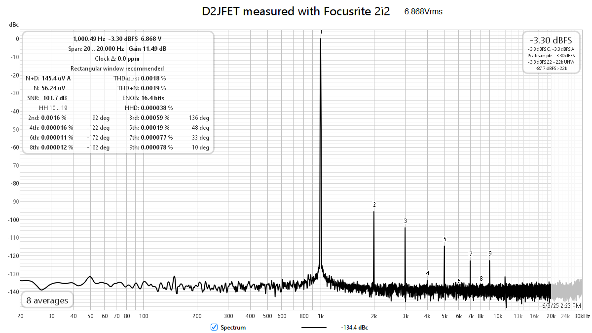

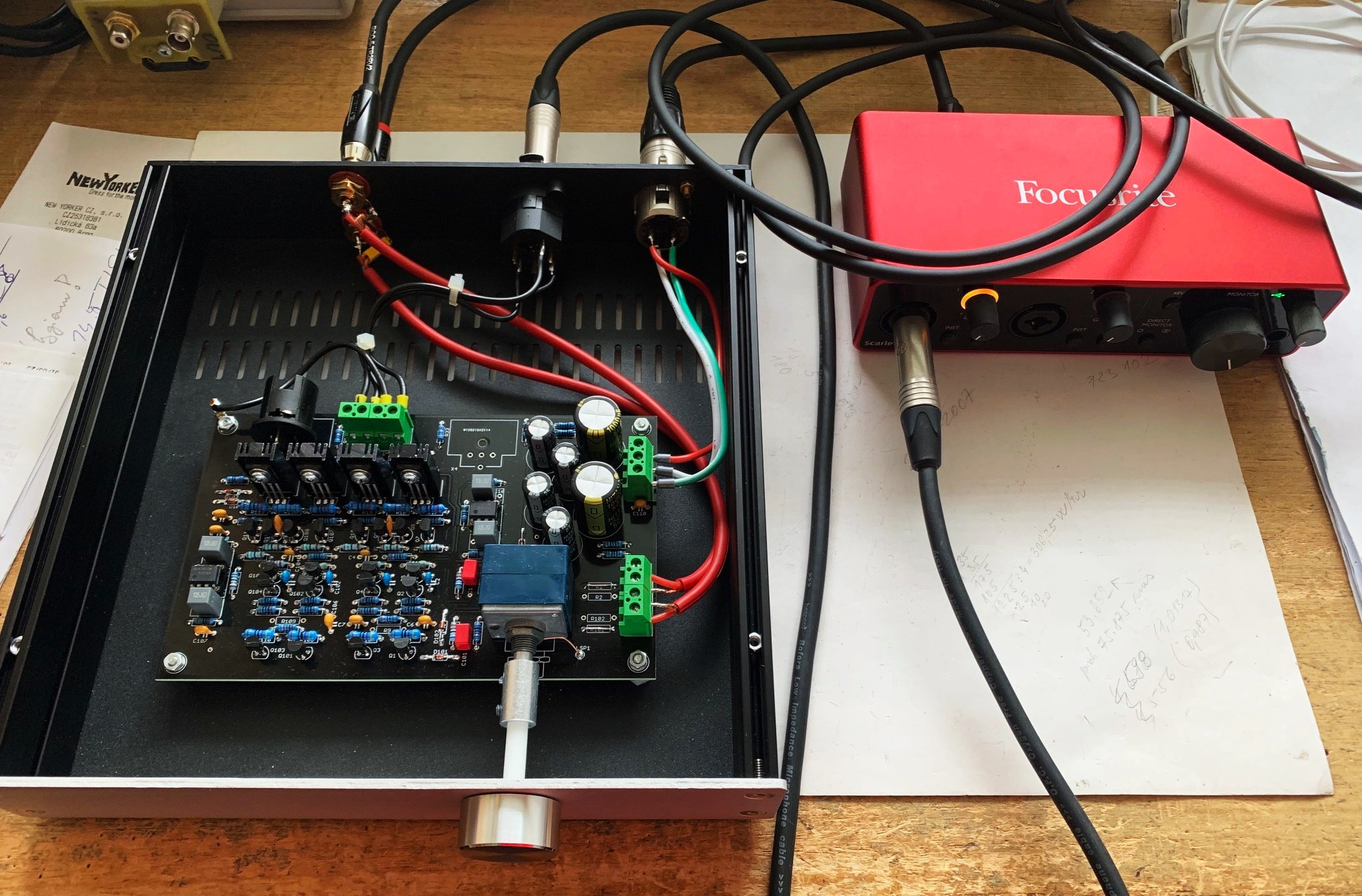

Talking about really cheap, Focusrite 2i2 was also mentioned in this thread. If the requirements on lowest distortion and noise measurements are missing, 2i2 may be used for approximate measurements. There is an advantage of all-in-one, synchronized clock and balanced inputs and outputs. I strictly recommend to use this interface with balanced I/O's only. Still, there is a penalty of higher intrinsic noise of this interface. Below an example of approximate measurement. My recommendation: always think thoroughly about signal grounds and returns to get clean measurements. It is a pain to have a look at various noise floor modulations and mains spuriae in the measurements.
