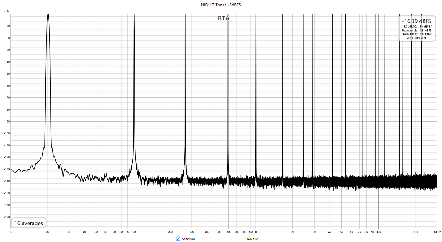

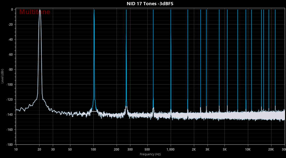

In order to eliminate all but one variable in the comparison process - the software spectrum analyzers - I used my own suggestion. I generated in Multitone an NID 17 tone sequence (as found natively in REW) and exported it to a wav file. I then played it back through my usual test DAC using Audacity. I used the Fluke 87 to confirm that output of the DAC was .710 Vrms. REW and Multitone were only used as spectrum analyzers. Same settings for FFT and so on.
Here is what the spectrum looked like in REW:
Now, here it is in Multitone:

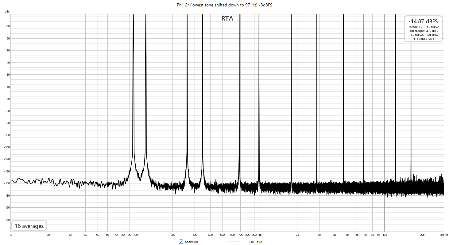

As a sanity check and for completeness, I did the same for Jon Risch's Phi12r test. I did move the lowest tone down from 100 Hz to 97 Hz so that it wouldn't be at a subharmonic of the sample rate. Multitone measured the crest factor of the composite signal to be 4.9. The Fluke 87 said that the output level was .848 Vrms. That gave almost the identical peak output level as found in the NID test.
Here is the REW spectral plot:
Now, this is from Multitone:
I hope that this clears up any and all confusion and most questions.

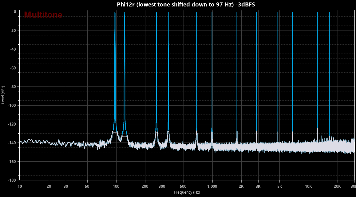

For what it's worth (probably not much), the first sample shows indeed 12.3 dB difference between the (individual peak) signal and the 'peak sample' sum indicated in the top right REW box, but the second sample is already a little bit into clipping or saturation in REW, showing only a 10.8 dB difference.
Well, I don't know what to tell you.
The indicated peak sample levels were only 0.01 dB apart in level. I would think that if one is clipping, the other waveform would be clipping as well.
The two test sequences, NID 17 tone and Psi12r, have different crest factors as you might expect given the different structures. So, wouldn't you expect different RMS levels for the respective waveforms if the peak values are the same?

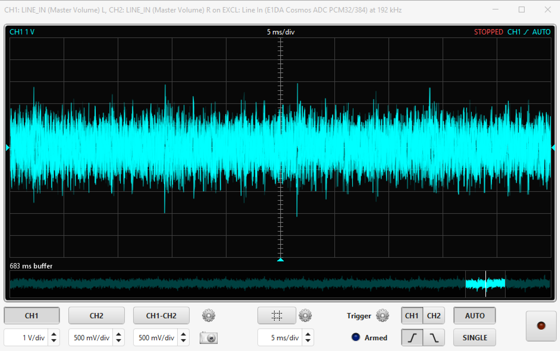

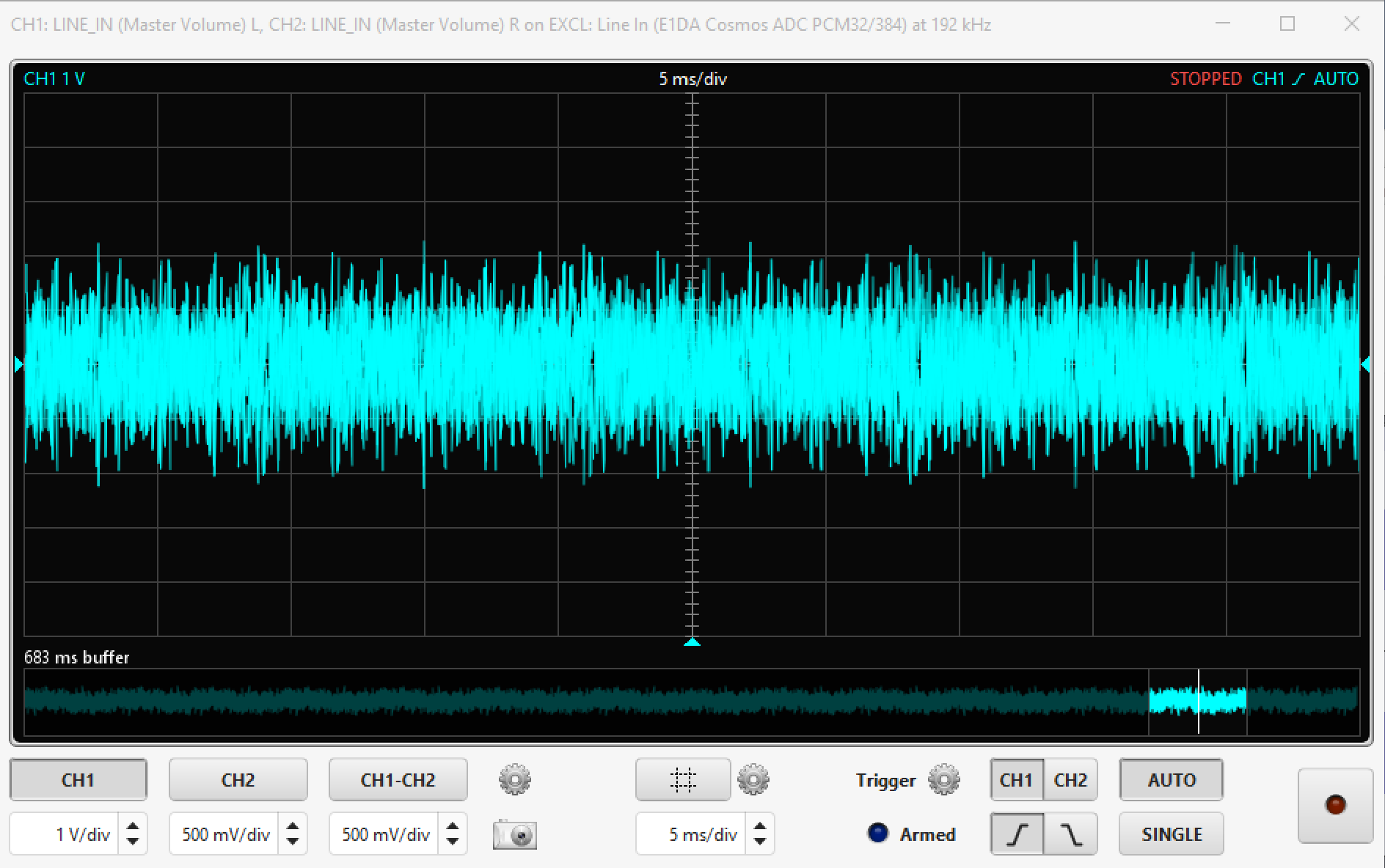

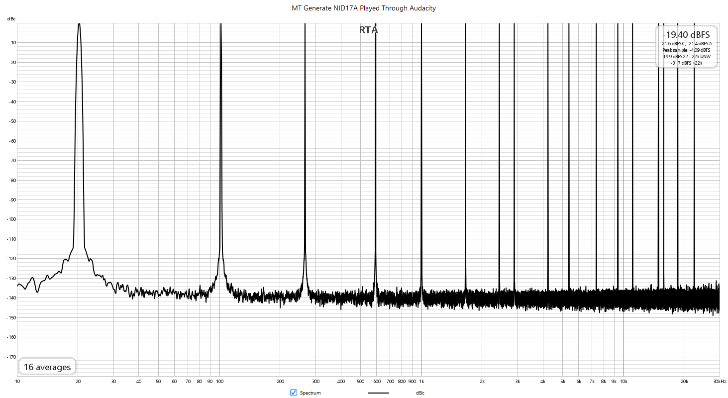

Then I played both back through REW's RTA and Scope facilities using Audacity as the source. Since I'd already determined that the two application's spectrum analyzer functions performed the same, I didn't feel any need to replicate the tests using Multitone's analyzers. The hardware was the same as always: Topping E50 balanced output to an E1DA Cosmos Scaler to the E1DA Cosmos ADCiso.
First, the scope patterns. Multitone generated NID17 first, then REW Generated NID17:
There's immediately visible differences.

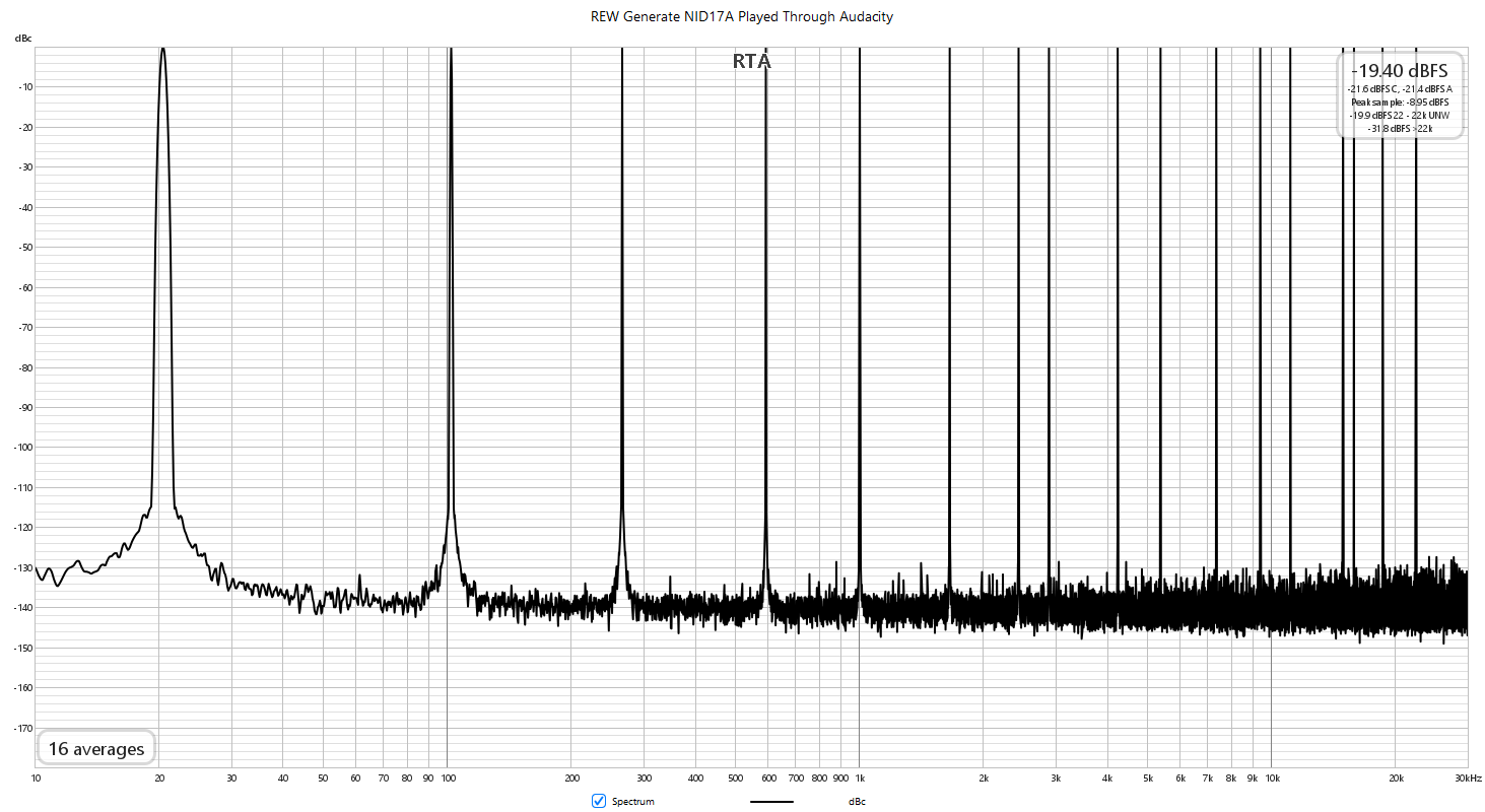

Now, this is the REW RTA spectrum analysis of the two. Again, Multitone generated NID17 first followed by REW generated NID17:
There's some difference in low level IM distortions visible in the two. But, although the RMS signal level is identical for both, the peak sample levels are very different. Why the distortion levels appear higher with a test signal with lower peaks beats the heck out of me.
I won't draw any conclusions other than to suggest that it's best to be consistent with what test signals you use across varying devices under test! OK, that and I think I've been able to reliably minimize any AC mains derived hum from being introduced into my test hardware.

Phase. Crest factor of a time-domain waveform depends on the relative phases of the sine wave components, so maybe a little clipping on that account. OTOH, the spectral analysis view of an FFT is void of phase information; it only shows the magnitudes of frequencies.Why the distortion levels appear higher with a test signal with lower peaks beats the heck out of me.
Interesting that the higher crest factor generated less IM. Is there a way to bypass the DA-AD and feed the digital file into REW? My first suspicion is a dither issue or something similar in the creation side. I'll try to duplicate these but not for a few weeks when I'll be free to do this stuff.

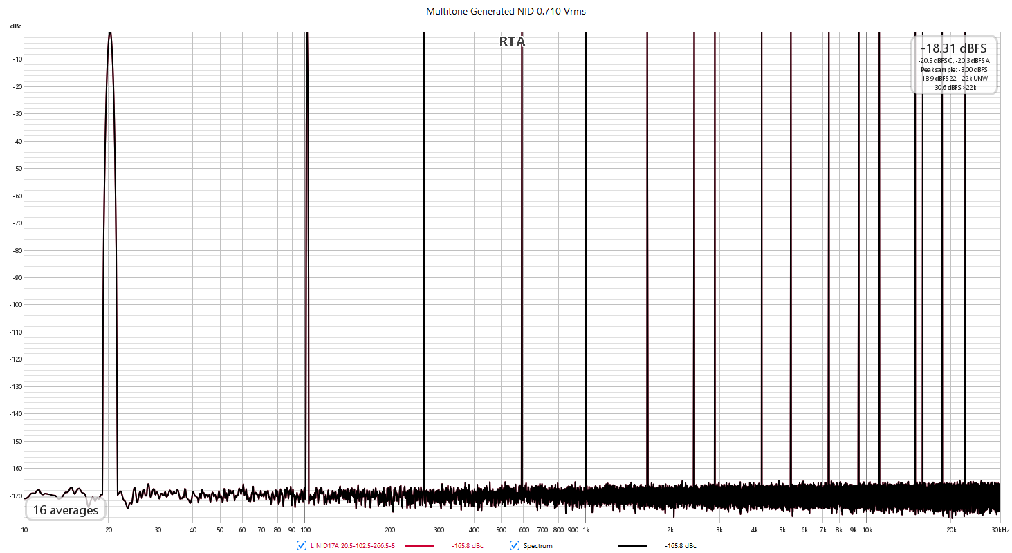

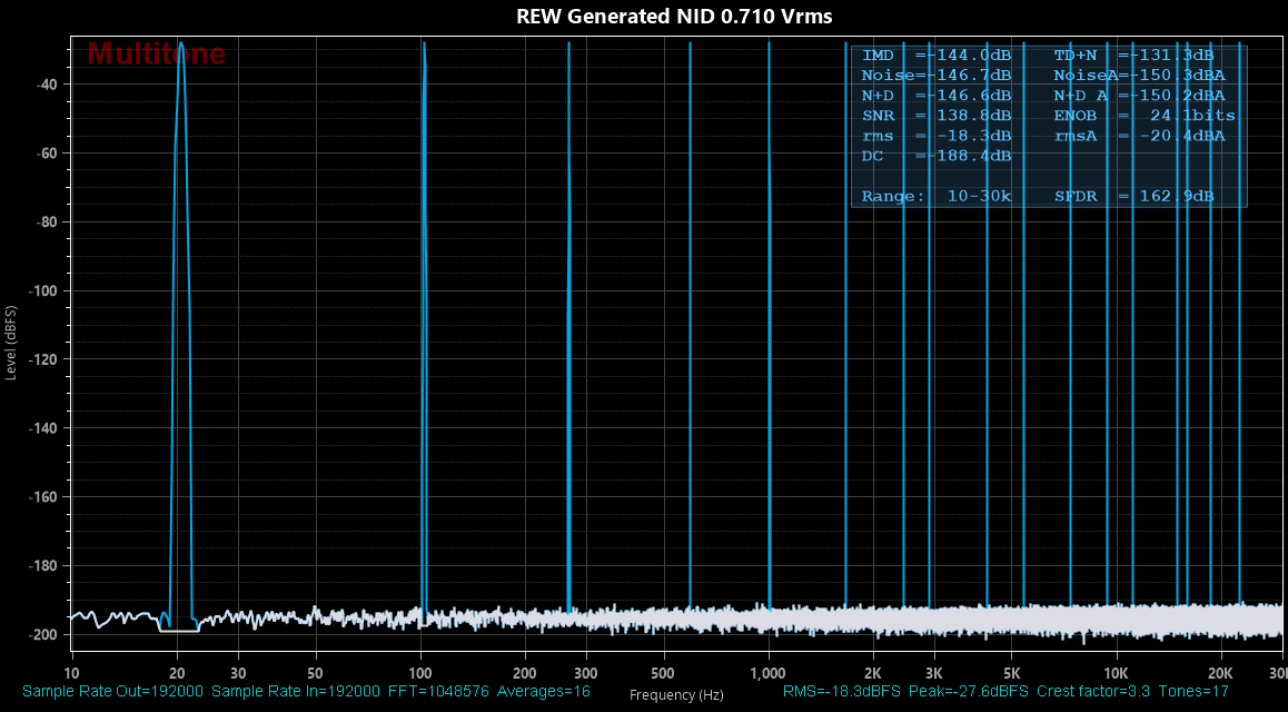

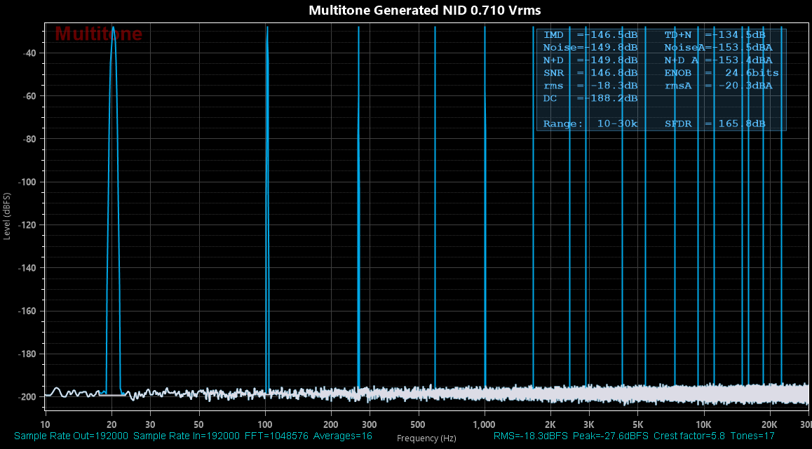

As suggested by PMA, here are the two generated test files measured at the wav level in REW - no hardware.
Now, as analyzed by Multitone:
It's too bad we actually need hardware to listen...
In a practical sense, I'm not sure what this all means. I guess just that Multitone and REW generate multitone test sequences differently, so you can't directly compare one to the other.
You might also analyze those wav files using a LUFS meter, which should use a reconstructed waveform to find peak intersample levels. As is, REW is showing rather different peak sample levels.
