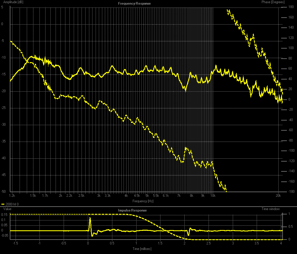

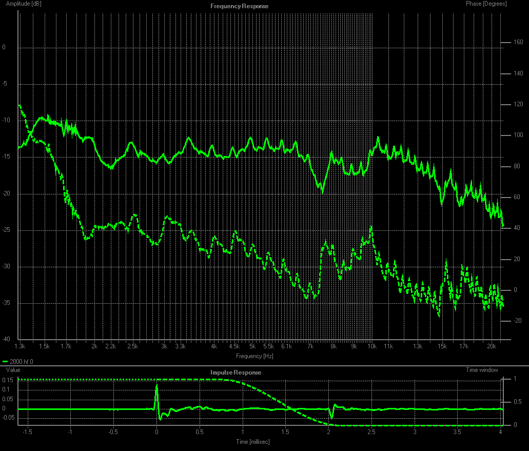

Hi Sum,
My measurements are Zero Locked in Holm impulse. Ie after measuring the woofer, the auto mechanism is turned off and the same zero point used for the tweeter. With this in mind you can see that the drivers are time aligned 🙂
I believe that Holm should be able to show the time of flight as well (it simply detects the start of the impulse and makes that time zero, unless you tell it otherwise. Whether I can get that information from existing measurements or have to do others I'm not sure (If I have to do new measurements it could be a while, as in possibly weeks). If I've got time I'll see what I can come up with.
I'm still not seeing the phase flip in the measurements I posted, I personally think that the dip around 5.5K is a diffraction rather than a driver artifact (and I think that the impedance measurement backs this up), but I'll try getting you a different representation of the data if that helps you to get your point across 🙂

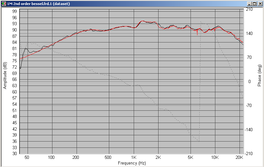

Hi Sum,
I certainly don't beleive that impulse testing is useless, but I don't necessarily believe it is accurate and precise either, just a read of Joe D'appolito's "Testing loudspeakers" chapter on computer based measurements should show that digital sampling is anything but precise!!! It involves a heap of interpolation, there just aren't enough samples to get a truly accurate measurement of the waveform (accurate meaning no interpolation).
So where does that leave me? Well I used impulse testing for measuring my drivers (both the SPL and the impedance). I used these measurements to simulate my crossover. I went and bought the components and built the crossover. I then measured the SPL using the impulse again. The result?
Nearly exactly the same as the simulation. Now I would call this far from useless! In fact I would also venture that if the frequency response data and the impedance data were inaccurate due to having used an impulse response for measurements then it would not have been possible for the simulation to predict the response that would result.
Attached is the actual measured response of the implemented crossover (black) and the simulated response (red) which was simulated from the individual drivers measurements using speakerworkshops crossover simulation capabilities. SPL measurements were made using holm impulse, and impedance measurements were made using speakerworkshop.
Would the speaker measure differently using a different test methodology? Probably. Would that different test methodology mean that I could build a far superior speaker? Probably not IMO.
