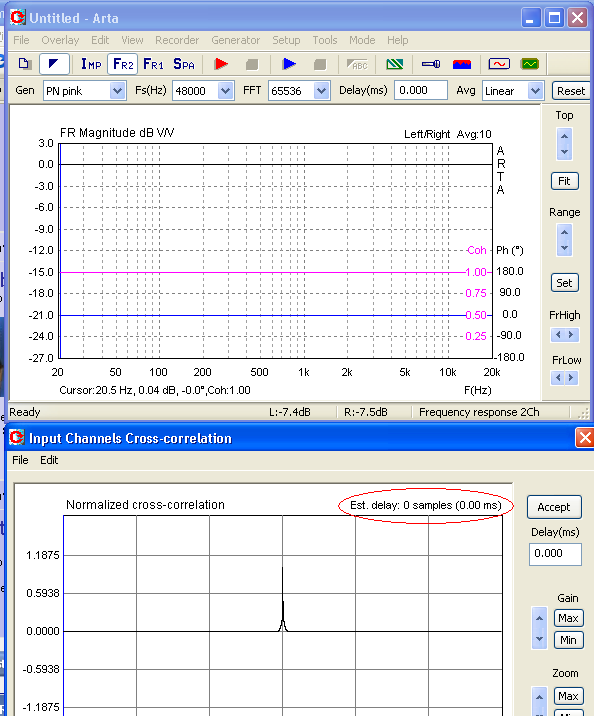

Skimming through the IASYS manual, it appears to work similar to ARTA in FR2 (2-channel frequency response) mode. This is just a loopback of my sound card but it shows a periodic noise signal (similar to pink noise but not random) and a plot of FR, phase and coherence without going through the impulse intermediate step. Delay is determined with cross-correlation. The math for all that is in the ARTA manual.
