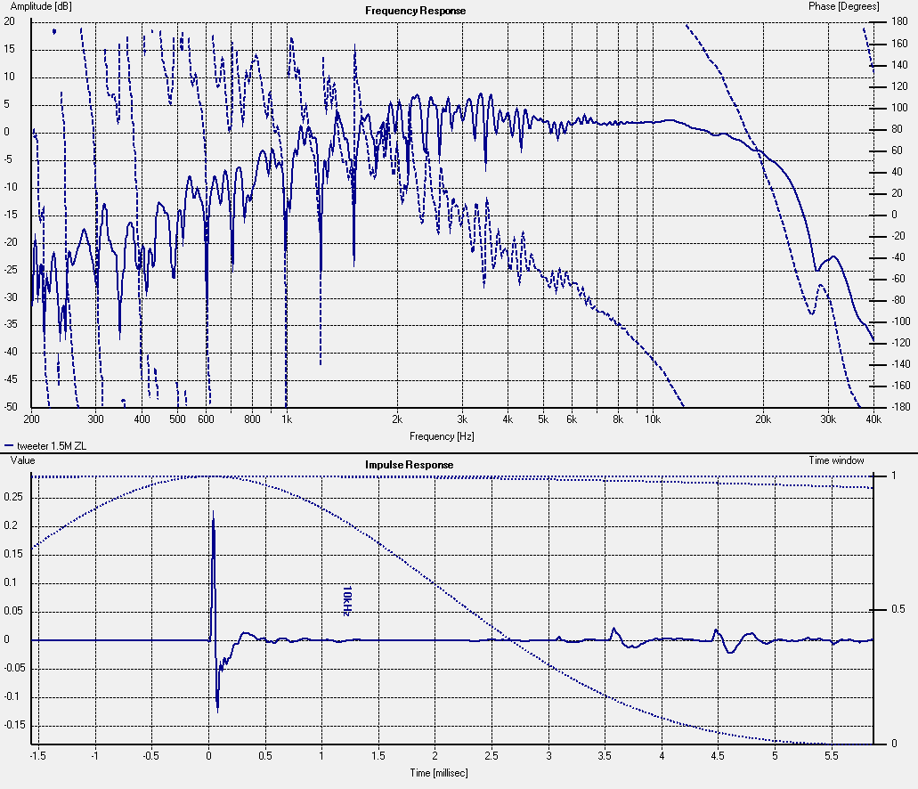

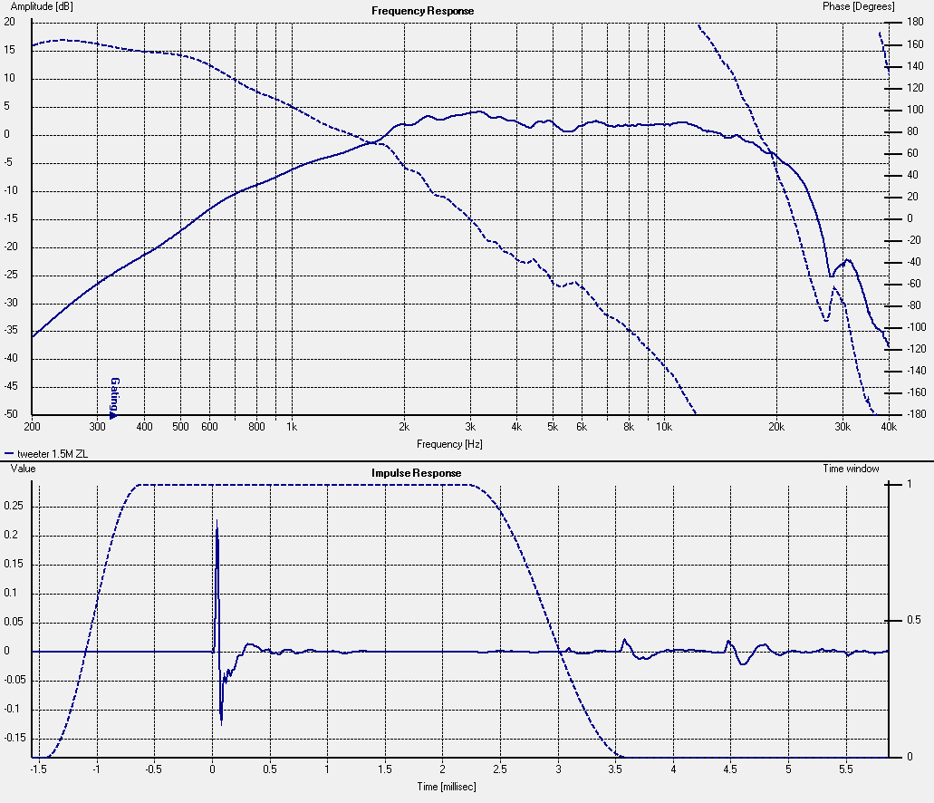

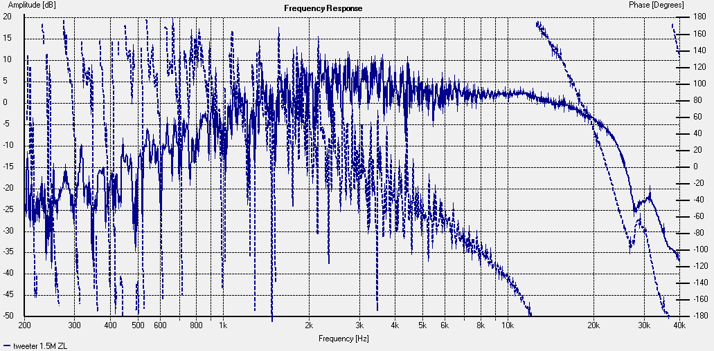

Hi Sum, here are the warts and all measurements and some in between 😉
The one I posted at lunch time was an export out of holm, imported into speakerworkshop so was limmited what I could show with it.
Below are the following: (all the same measurement)
raw response (basically unusable but put in for reference).
gated at 3ms (which is probably what was in the speakerworkshop graph
1/32nd octave complex smoothing.

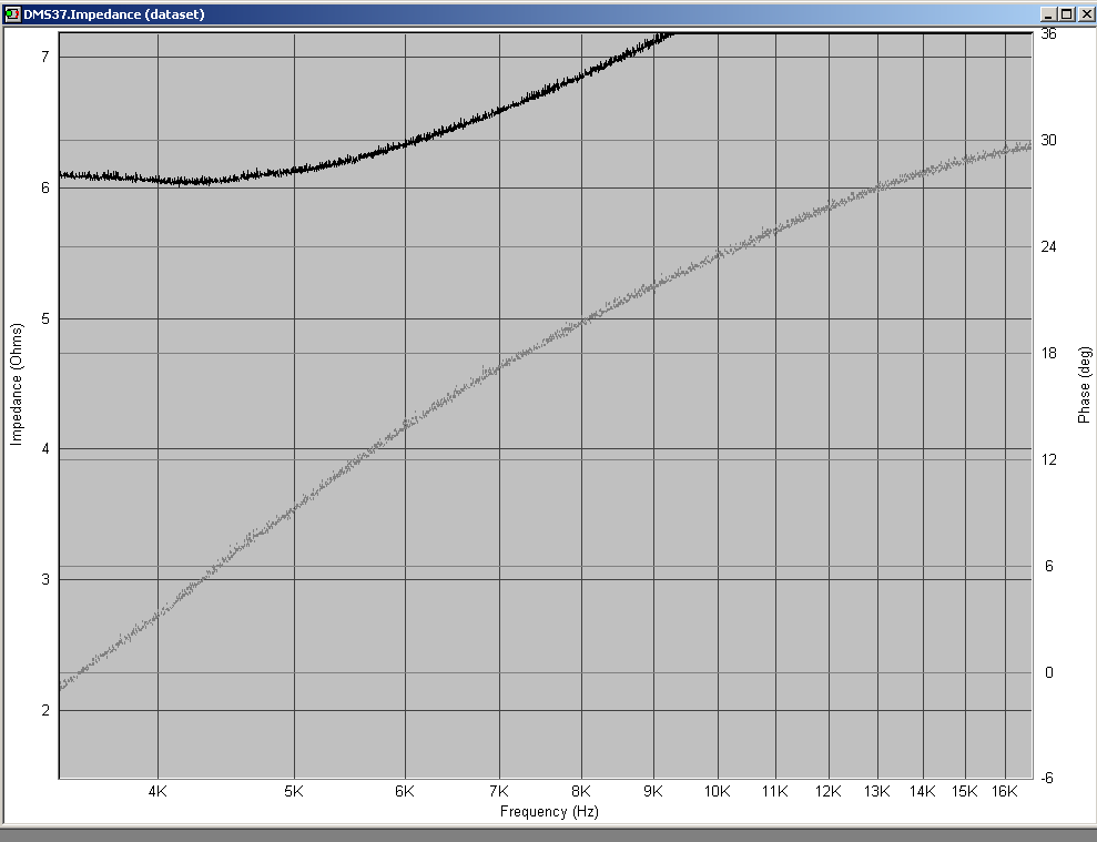

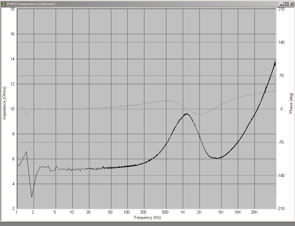

I've also attached the raw unsmoothed impedance curve and the same zoomed in on the 5k - 7k range.
I believe that the phase must be pretty close (well relatively between the drivers anyway) as when I modeled the crossover using the measured responses of the individual drivers, the modeled response was VERY close to the measured response of the implemented crossover. Perhaps the Display of the phase is not correct? My first measurements DID have problems with the phase, and the modeled crossover was not in agreement with the actual results at all. Interestingly the maufactureres specification for this tweeter is that the resonant freq is 700 Hz certainly not what the impedance plot shows!!
The impedance plot I am very confident is correct 🙂
Tony.

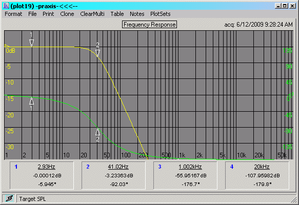

Simply not true. The port is without question a lowpass device. The attached graph (if I uploaded it properly) shows the response of a port with a BW2 lowpass at 40Hz for a flat wideband input. It's evident that at 20KHz the response is nearly 180 out-of-phase. Even at 1K it's almost the same. Clearly at Fp the phase has shifted 90 degrees, exactly what one would expect from a BW2. There is one and only one place where the port moves in the same direction as the driver, that is at the asymptote at DC. Above that, there is an increasing delay. That's the classic group delay. This is indisputable.
What does complicate things is that the input to the port as we measure it from the driver front is 180 degrees out-of-phase. All output from the port that we measure and perceive (excluding box vibrations) are from the start originating from a signal that is at its start 180 degrees out-of-phase. The port then adds its lowpass response, a slope with a group delay, to its input. That delay is decreasing as frequency drops to the asymptote at DC where the driver and port are precisely 180 degrees out-of-phase from our external perspective. For practical purposes they are never fully in phase as the port output is so attenuated by that time that its moot, in the noise floor.
Quadrature has nothing to do with it, since most real ports have other issues associated with box internal dimensions and port self-resonances.
As far as the box delay, that is primarily a function only of the time delta from driver to the port controlled by the speed of sound in air in the box. The resonance of the system is primarily a function of the air-spring of the port air mass and the box air spring with some coupling of the air in the port and the air in the box, so that complicates it in details, but as a lumped sum response for purpose of discussion, this can be ignored.
The port is not in quadrature with the driver. The drive signal for the port starts out as the back wave of the active driver at -180 degrees. This signal is coupled through the spring of the box to the mass of the port. This causes 180 degrees of delay, which is frequency dependent, so both always move together between Fs and Fport.
This is correct up to the last point that is wrong. Study the phase response of the BW2 acoustic lowpass and you'll see why. Even in an "ideal" ported system, at tuning the drivers do not move in unison. The output from the port can only be 90 degrees out-of-phase with whatever the input signal is.
